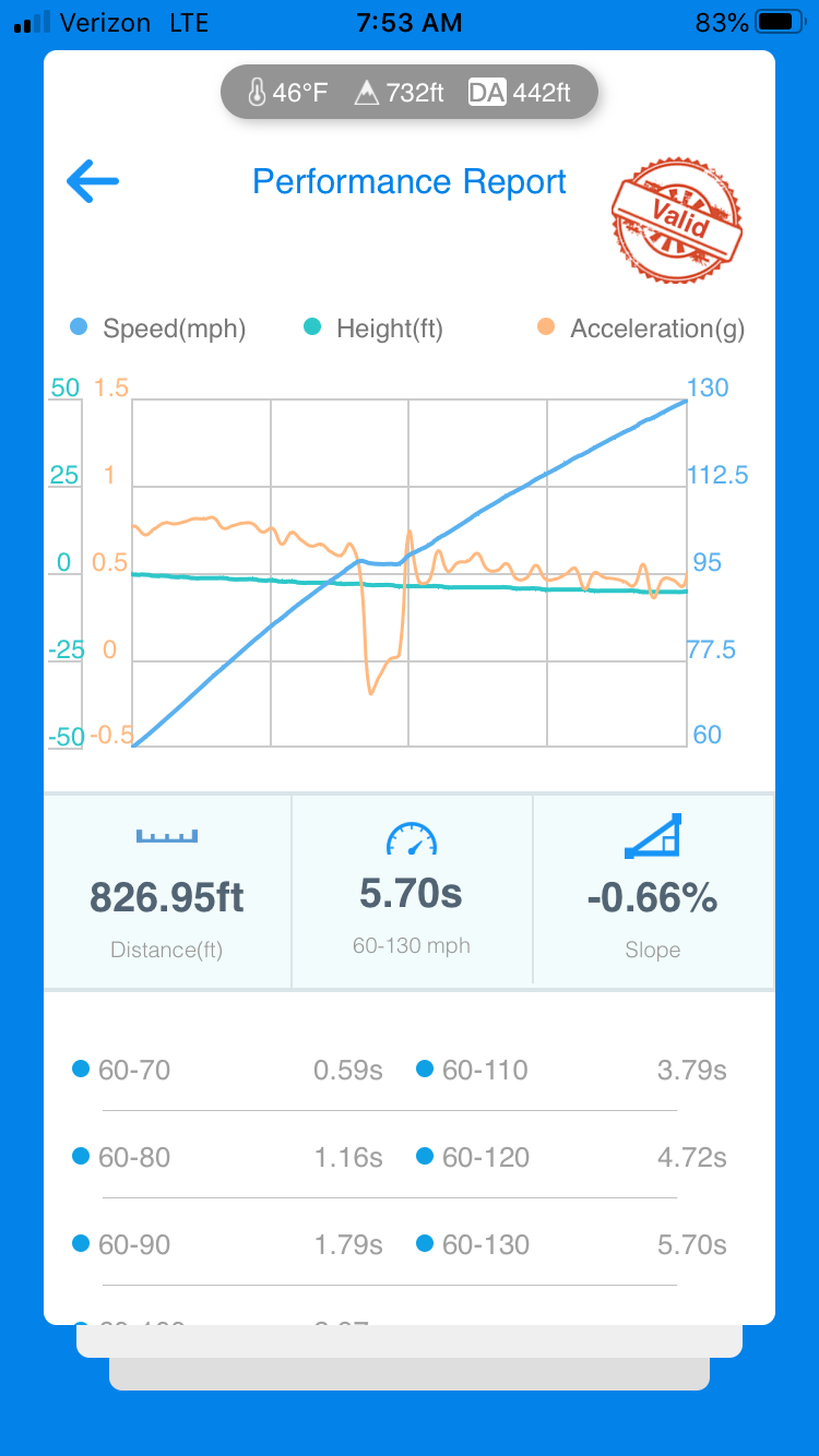

2.51 60-100 nice.
Have you done any 60-130’s?

My 60-130 isn't great due to my shifting- its 6.0 seconds in the few 60-130 pulls I've done. The 60-100 time in 3d gear pulls is 2.51, and the 100-130 time in 4th gear pulls is 2.76. So if I could somehow eliminate shifting, the car is capable of 5.27 seconds on 91 plus meth.
Bogg pretty much nailed it when he told me that doing Xona's on the car would make the car's performance on pump gas essentially equal to VTG's on e85. So if you are running on e85, then maybe it's not worth it to do the Alpha turbos. But on the other hand, if you have e85 available, you could do the Alphas and run e85 for some monster power. My car makes 100 more wheel HP and 60 more wheel torque on e85 with the Xonas than 91 and meth. I had not yet done any timed runs on e85 yet. But indeed I think you would need to build your motor to take advantage of Alphas on e85. It's a very slippery slope!!

I have do88 inlet pipes, and I am not aware that there were any issues with the fit on the XR1000's.
Here is a preview of what you will be enjoying once your car is up and running with the Xonas. This is with a moderately lazy third to 4th gear shift.

You can probably shoot Sam at ByDesign a quick email or text about the Do88 intake pipes for clarification. I put mine in myself when I was running 68vtg’s. When the Xonas went on I’m not aware that they had any issues fitting on the Xonas. And maybe Pwdrhound can provide some additional detail- he’s pretty hands on and knowledgeable.
Btw- the Dragy 60-130 pull I posted was on 91 and meth, my daily driver set up. I haven’t done an e85 pull. I’ve only run half a tank of e85 through the car so far but I can tell you that it was way faster and stronger on e85, and on the dyno it made a full 100 wheel HP more than on the current 91 plus meth. So I should be in the 4’s on e85!
