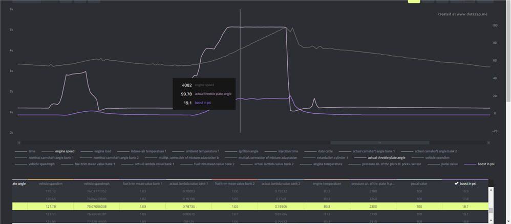

Originally Posted by The Bogg
very competitive...if you have e85. I don't...otherwise I would have kept my 68s.
The Xonas can hit full boost a couple of 100 rpms later but I don't bring them in quite that early. Not looking to change my rods, lol.
My 68s are hitting 19psi at 4082....mind you running ****ty Champion headers that have a leak somewhere and a catted exhaust. These xonas looks like they would perform better on the street with the E85?
