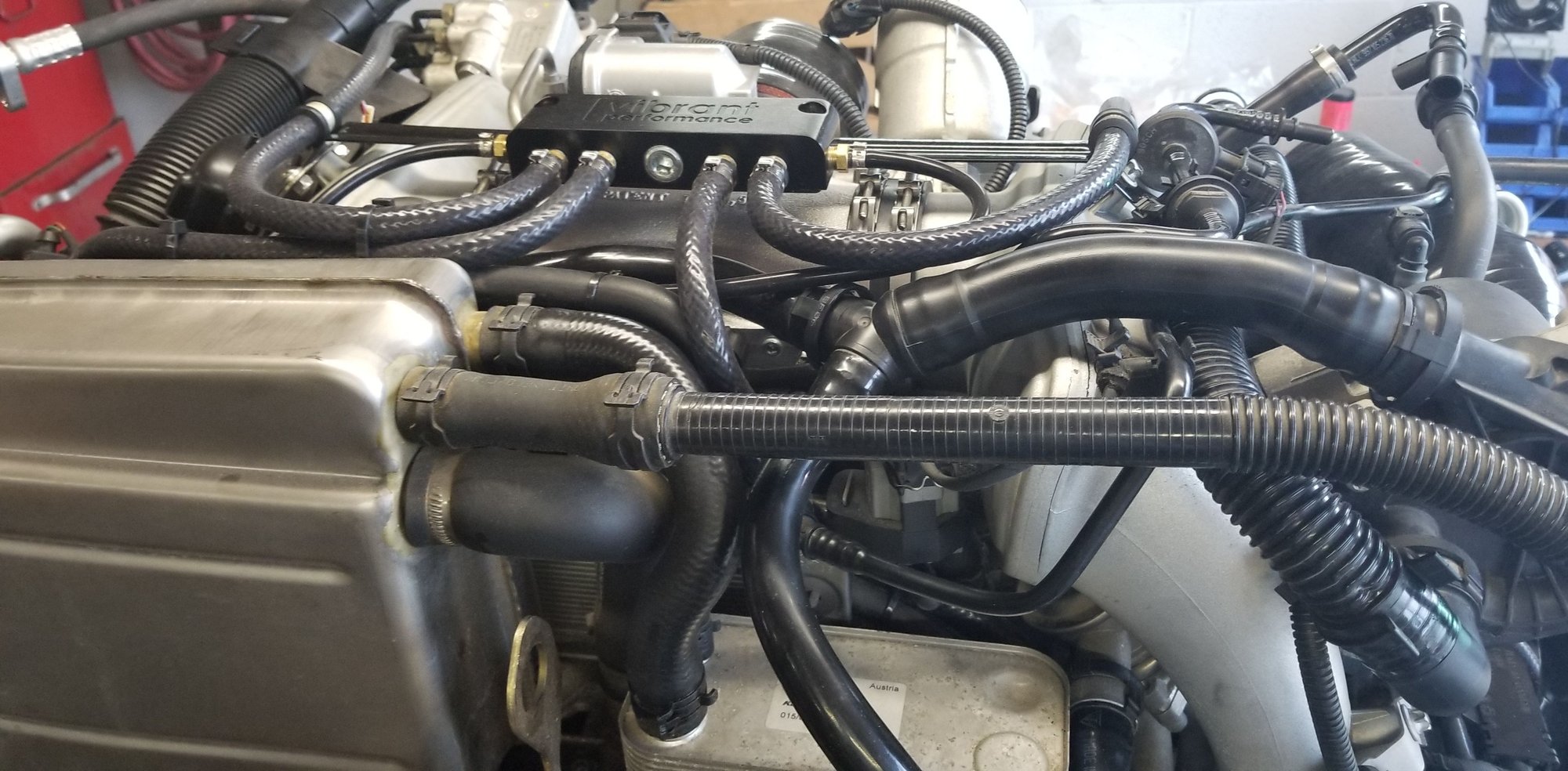

what is that "Vibrant" thing above the plenum? So the filters aren't necessary? Is the actuator screwed into the intake runner or is it just sitting on the surface? I assume equal length tubing to the wastegates even though the actuator is mounted on one side of the engine?
It's an air manifold and minimizes any splices or tees. The IPD plenum feeds it and it feeds everything else. Not sure the length to the WGs is exact side to side or that it matters. The boost controller feeds a tee somewhere in the middle so its close.
The actuator is bolted to a bracket which is bolted through the factory tie bar. No penetration into the intake manifold.
oooh that's nice. Is it the stock factory tie bar just painted or something aftermarket? Maybe I'll mount my solenoid there too. Actually that was my original plan but it looks so clean at the back of the engine behind the plenum. I will figure it out when the time comes.

A small tab was welded to the stock bar to mount it a bit lower and it was painted black. I think you can get away with just bolting it directly to the bar.

That is a sexy setup! I was thinking of using a vacuum block like yours to eliminate all the OEM hardlines....good to see it can be done. Do you mind creating a separate thread detailing this setup? Maybe even detailing part numbers if you have them?
Originally Posted by DOOBEE
I'm surprised the rigid boost tubing was resued. I replaced all my hoses. The AN solution is nice.
My controller is mounted here. Nothing is really accessible. No filters inline, they are a weak link.

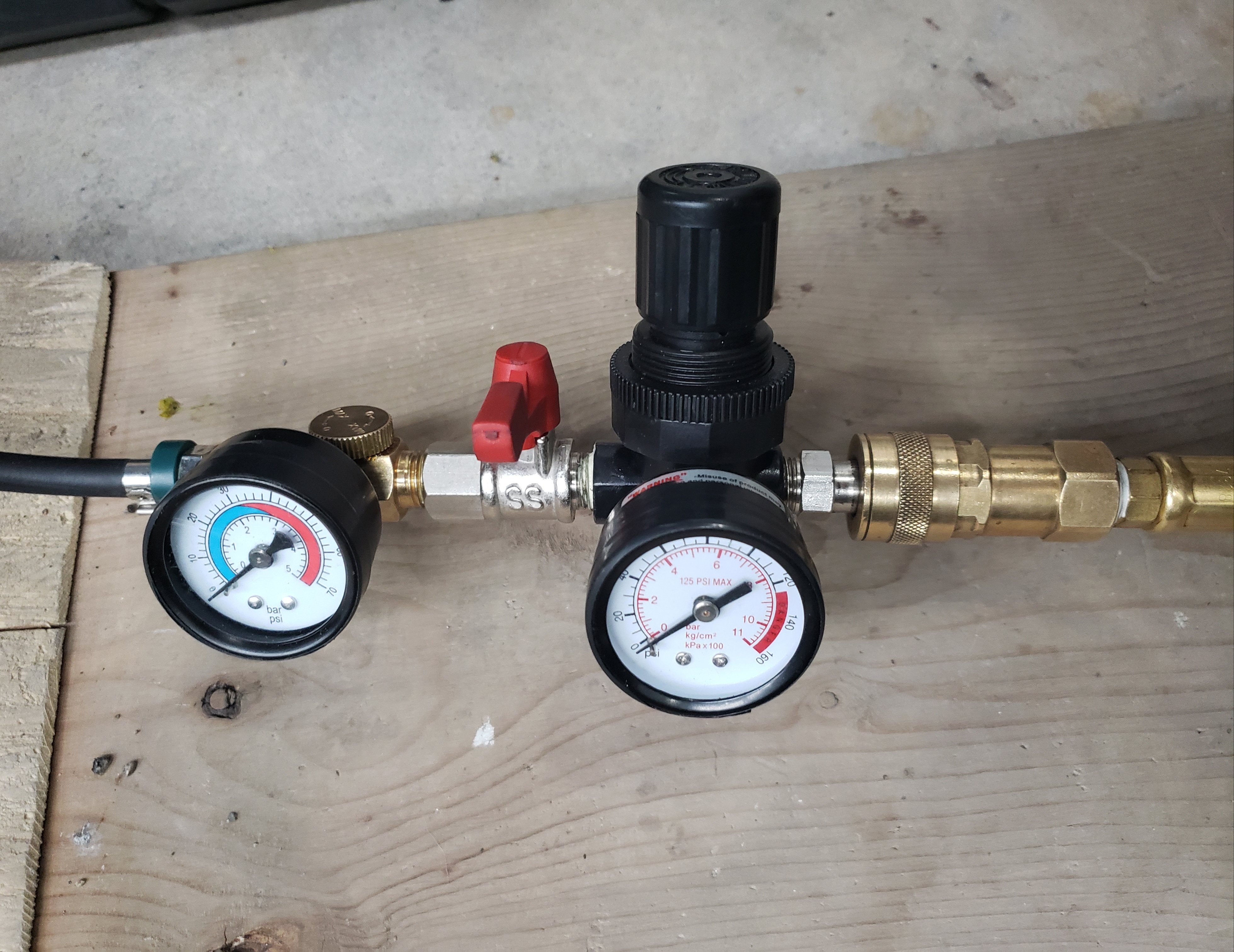

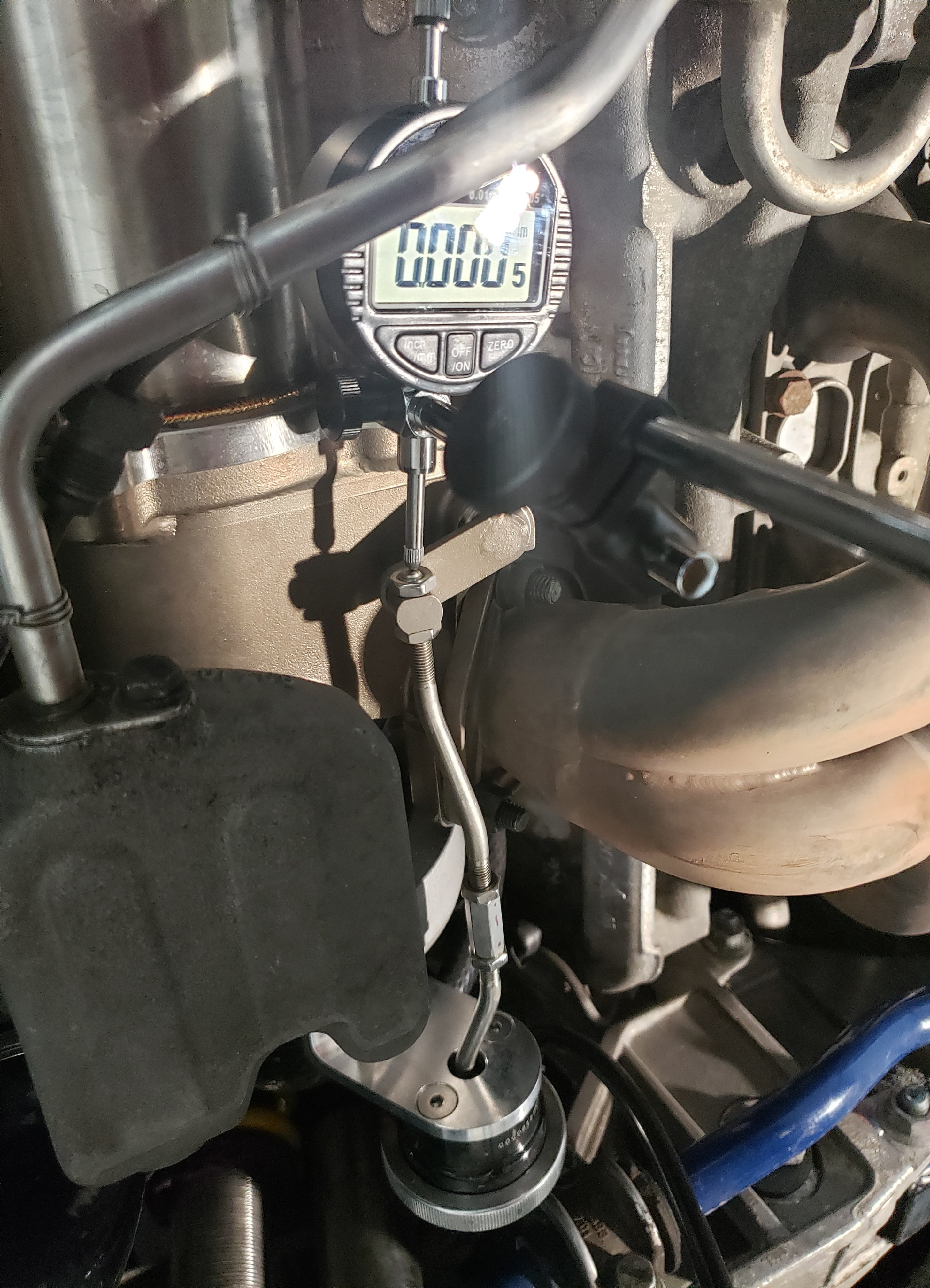

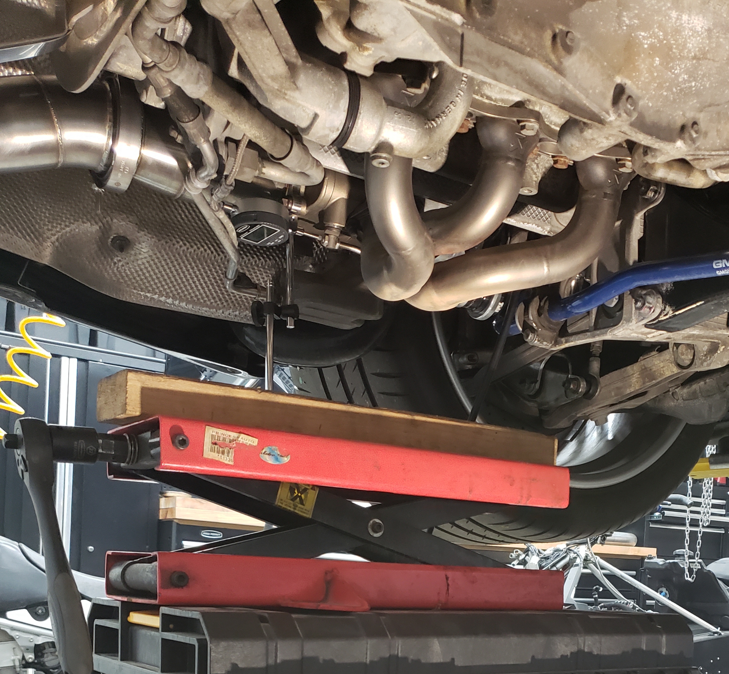

Tial advised getting a kit together (they gave me a parts list) so I could test the wastegate for exact cracking pressure and range, which is something my shop and I should have done while the engine was down. But I'm a noob when it comes to aftermarket turbos and so was the shop. Anyway, I put together the pressure regulator and hosing and a compressor and when I tried to take the hose off the barb on the wastegate I just couldn't get it off.
Good talking to you. Thanks for sharing what you've learned.
The Tial barbs have sharp edges on them that really grab the hose.
Some pics of the process to check and sync the wastegates. This is how mine shipped.

That digital calibration apparatus looks a lot more accurate than my 49 year old eyes staring at the stem from 1 foot away (car was on a jack, not on a lift) and trying to determine when the wg cracked, lol. I subsequently came up with a better method, lol.

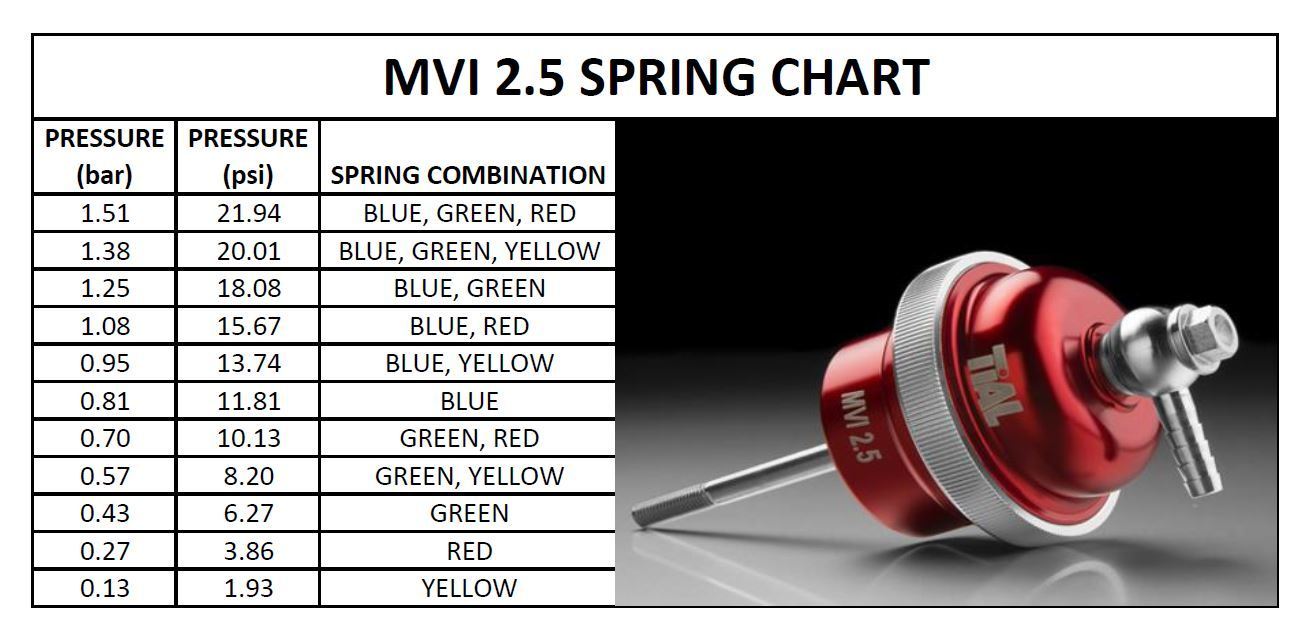

You have the blue springs....
Old May 21, 2019 | 06:51 AM
  #299
DOOBEE's Avatar
Joined: Oct 2012
Posts: 143
From: Newmarket, Ontario
DOOBEE is infamous around these partsDOOBEE is infamous around these parts
Thanks. Just the blue in there?
Bogg, what did you change to? Green?

Yeah the green one. I think if you do the settings we discussed you may be okay without changing anything....
