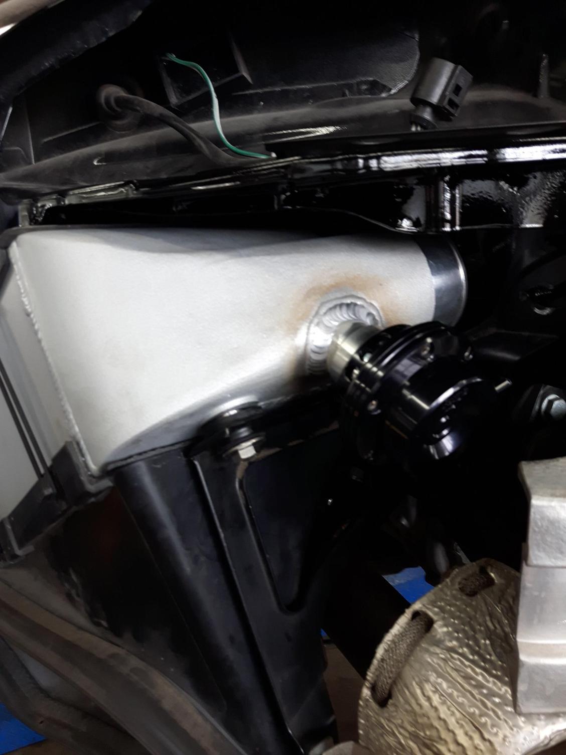

It still amazes me that even though the bovs are at the back of the car, behind the engine, tucked in behind the intercoolers I can still hear them even with the window open and wot pulls. Sounds like someone opening a cold can of fizzy coke each time you get off the throttle after some boost.

Which intercoolers are those and how do they fit in the car ?
Thanks - car is looking good
Old Jun 4, 2018 | 06:04 AM
  #94
The Bogg's Avatar
Joined: Sep 2009
Posts: 2,658
From: GTA, Ontario, Canada
Rep Power: 236
The Bogg Is a GOD !The Bogg Is a GOD !The Bogg Is a GOD !The Bogg Is a GOD !The Bogg Is a GOD !The Bogg Is a GOD !The Bogg Is a GOD !The Bogg Is a GOD !The Bogg Is a GOD !The Bogg Is a GOD !The Bogg Is a GOD !
Thanks - they are the DO88 Big Pack intercooler and ypipe setup. The intercoolers fit fine with just a little bit of cutting of an inside metal panel. I think I have a pic of it...will post it later. The ypipe is big and it fit but we had to remove the "shocks" for the rear trunk lid because they would press on the ypipe when the lid was closed.

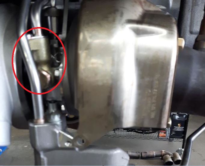

Valves look good there. I'm surprised the lines were so simple. Did the banjo fitting on the coolant port and the adapter for the oil line feed come with the turbos?
Old Jun 4, 2018 | 08:58 AM
  #96
The Bogg's Avatar
Joined: Sep 2009
Posts: 2,658
Rep Power: 236
I had to google what a banjo fitting was, lol.
This particular kit came with everything except the coolant supply lines. The other lines were stock parts and I believe any adaptors were already included, perhaps Sam can chime in on that one. This is the main difference between alphas and garrets I think - i.e. the alphas are mostly bolt-on with very little modification required. I've seen some kits such as the AMS kit come with a whole set of fabricated lines. When I received my kit I was like "this is what I paid a grand for???" referring to the one pair of coolant supply lines, lol.
I thought the adapters are Protomotive not just the coolant line. Maybe I'm wrong.

these banjo to stock fitting adapters are TiAL or Protomotive?
Old Jun 4, 2018 | 10:10 AM
  #101
The Bogg's Avatar
Joined: Sep 2009
Posts: 2,658
Rep Power: 236
I don't know...my shop said the necessary adapters were there but I don't know if it's part of the package from Tial or from Proto. Sam?

Thanks for confirming Sam, that was my understanding too.
