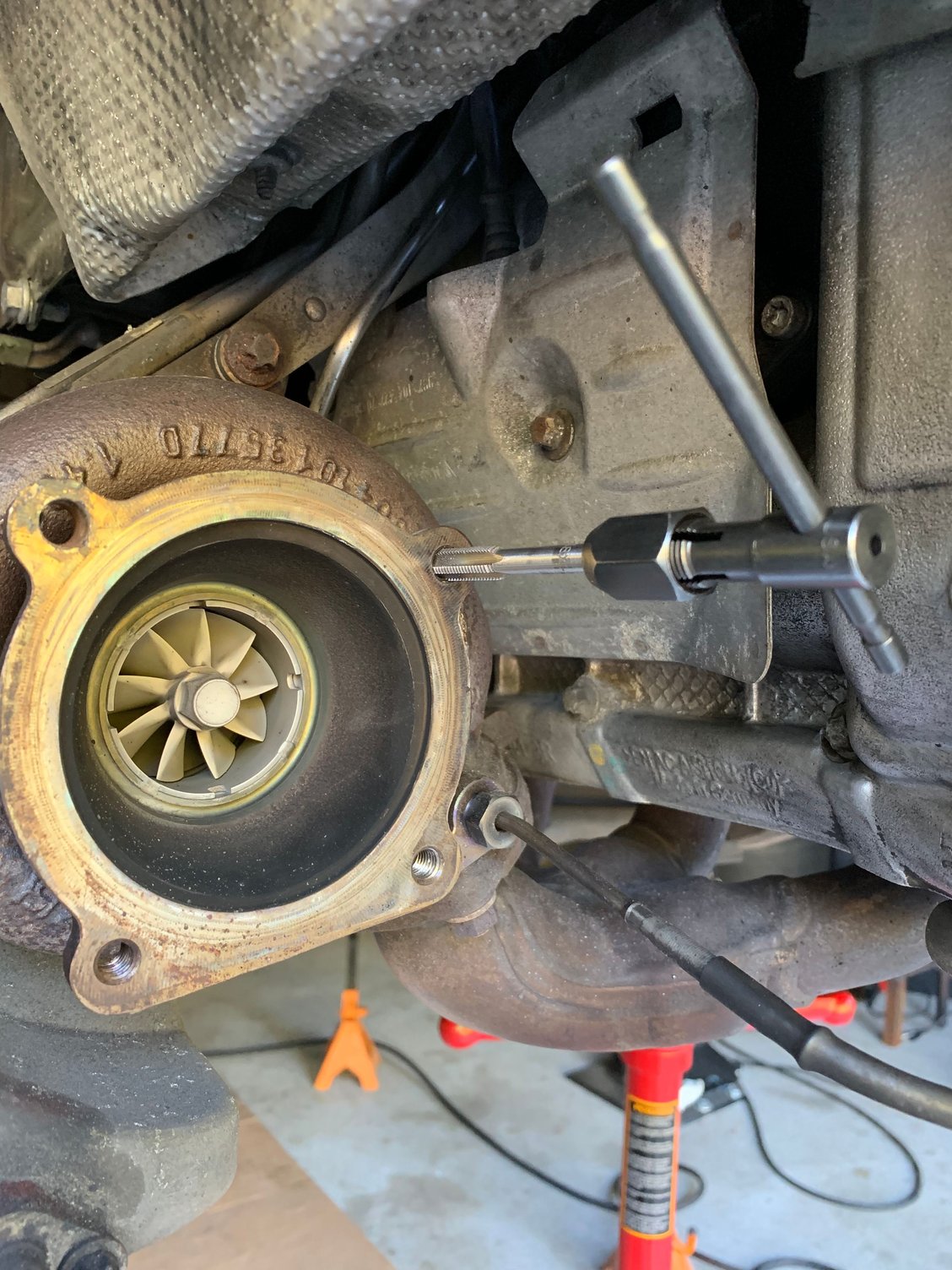

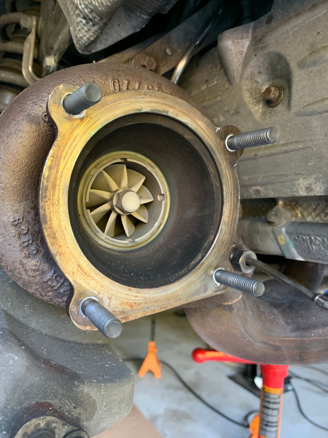

Got more work done today but ran I into two stripped exhaust bolt threads. Man was that a total pain to get re-threaded. My titanium exhaust wrap arrived today but waiting for the silicone high temp DEI paint to come.
I found one bolt that was drilled out on the left turbo by the previous owner I guess.
Getting super close to finishing now.

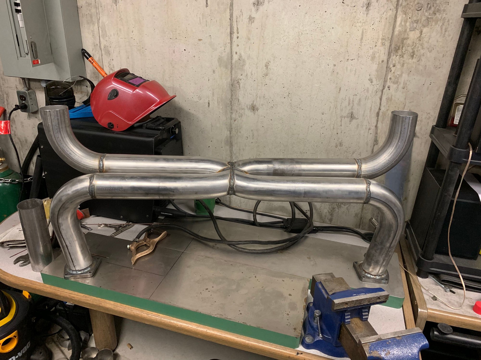

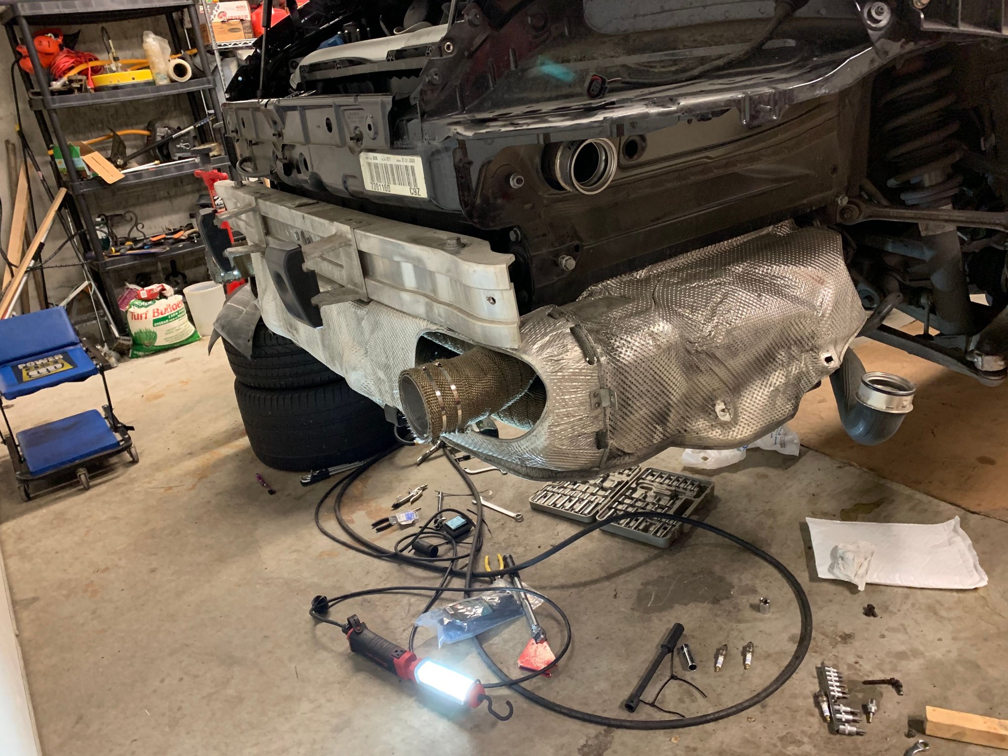

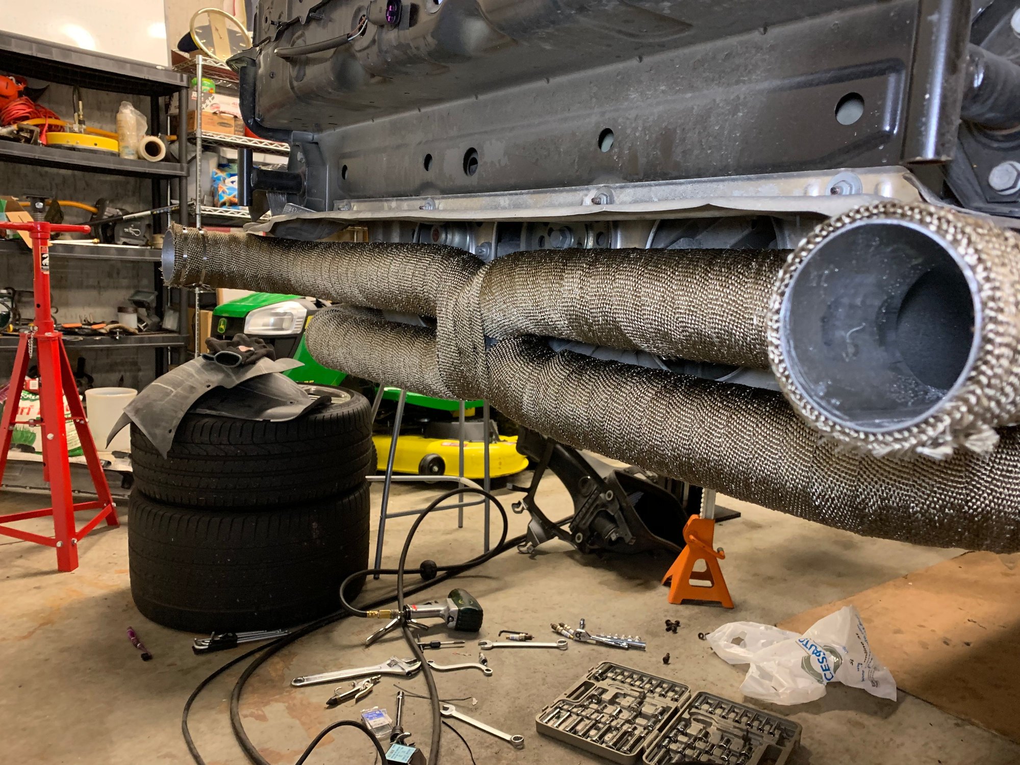

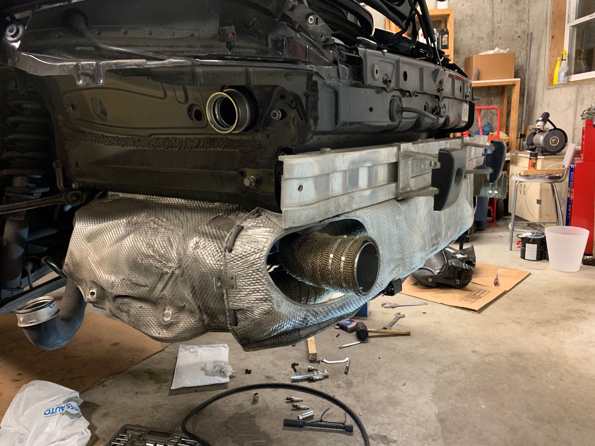

Well I finally finished my exhaust and the services I wanted to carry out. I put a new fuel filter, new spark plugs and built a completely new exhaust from scratch. It has been a lot of work but I’m very proud that I got it done.
I only started the car while on the lift as I’m still waiting for my rear tires to come in. I did get the PASM failure but I was expecting it since the battery has been disconnected for over 3 months.
Exhaust sound is is very deep and quite a bit louder than stock. I haven’t had a chance to drive it and hear it under load. I didn’t rev it because it is 1 am here and I don’t want to wake my family or the neighbours.
Here are are the pics and I will try to upload the video.

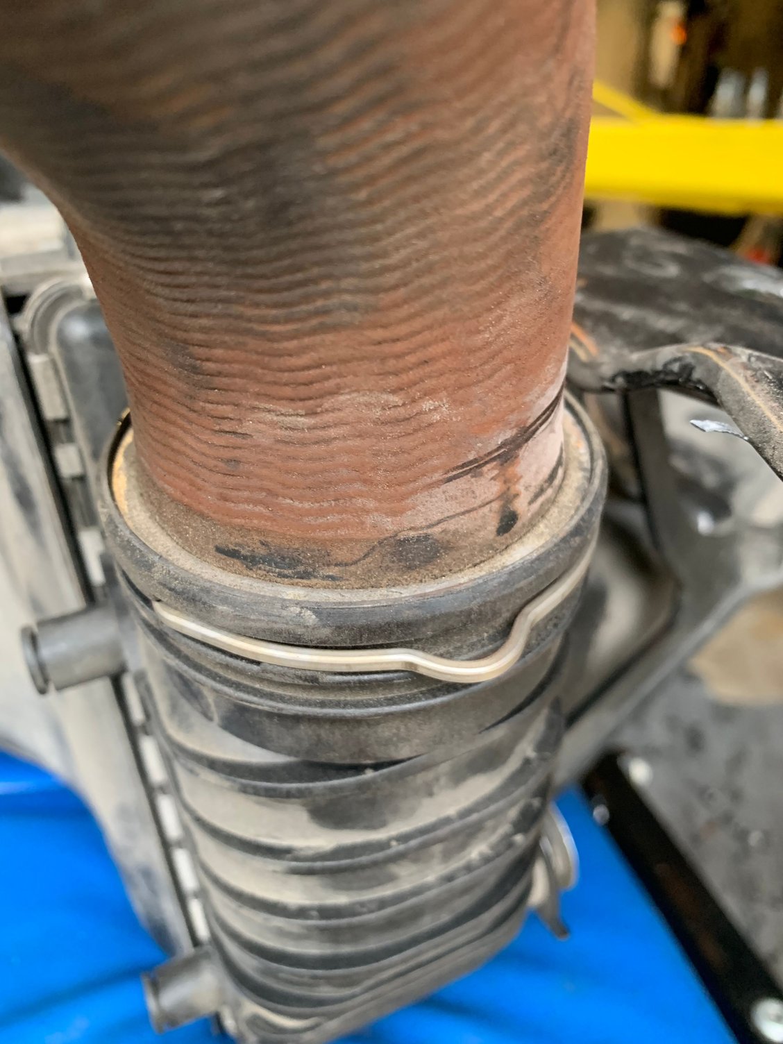

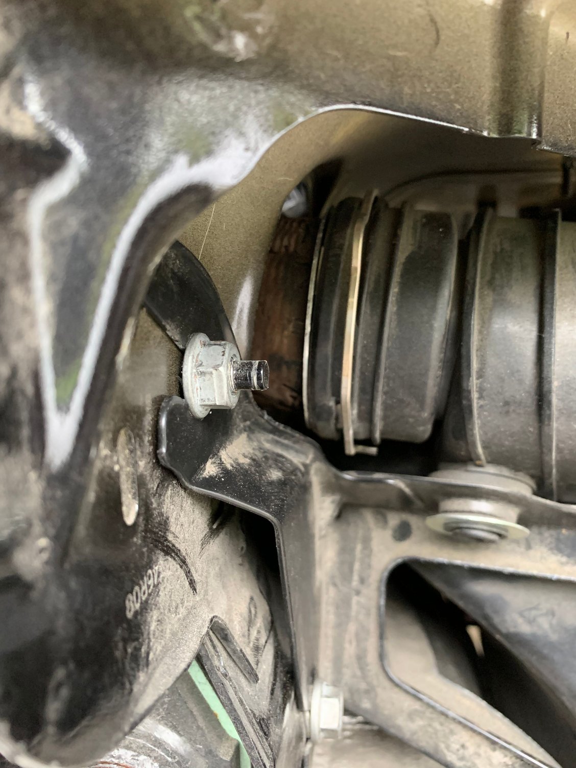

I have been been driving around a fair bit and I have really missed driving this car!! I had a few spirited moments but then ended up with a check engine light. I got my POR2 scanner out and it came up with P1095. After researching a bunch it came up as air entering the system after the MAF’s. So the bumper and back end came off again (I’m getting really good at it now lol) and found that the upper inter cooler hoses on both sides had blown off. It was a simple fix but I noticed that the rubber gasket on the flange end was rolling up as it was being inserted and thereby preventing the hose to seat all the way in. A bit of lube on the rubber ring and it fit perfectly. More updates once the resonators show up.
