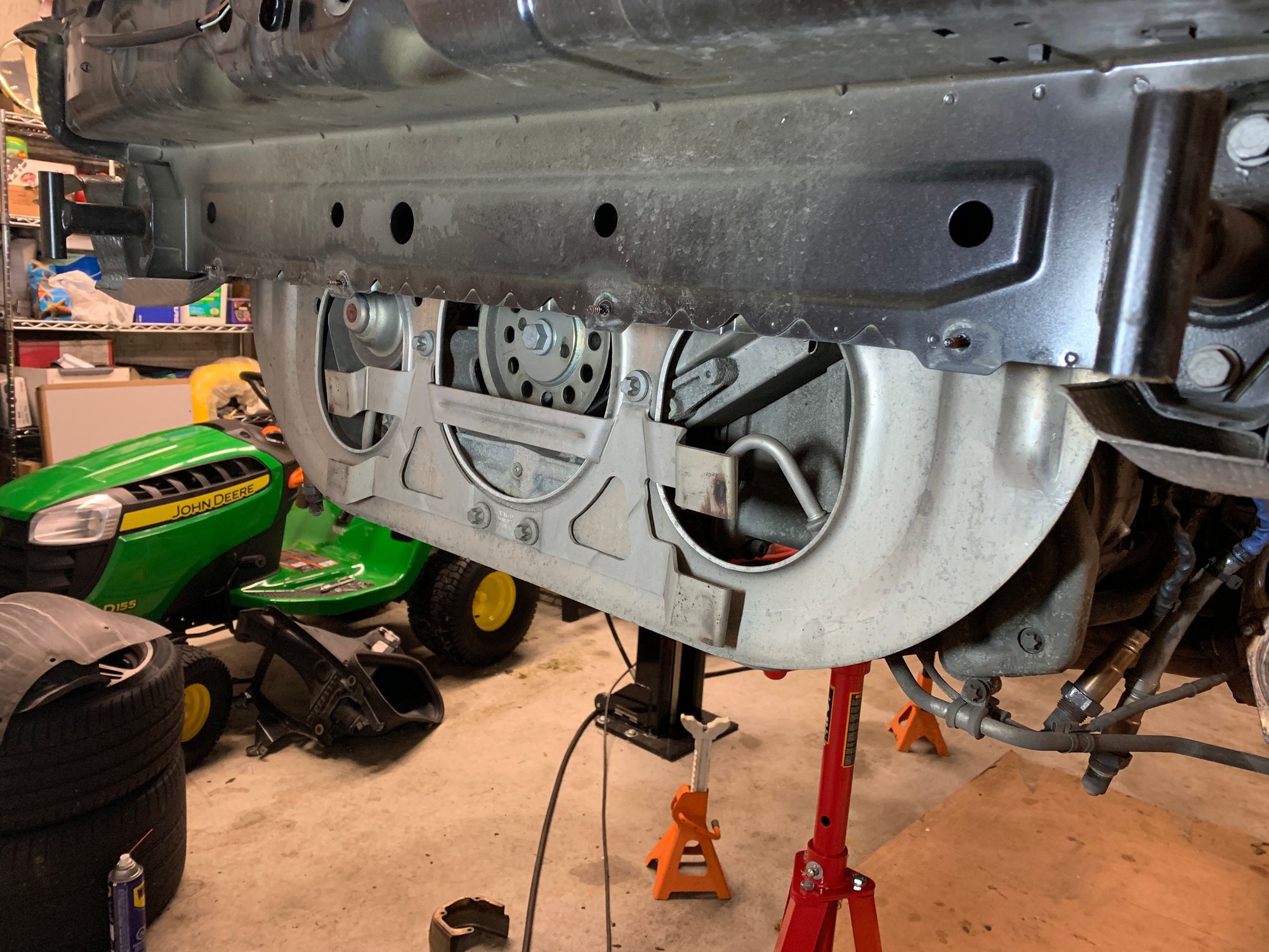

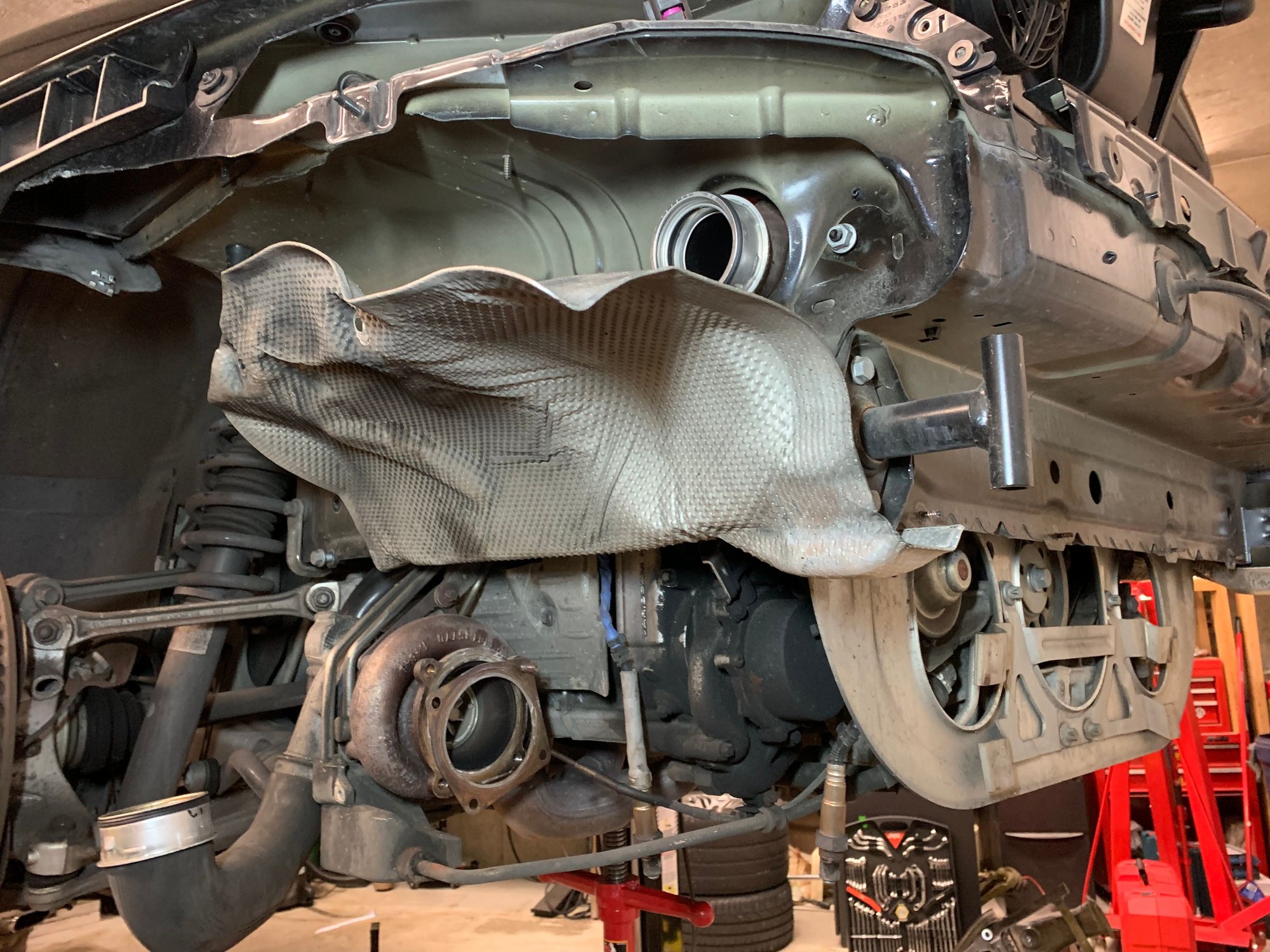

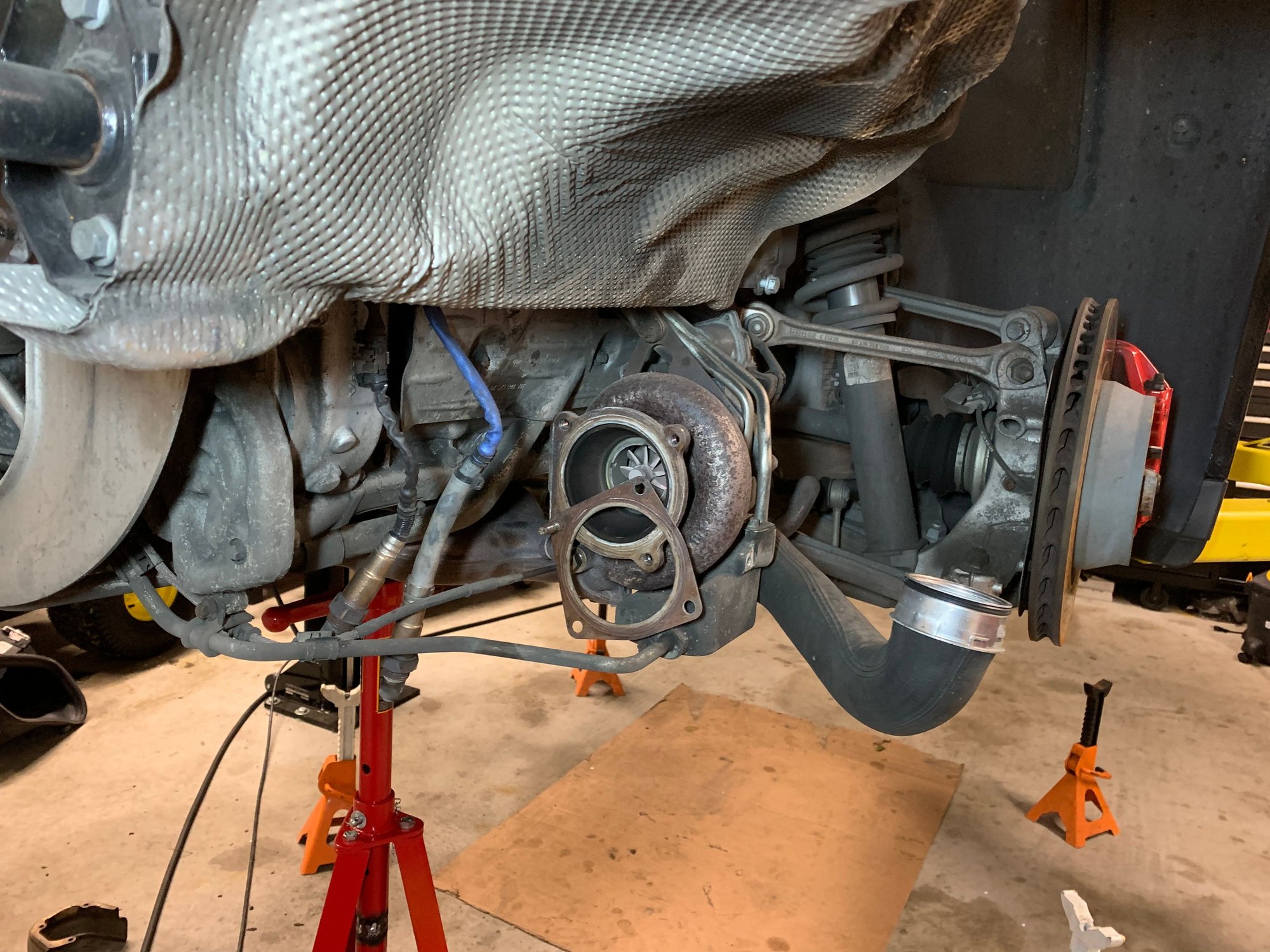

I’m currently working on doing the plugs and building an exhaust for the car. I am doing everything myself except for getting some laser-cut flanges that I’m having made. Here is my progress so far:

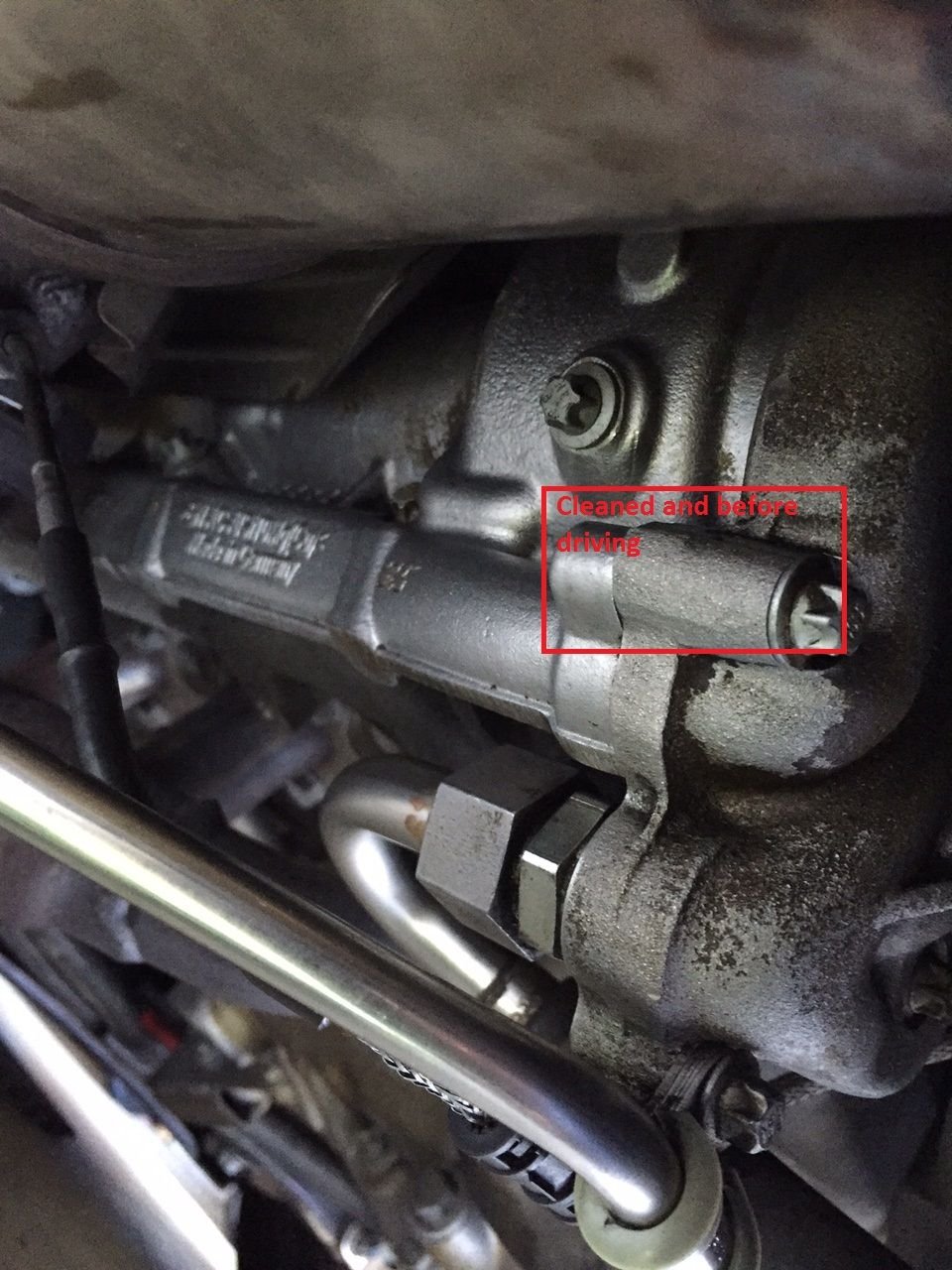

It it has been fun working on it so far and it really helps me to learn about the car. I then found this build up near the bottom left part of the engine. There has never been a leak of any kind and I haven’t lost any fluid. I was wondering if anyone has any suggestions as to what this might be.

Well there has been a leak of something for sure. Could be spillage from above but doubt it. More likely a small leak from the tandem pump gasket.

Nothing to offer on the leak my 996 would have oil sweat from the cam sensor gaskets.

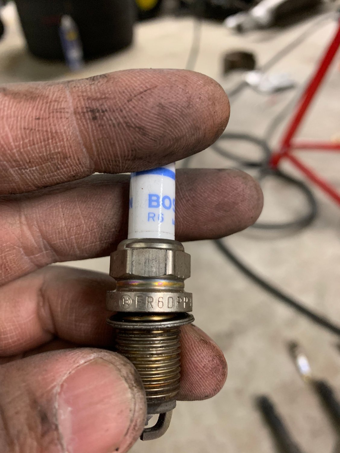

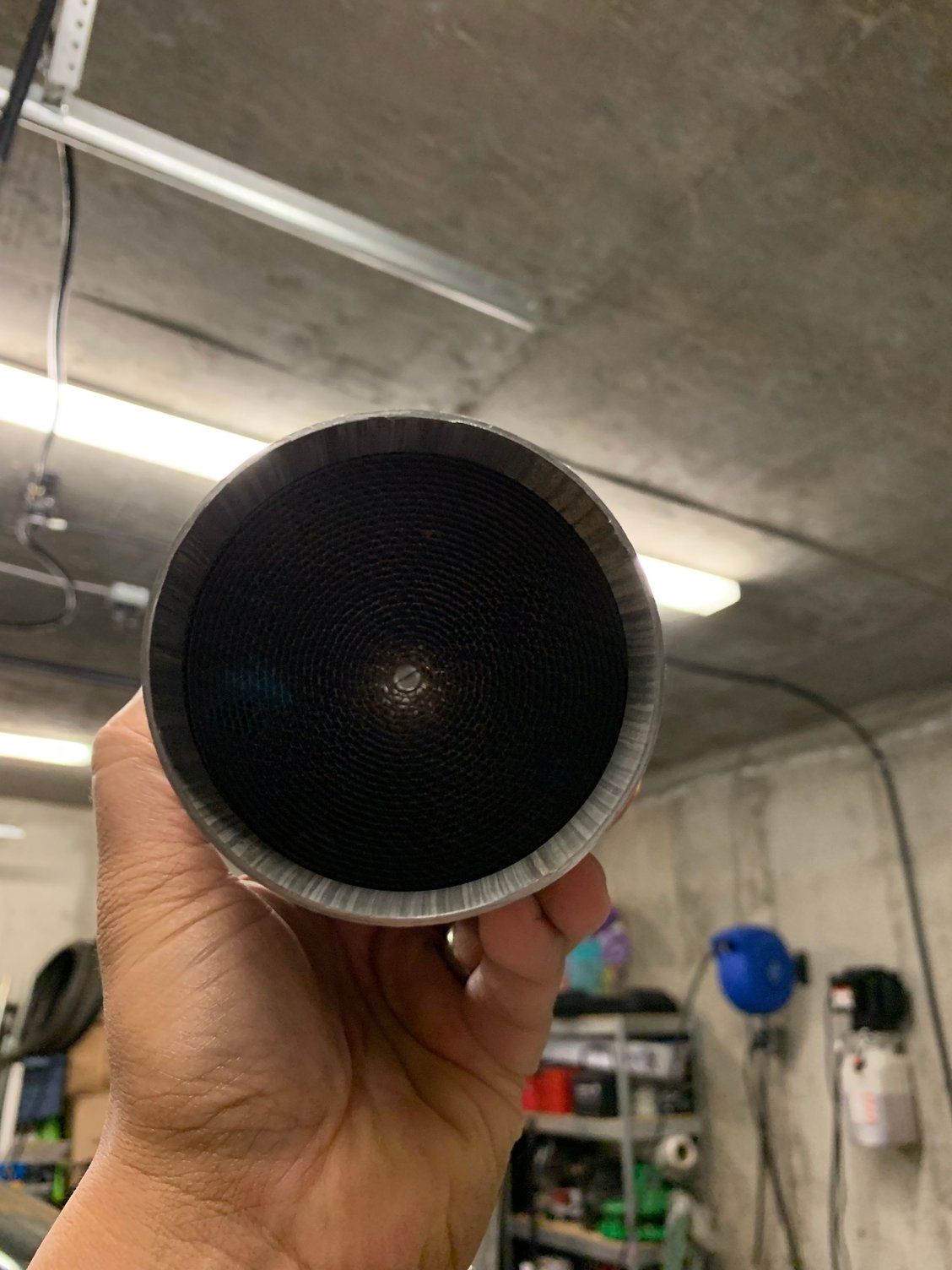

So some slow progress to report. My Vibrant racing catalytic converters came in today. They are a true metallic core with 200dpi cell count. I have used these successfully on some of my other cars in the past so I’m curious how the exhaust will sound.
I also got got the passenger side plugs removed. Relatively easy with the right tools but my big hands were challenged to get into those tight spaces. Later this week I’m going to tackle the drivers side plugs.
I have not made much progress on figuring out where this leak and build up is coming from. I think I’m going to try and steam clean the area to see if I can find out where it is coming from. My flanges for the exhaust should be done by next week.

the right side was simple enough as soon as you remove the servo for the variable vains on the turbo. The driver side is a very different story. I’m hoping to tackle that either tonight or tomorrow. I might end up lowering the motor a bit as mentioned in the Rock’s DIY to give me more room. I have big hands and it has been a bit frustrating. But I’m taking my time with all of this. It is primarily plug and coil number one that is the issue. The other two are super simple with lots of access.

Good tip for the BRV’s. I’ll get that done as well. I’m using a Max Jax lift. I have a 5 car garage at my house. 3 up top and a double under around the back. I went with this lift because it fits in my lower garage. I can get pretty much all of my cars 4’ off the ground which is more than enough for me. It is the best tool I have and used the most.

So got some steam cleaning done to try and find out where the leak is coming from. I think it is coming from the variocam gasket. I have spent a fair bit of time cleaning to see. I will watch it over time.

I had a similar leak. The leak could be form this screw???

Thanks Coquitlam! for the insight. Now that I look at your pictures and compare to mine, I think I might have the same problem - oil build-up seems to be concentrated around the same area. We should meet up at cars and coffee sometime - I live in Port Moody!
Thanks Iliejk for the cautionary note about the coating. I agree with you about the corrosion resistance but I do need to find out where this leak is coming from. I'll pursue some form of coating re-application once the problem has been diagnosed and repaired.
