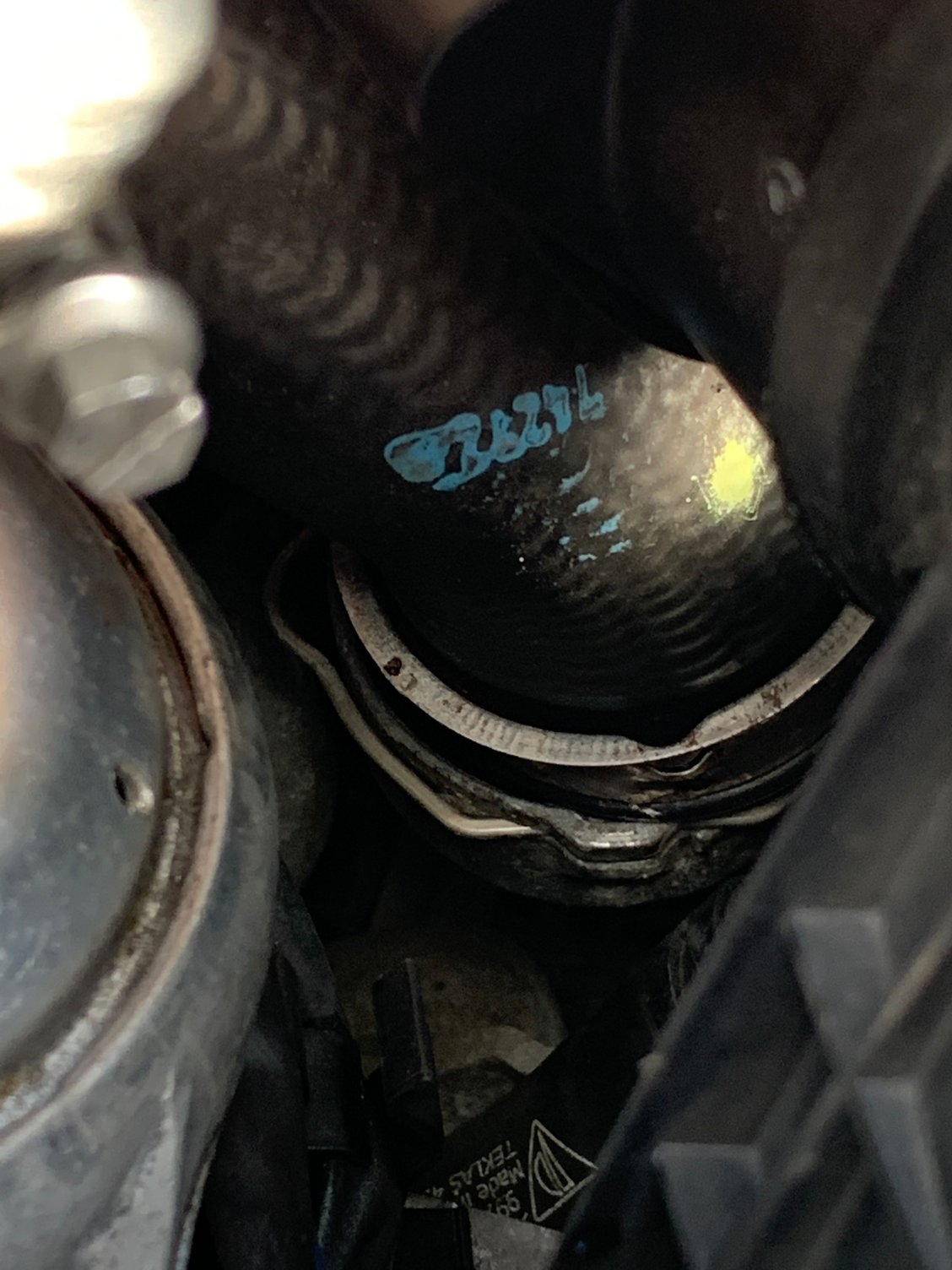

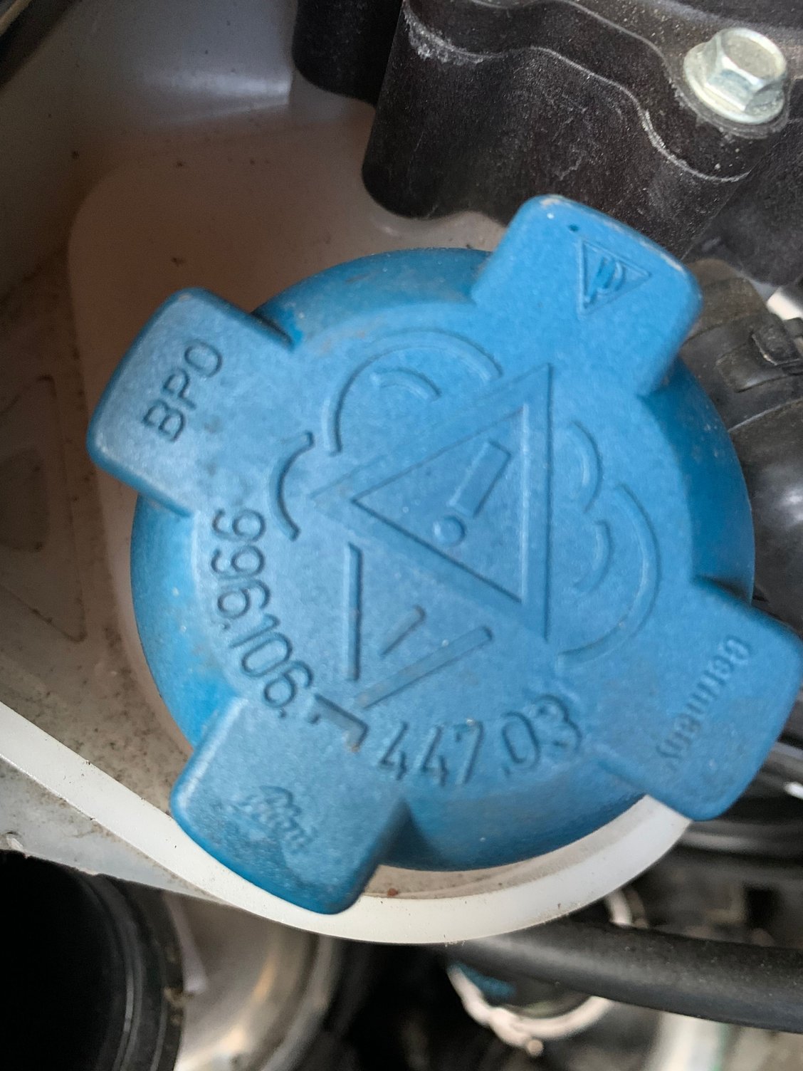

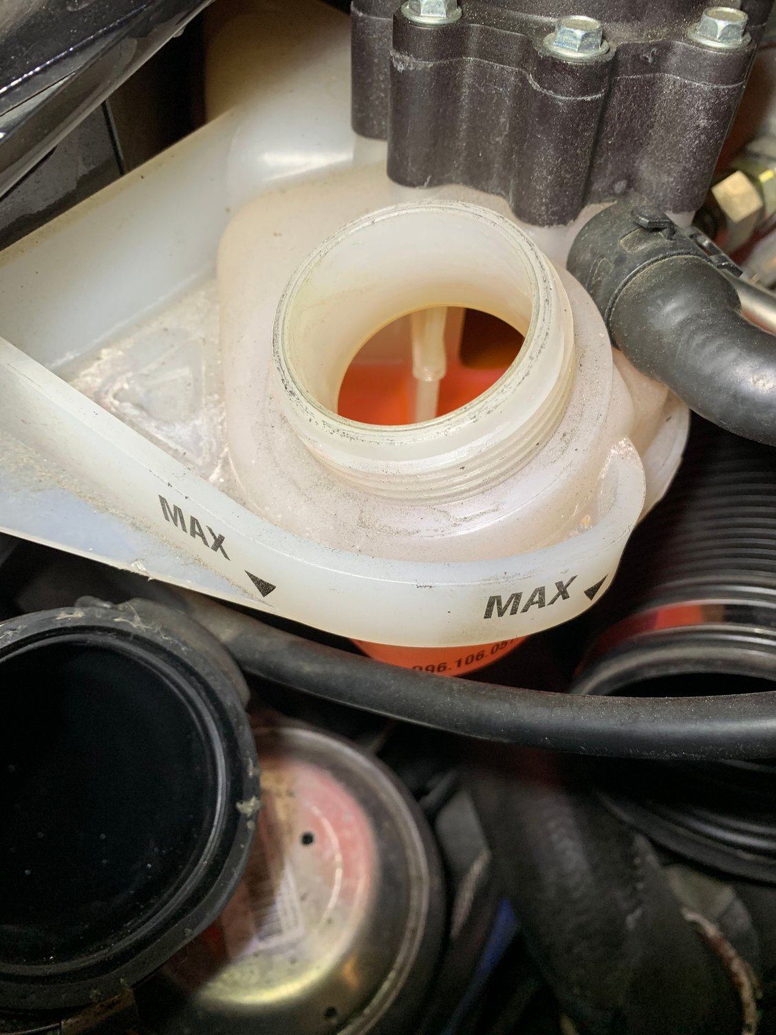

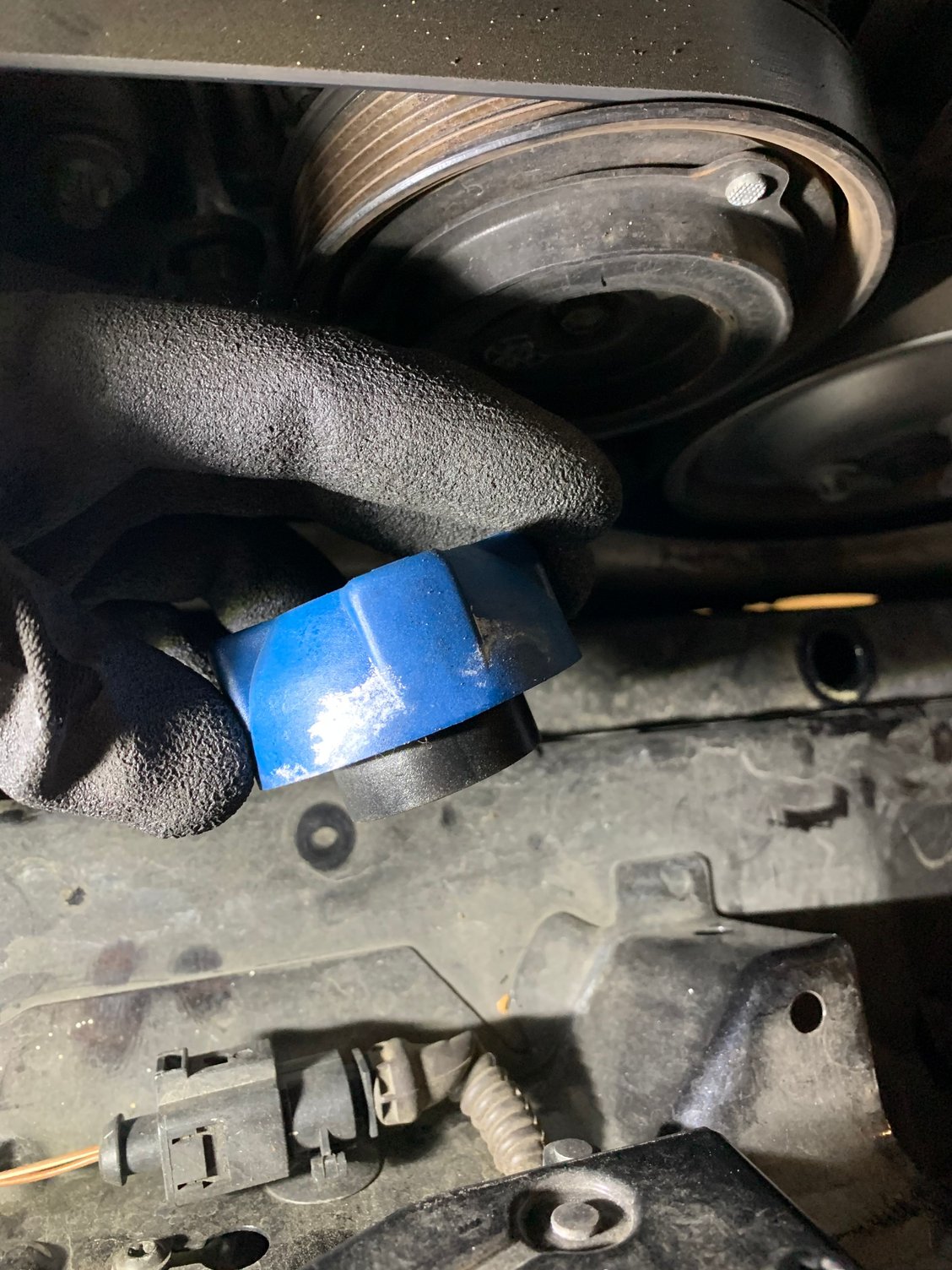

I was doing my oil change this past week and found some coolant drops under the car. I did notice a few drops last season after a “spirited drive”. I took out the airbox and charge pipes and found this:
after taking apart everything and removing the coolant I took off that connector to inspect the hose. After more digging around I looked up at the coolant tank and saw the white residue on the left side of the tank. I took off the reservoir cap and found residue on it as well. I did more digging around and found that I had the “03” cap and read online that the “04” cap was the updated one and this was a common issue. I ordered a new one online along with a vacuum pump to refill the coolant. I’m not a fan of the idea that the coolant is lifetime. The car is a 2009 and only has 43,xxx kms on it. I was glad to remove the coolant and figure this one out. Was worried I would have the dreaded coolant fitting issue.

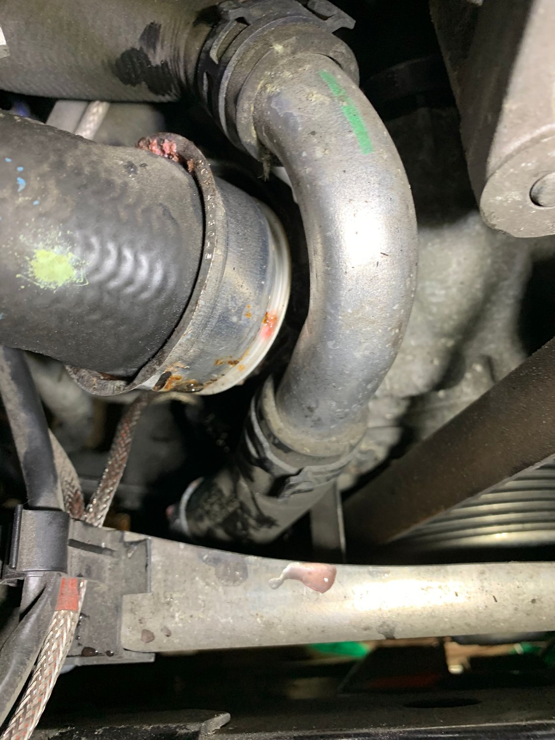

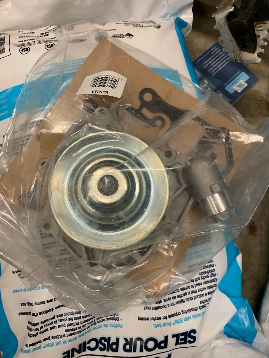

Since the initial repair on the cooling system my water pump went out on me and along with that the connection that I had taken out. Went out with dramatic flair right as I was in the middle of a pull on the highway on-ramp. Coolant went everywhere and I thought I was experiencing what others described as a fitting letting go. Had the car put on a flatbed and sent home. Did the repair over 4 nights and took my time with everything.
I was able to source a new pump and install it along with a new accessory belt. Check the bearings on the tensioners and other rotating assemblies. Thermostat was replaced 2 years ago and never had any over-heating issues so I left it alone. Was a big job but a huge thanks to TheRock for the amazing guide! I strongly recommend that anyone doing this job get an Airlift coolant replacement tool (https://www.cpsproducts.com/product-details/550500/). Made the job substantially easier and no issues since the repair. I did use grey gasket maker on the pump housing, gasket and the block - so glad I did!
Car is back on the road and running like a champion! Have a great season everyone and be safe!
