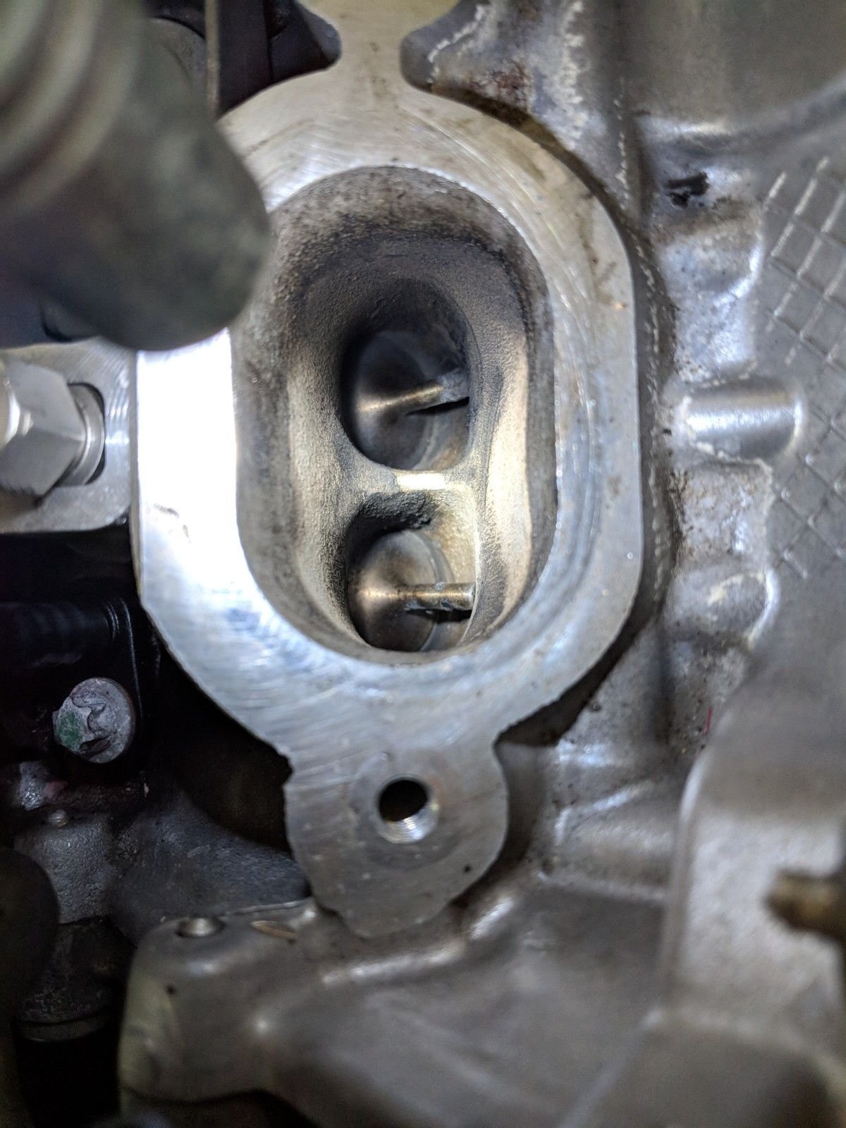

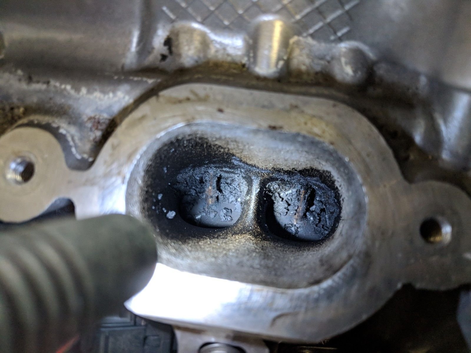

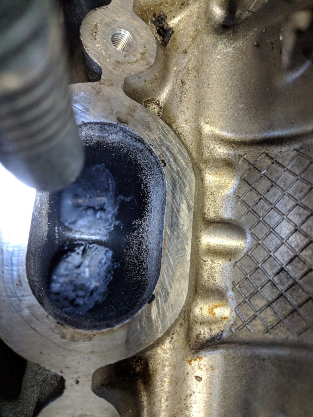

Bought a great 2011 PTT with 59Kmi in May, had a blast for 3Kmi and got a coolant leak. Mechanic found it under the manifold. I think this is common problem for this age of PTT. Did you know the Intakes need to be cleaned too? Take a look at #5 & #7 intakes before and after walnut shell cleaning. Other intakes were not as bad as these two, but also needed the clean. Car ran great before and I do not understand why, after seeing these images. I pick it up in few hours and will post if there are issues, otherwise I'm out and about with the PT...
#5 Before
#5 After
#7 Before
#7 After
Understand?
I was told I should use BG 44K now and then, which I plan to do right away to clean the injectors and piston tops; obviously they are covered in something...

Those 2 cylinders must be near where the AOS connects to the manifold...

I’m wondering if any of this breaks off and makes its way to the exhaust. Could there be a pile of this stuff at the entrance to the catalytic converter or plugging some of the cells?

very common with Direct injection engines.
