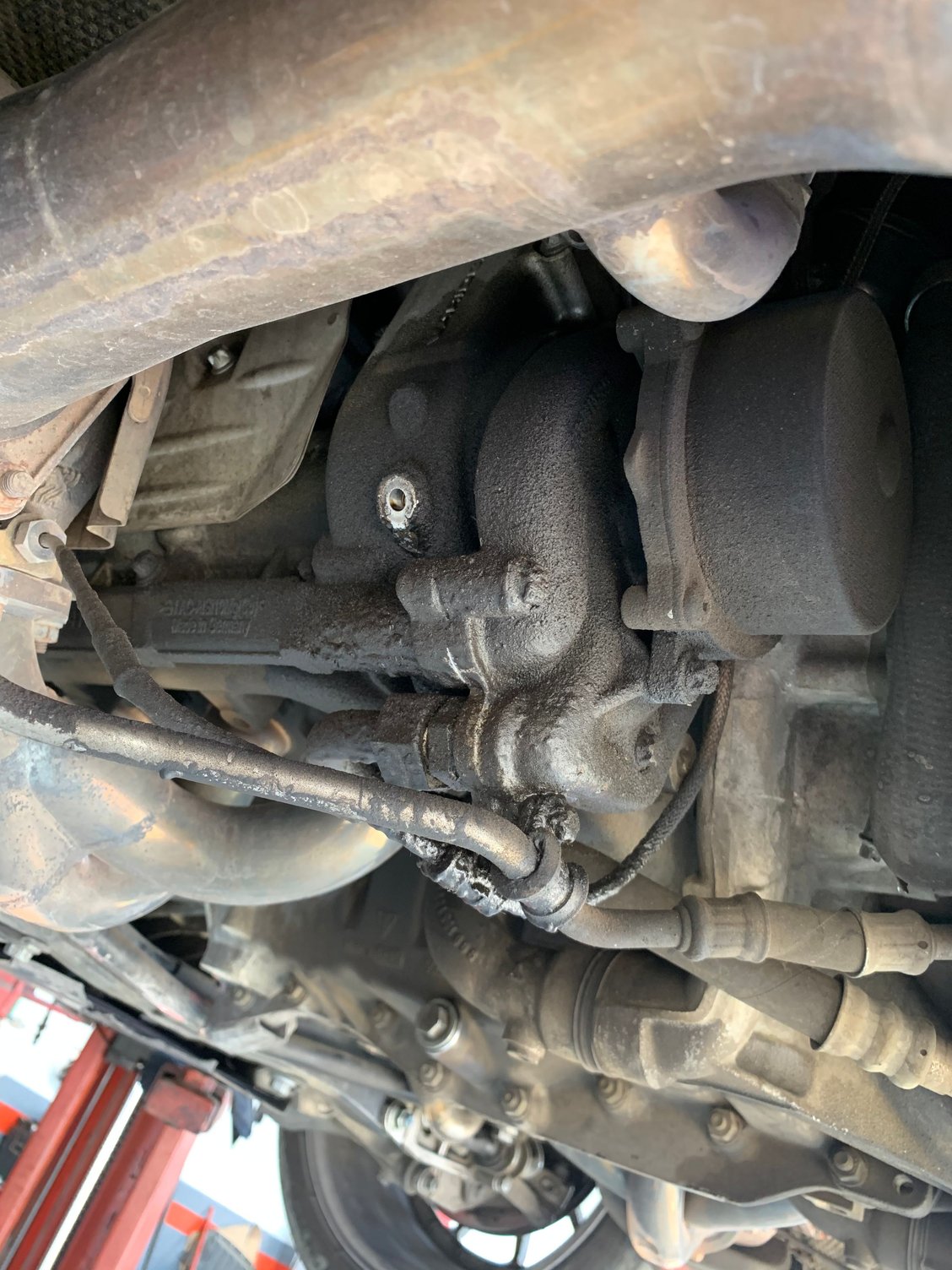

Hello. I went to get my oil changed in my 2007 997.1 turbo. It has upgraded Turbo’s and intercoolers with silicon hosing.
I drive the car hard but maintain it religiously. The oil level light came on yesterday so I came to get the oil changed and found oil seeping from the driver side intercooler with the car on the lift. Why is it happening and could it cause any damage? Any advice is appreciated.
Thanks. 🙏
First time I’ve seen oil seeping from the intercooler.
I also saw this hole that looks like it should have a plug in it. Anyone knows what it’s for?

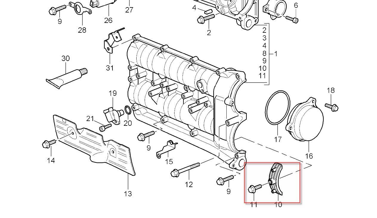

Oh, the missing bolt, that appears to be a cam cover bolt to a slide that the WM specifically says to NOT remove (and it appears to be a source of oil - but when the bolt was in place):
Any work done in that area of the car recently? I wonder if it was moved and then not torqued all the way and slowly backed out. That is a fresh missing bolt since it is so shiny.
Is the passenger side one in it's proper location?

Thanks! Yes theres one on the passenger side. Yes, after doing the oil change I topped it up so the last bar would also be filled. Guess ill have to keep it like that for the time being. I drove the car for a 3 hour road trip right after the oil change. No problems so far. Ill have to check to see where I can find another bolt for that hole.

Remember that screw holds a guide that sits on top of the cam chain. Hopefully the pressure of the chain is keeping it in place. I would get this replaced sooner rather than later. Hopefully you are not getting any strange noises or seeing any orange plastic in your oil filter.
According to the PET it is a Torx screw M 6 X 16, but I do NOT know the thread size. Maybe someone else can chime in.

I don't know why I didn't include this in the last post, but here is the Part #:
999 385 005 02

According to the PET it is a Torx screw M 6 X 16, but I do NOT know the thread size. .
Ed
Hi Ed
It is a standard M6 thread with a 1 mm pitch. Strength is (I am not quite sure) 10.9.
