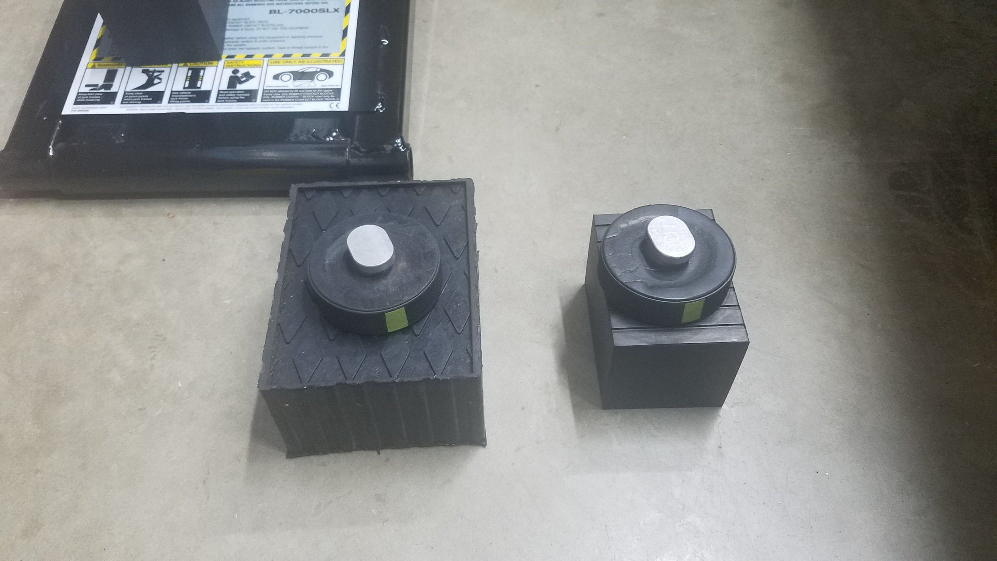

smaller blocks came with QJ. Larger blocks I got on amazon and they are from Rotary.. QJ and Rotary and both 3" tall

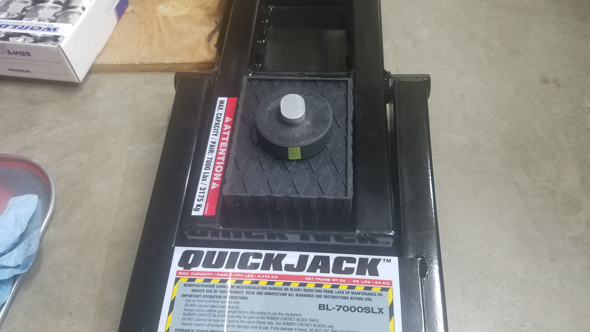

Thanks for all the replies. I ended up picking up a 4-pack of adapters from Pelican that resemble many of the ones posted but they are day glow orange. The weren't magnetic which would have helped but to keep them from moving around I used a little 3M heavy duty double stick tape next to the part that goes inside the hole in the chassis. I wanted them to stay put once the rubber blocks made contact. It worked great and no distortion of my rocker panels occurred so my goal was reached! I even remembered to pull the adapters out of the chassis after the job.
