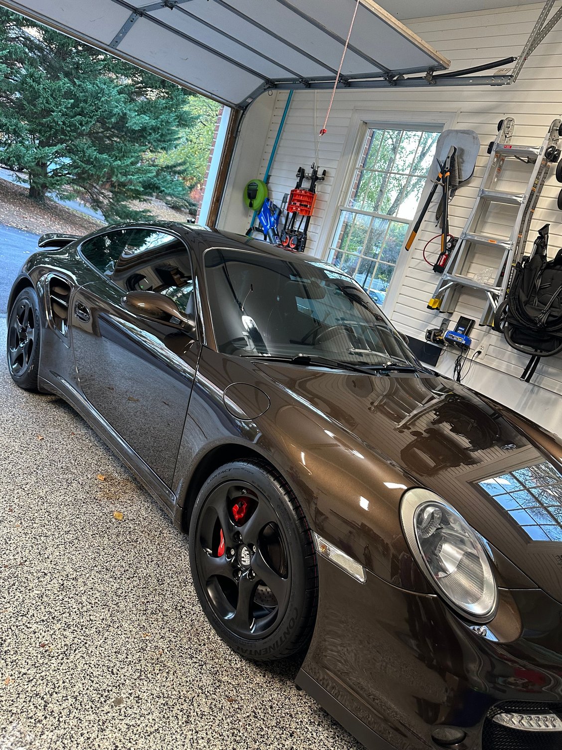

Posting here for reference in case anyone wants to do this in the future. I can confirm that the 18in 996 Turbo twist wheels (non hollow spoke) do indeed fit on a 997 Turbo.
996 Turbo Look II BBS wheels
Front
996.362.134.05
8 x 18. ET50
Rear
996.362.142.01
11 x 18 ET45
Tire sizes that keep the same circumference as stock tires so as not affect the AWD system:
Front: 235/40/18
Rear: 295/35/18
I went with Continental ExtremeContact DWS 06 Plus all-season tires because I’ll be using these as my winter setup and we don’t get crazy snow in my area
Clearance of the brake caliper and face of the wheel in the front are a bit tight but no risk of rubbing. I‘ll probably go with a 5mm spacer just to give a little more room.

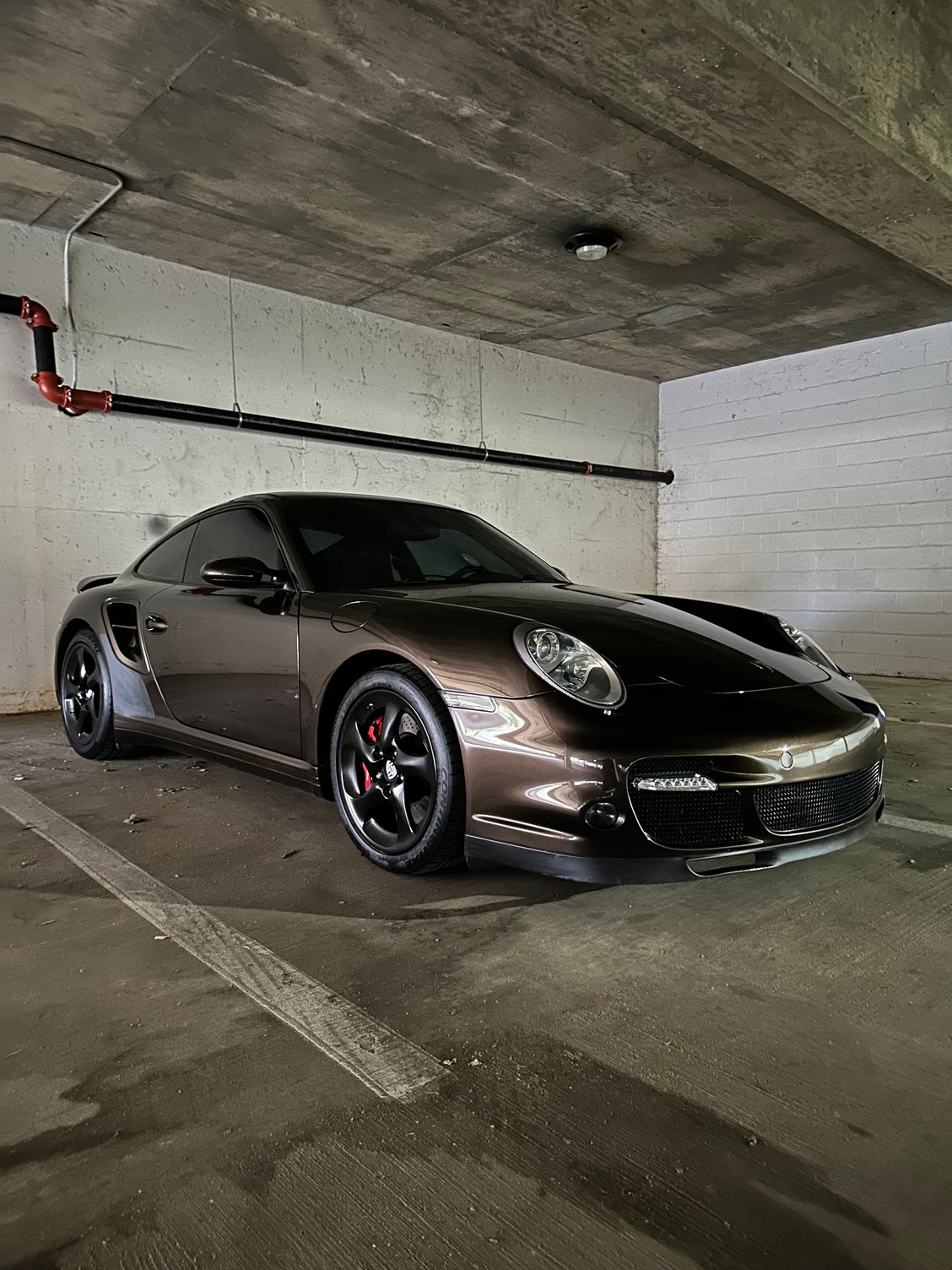

Love the color of your car & goes great with the black wheels ,but the fitment looks off with too much wheel gap imho, but as long as you like it thats all that matters.To me stanch is critical ,maybe lower it ?
Old Nov 21, 2024 | 04:19 AM
MM997TT's Avatar
Joined: Sep 2024
Posts: 10
MM997TT
Thank you!

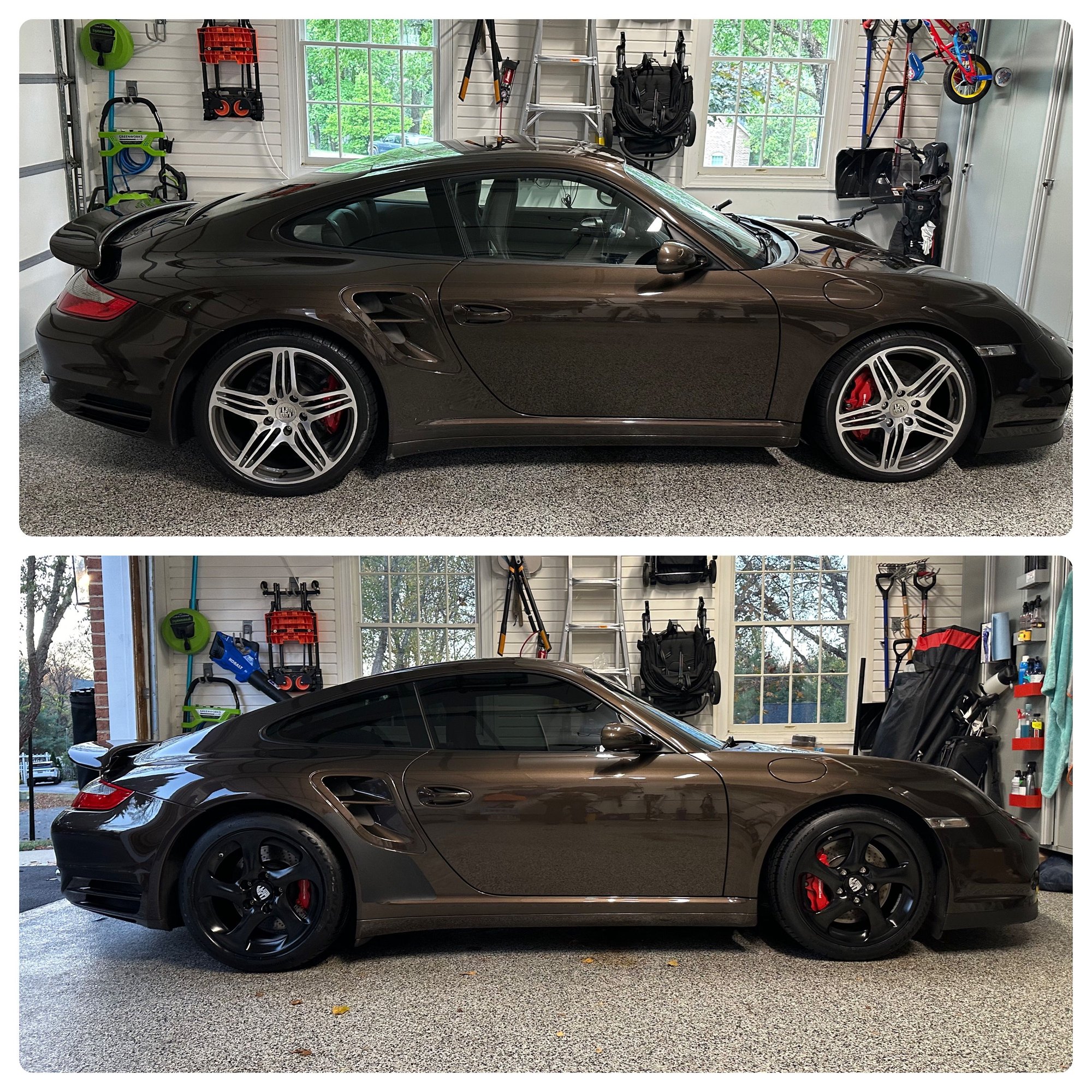

Good eye. Pics were taken right after I put the tires on and before I had a chance to drive it so suspension hadn’t had a chance to settle down yet. It settled down after the first drive and the wheel gap is now at the stock level

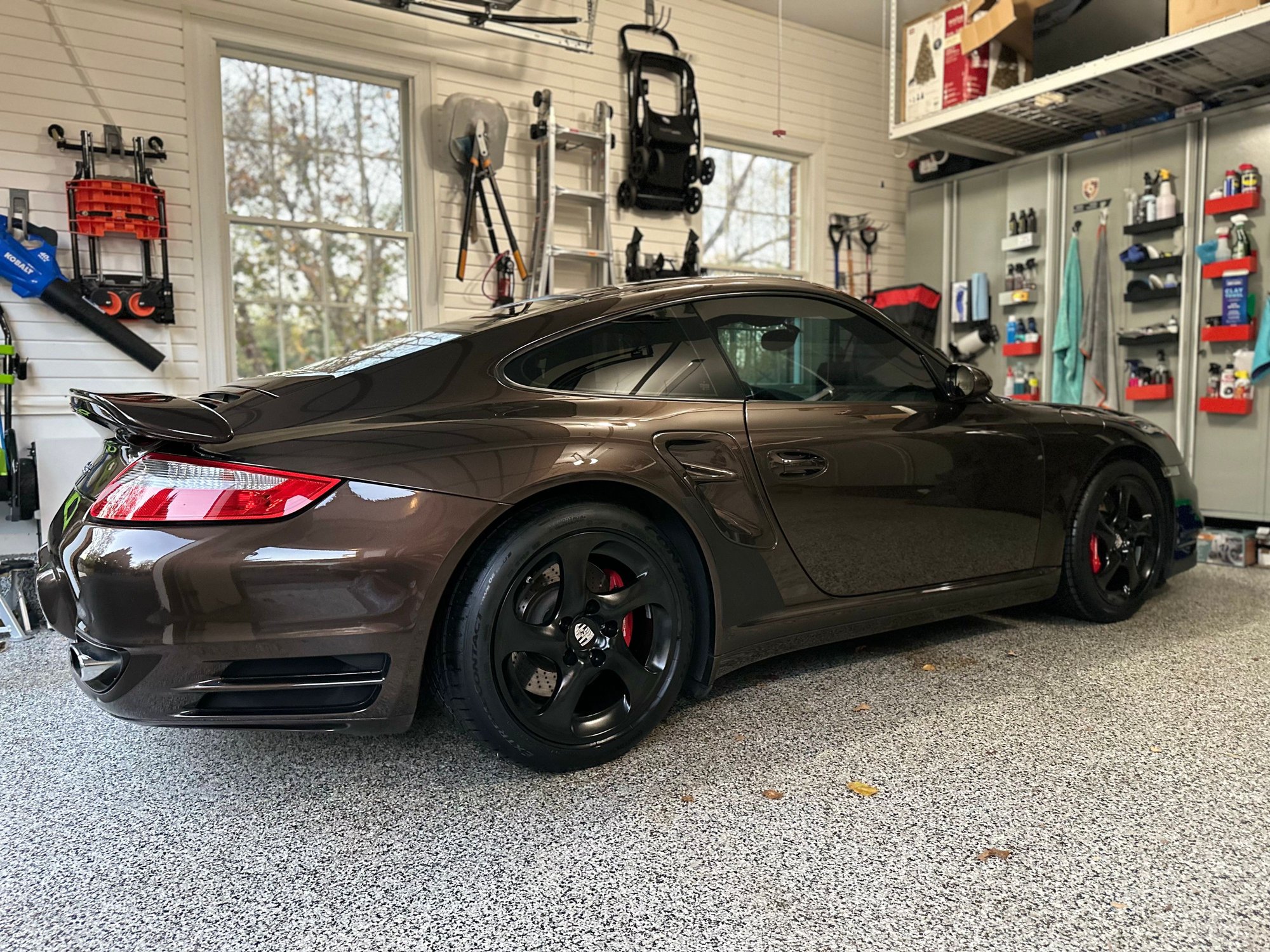

Any pics after it settled?
Old Dec 30, 2024 | 12:42 PM
MM997TT's Avatar
Joined: Sep 2024
Posts: 10
MM997TT
Maybe not as dramatic of a difference but here’s a recent pic
