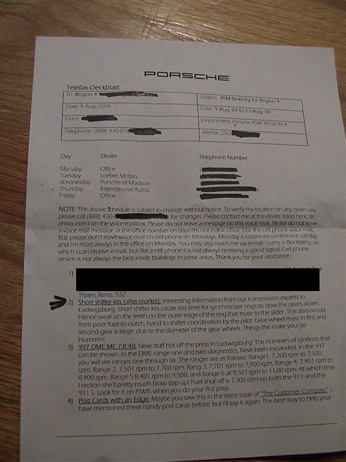

With so many cars available these days, many for great deals, I'd be weary. Your numbers tell us the car has been rev'ed to at least 8401 to 9500 RPM.
At 7000 RPM, there are 350 ignitions per second.
So, about 1.7 seconds at 7901 to 8400 RPM. This is more than just an accidental shift. With so many cars available these day, I'd walk away. While the engine may be fine, there is evidence that the car has been abused...components ie transmission, brakes, suspension, may have been subjected to excessive strain as well.
Look at it this way...if you were trading this car in for a 09, the dealer would use this as evidence that the car was abused. You should hold them to the same standard as the seller. Just my opinion.
Thats good info but where did that document come from?
LOL... except for the PORSCHE logo at the top it doesn't look very official.
I love the quote "I reckon she'll pretty much blow slap up!" LOL
Jason

From rennlist...The rev ranges have also been confirmed by Loren and others from renntech.org
http://www.renntech.org/forums/index...gnitions+error
I dont doubt it.... just a funny document.... looks like an internal dealer doc
Jason
Jason
Jason, I thought so also...good for a good chuckle
Here's the original link:
http://forums.rennlist.com/rennforum...r-bad-car.html
