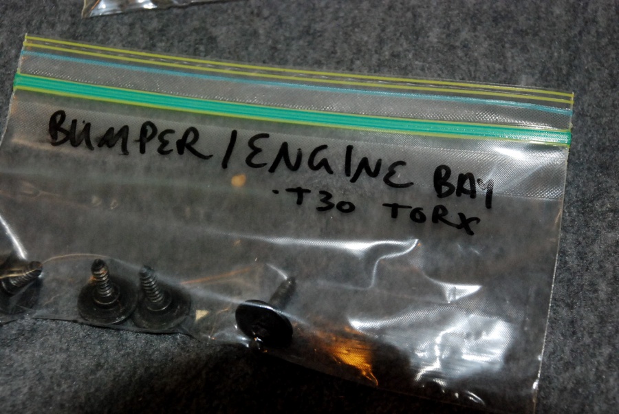

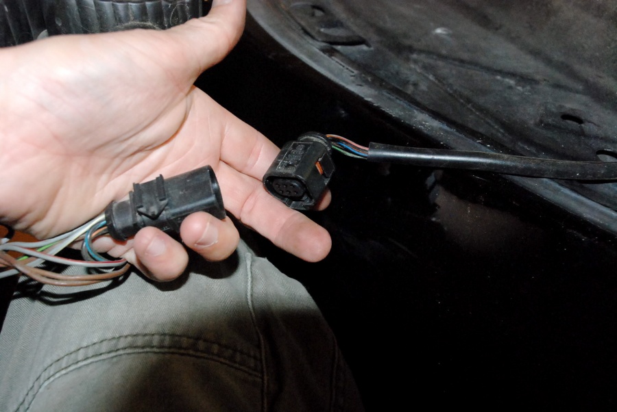

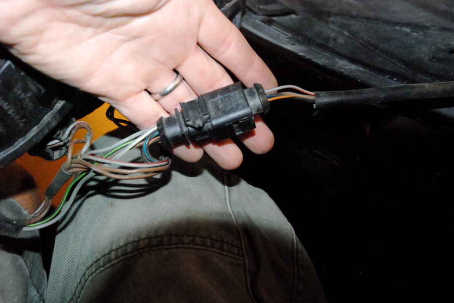

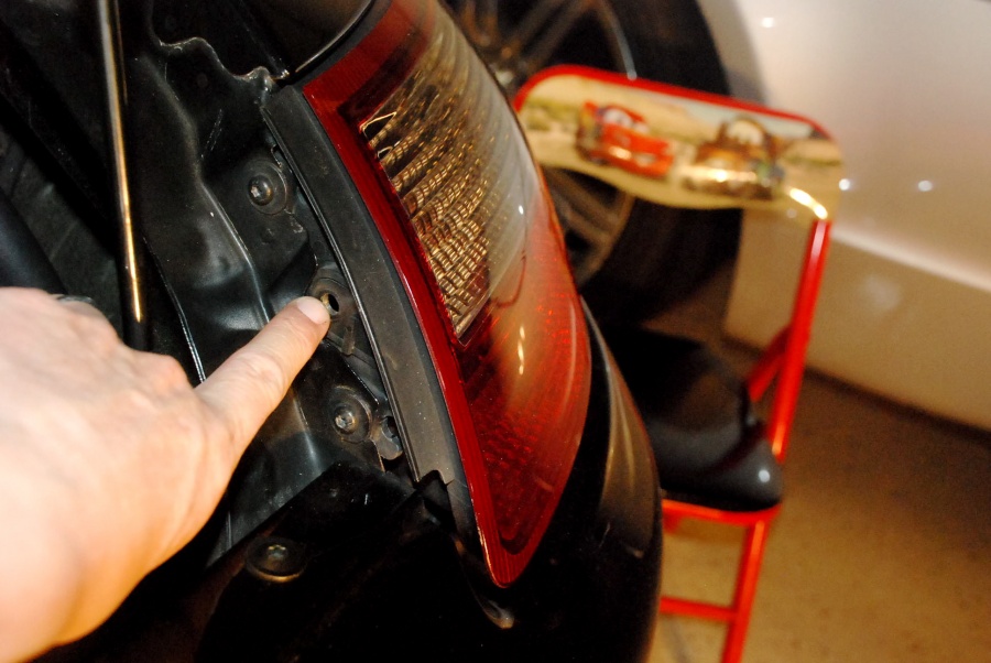

I will go out to the garage and write up a DIY guide with pics for you on this. I assume you have a jack, stands, 22m open wrench, and lots of sockets and torx bits. Most common sizes on the 997 are 10m and 13m. I find that having a couple, in different lengths, with different joints helps. I really like the socket wrenches that have a ratchet and articulated head. About $10 each at Lowe's.
In the meantime, here are some pics of the tail light harness, the screw you need to remove to take out the tail light, and the O2 sensor where it attaches inside the engine bay. There is one of these on each side of the bay, and the wires dangle down and connect to 2 spots on each cat- disconnecting them the sensors from the cats you'll need a 22m open wrench. Be careful with the sensors- try not to touch their ceramic ends.
Also, you will need an extra pair of hands when removing the rear bumper, as the fit is tight, and lining up can be tricky since you can't see both sides at once. Also, there is a wiring harness (for the license plate frame lights) that you will need an extra pair of hands to unclip.
Finally, I find that snack-sized zip-lock bags, labelled with a Sharpie, are a great way to keep removed screws, nuts, and bolts organized. This ensures you don't lose anything, and that you know which pieces go where when it's time to put everything back together.
