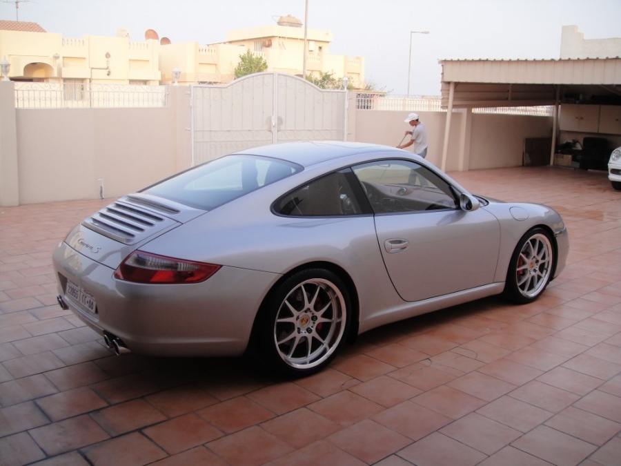

I installed 305's Nitto Invo, U can't tell the difference.
see attachments plz
I named the pictures by tires brand, the 2 from the left r pzeros, the other 2 r nittos
