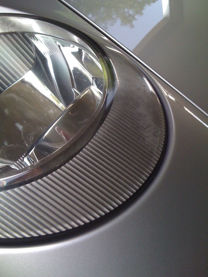

Why do the tops of my headlights look like this?
Anybody know what this is?
Looks like corrosion. It's on the exterior.
More importantly - Do you know how to clean it up?

looks like the paint buffer got a little compound into the plastic...

looks like some kind of a soap residue, in which case it should come right off. try scratching it with your nail to see if it's something that sits on top of the plastic.

Goto Mother's Car Care website. I remember seeing a video on polishing your headlights to look new again. I think you can buy a polishing ball that goes on a cordless drill and the polishing compound to work with it.

Plast-X
On some cars, you'll notice the plastic headlights housing starting to yellow. What I use on my wife's Camry is Maguiers Plast-X. It really restores our headlights however, I dont know if your issue is on the exterior or interior of the headlamps housing.

Looks like the beginning of the typical headlight corrosion and "yellowing" that we see very often down here in Florida. A good headlight polish should take care of it. Give a shout to Phil at DetailersDomain. He set me up with a product a while back, I just can't remember what it was.
Usually this happens because most people wash and wax their cars, but very few people ever put any kind of wax or protectant on their headlights. The plastic eventually discolors after time.
