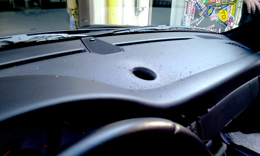

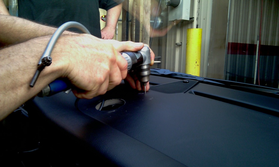

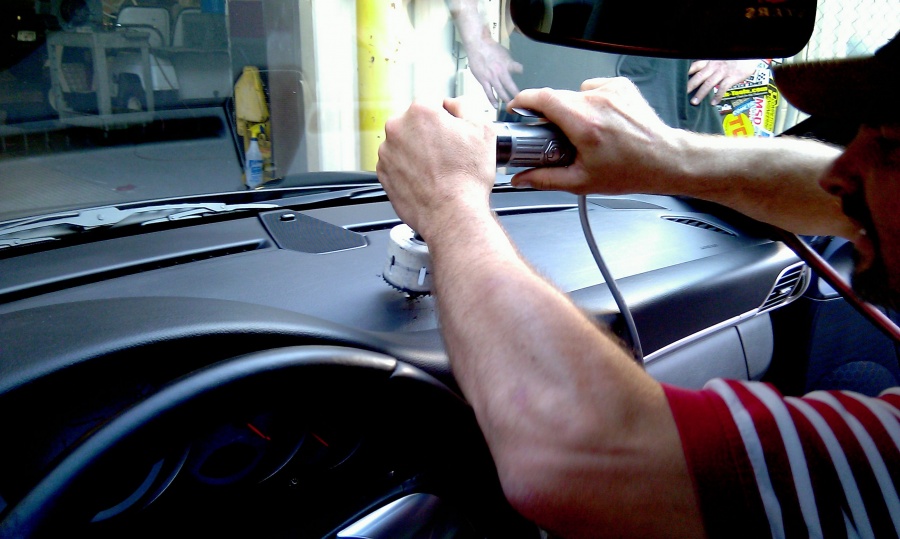

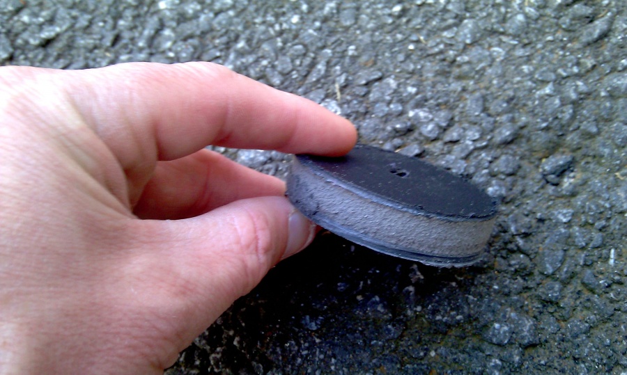

The steps were:
-Cutting a hole in the dashboard (said a prayer first!) with a round saw blade on a 90 degree drill, to get through the vinyl, foam, and innter plastic layers. Overall it's about 5/8 of an inch thick.
-Cut 4 slits in the dash, into which I inserted the "legs" of the pod.
-Some minor trimming on the edges of the round cutout to make a perfectly tight fit, since the lower side of the pod is not perfectly round, it's an odd shape.
-Securing the legs of the unit to the underside of the dash was the fun part! I wanted a factory fit, so it had to be tight as a drum with no gaps anywhere. Since the dash is not totally flat, this required some ingenuity. You will note that no glue, or adhesive of any kind was needed.

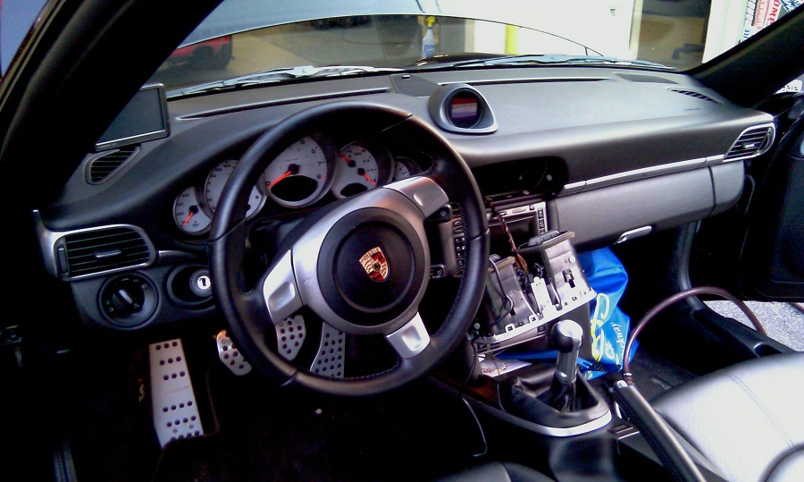

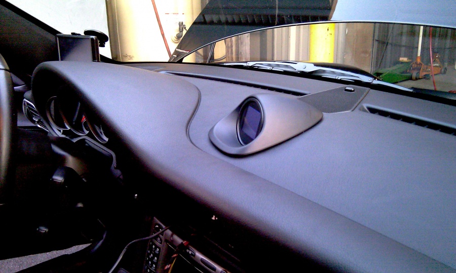

I have some further final pics when it's all back together again, but here are some highlights:
-The OEM unit is placed facing straight, and the gauge has a rotating bezel in it. Since I have a custom 60mm OLED multi-gauge, I wouldn't be able to use a rotating bezel, so I decided to angle the pod toward me, the driver. I really like how it looks, it's more driver-centric, as it should be.
-This PLX multi-gauge is OLED, so I can customize the look of it, and have it match the OEM dash gauges perfectly, which would in my car, a white background, black units, and a red needle. I can make it any look, color, style, I want. I can have it look like a round gauge, or a graph (with multiple metrics), a simple digital readout for up to 6 metrics at any given time.
I will post more pics shortly, including perhaps a video of the gauge in action. BTW, I can also log data from through this wirelessly via a module and an app for the iPhone. So I can log any OBDII data (like I would with my Durametric logging software) as well as the new modules installed for AFR and Boost. I may likely also install control units for air intake temp both before and after the intercooler. These units are all daisy-chained off of the primary PLX module.
