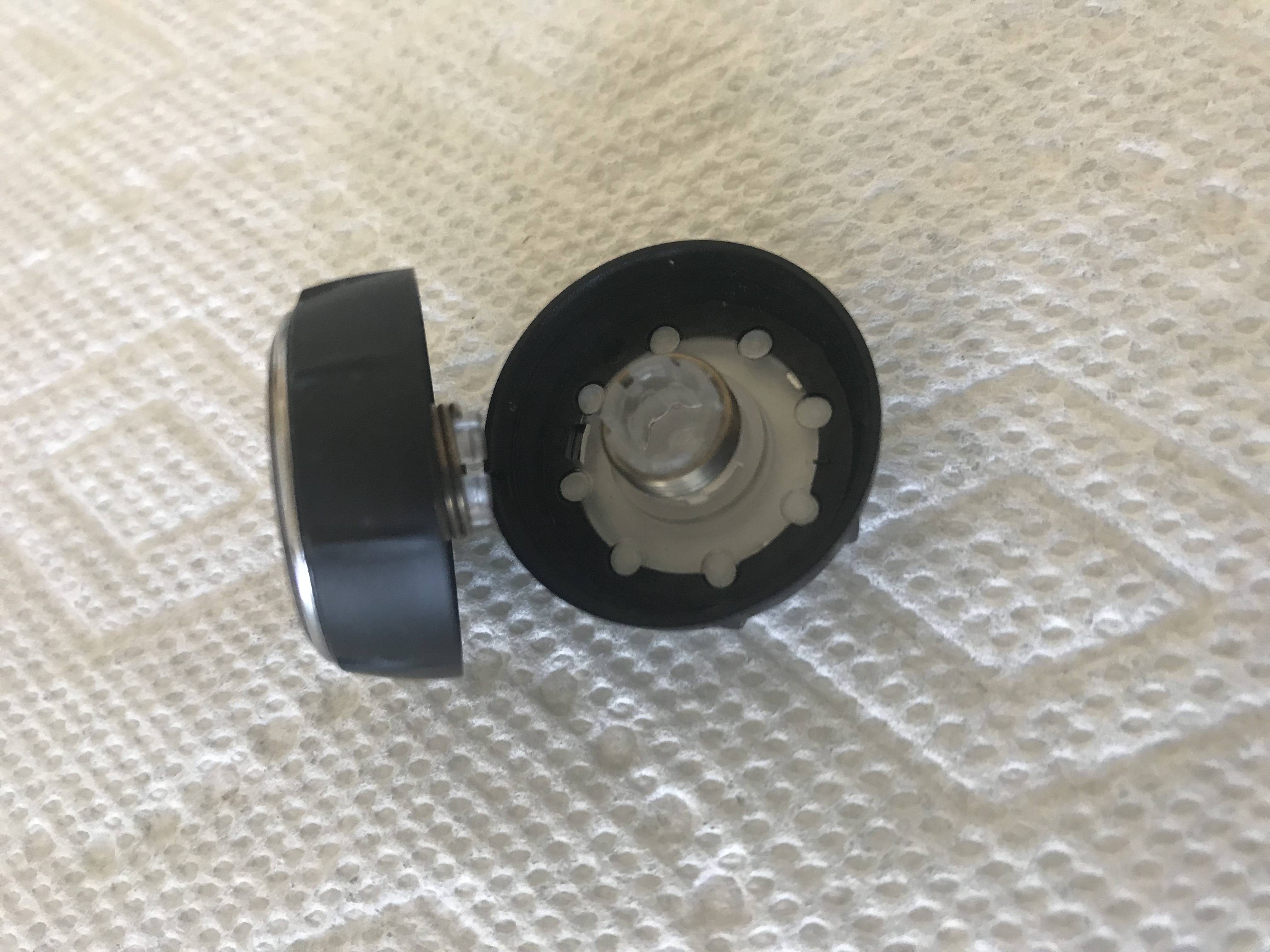

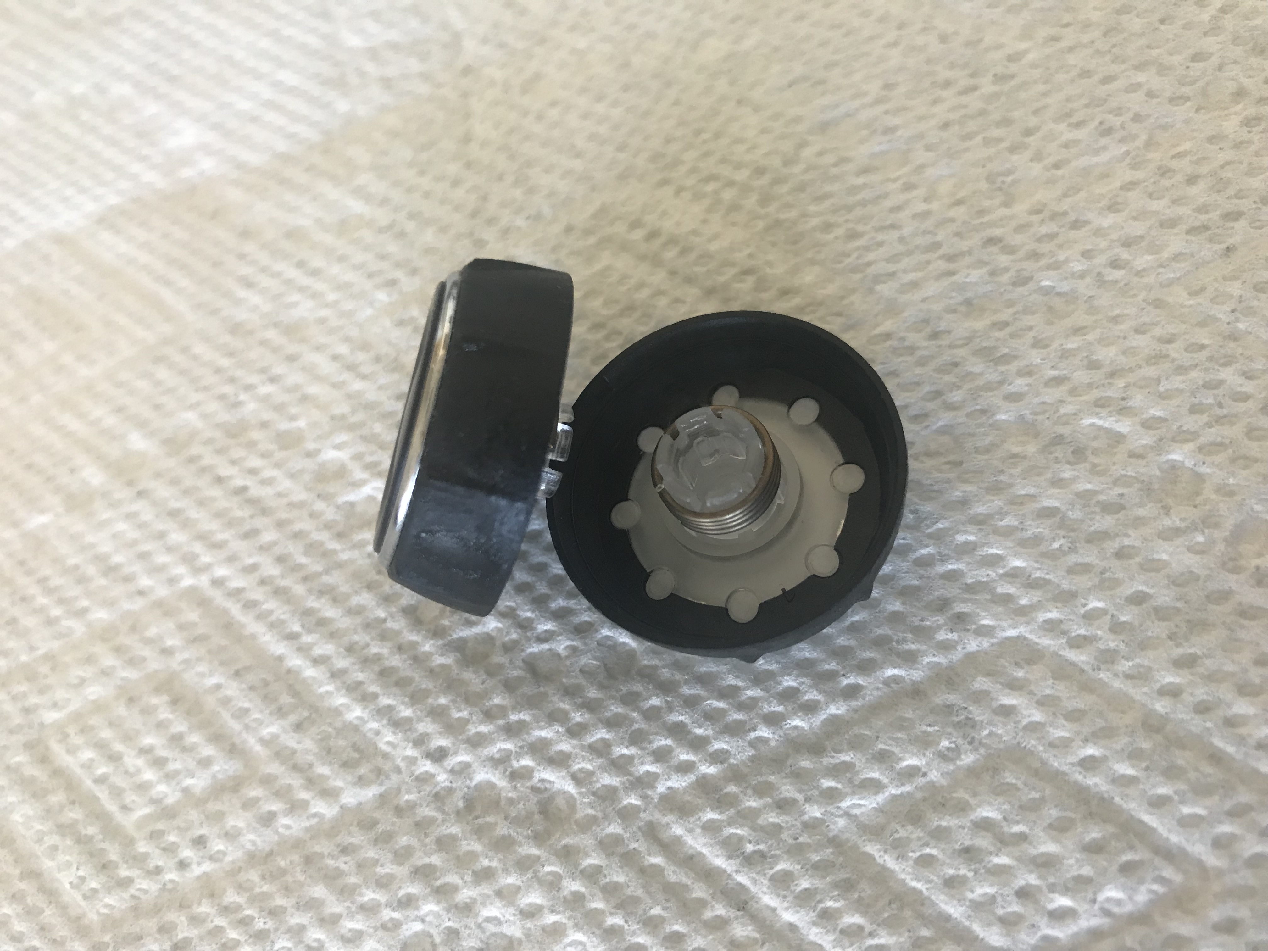

have same issue. this is so common it should be a "sticky" thread
removed mine using two of those metal credit cards, one on each side. they popped off
the 958 I have uses springs to hold them as shown below
cleaned up like new with alcohol. damn sticky stuff. maybe I have to wash my hands more often?
before and after pics

So I cleaned the buttons and figured this would be a simple job. The right button however when I snap it on it doesn't catch. The back of the button itself looks fine and nothing was broken in removal. I played with the spring around the plastic grips in the back of the button to sit higher and lower to see if it would catch this metal **** but then looking at the **** underneath it's so smooth I'm wondering how it would catch. Did anyone else encounter this issue?
The left volume button had no problem. Annoying!!!
