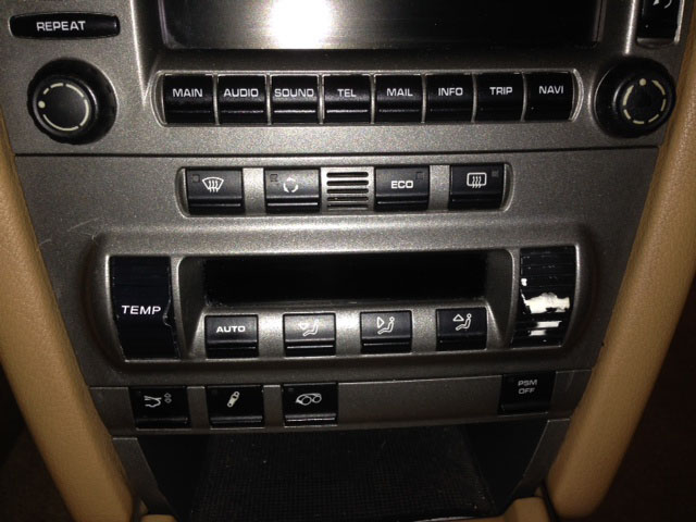

Worn fan switch - repaint? replace?
My new-to-me '05 is near perfect (just 35k mi.) except for some fairly inexplicable wear on the fan control. Is this a common wear point? Can it be touched-up, or must I get a new rocker? If I do replace, will it wear again like this? The temp control is showing a little of the same, so...? Is this a common high-wear item? My Audi at 10yrs and 200k miles doesn't show anything like this except for maybe the top of the shifter ****.

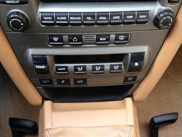

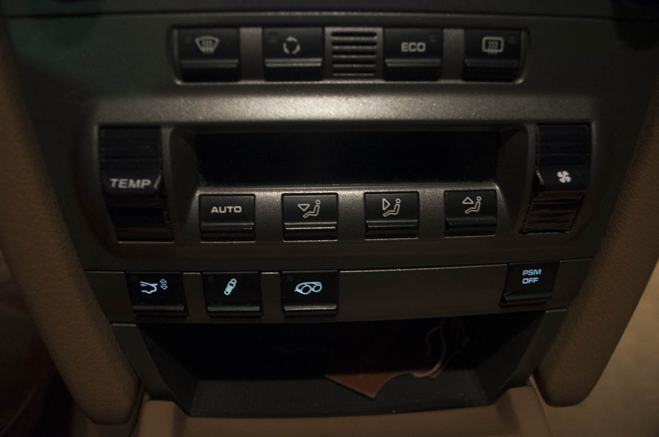

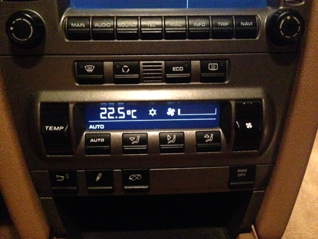

I recently found a solution for this issue. Itīs called ClimaRepair, itīs a complete kit, takes 10 minutes and you can do it yourself. Itīs sold at climarepair.com
Have a picture of my car with the kit installed (before and after):
cheers!

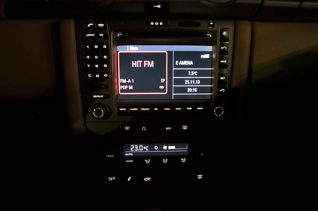

And at night (just took them)
Lights on
Lights off
