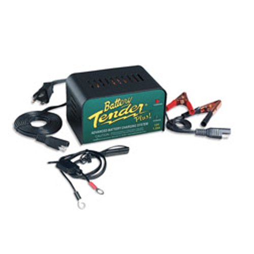

While we're at it... which battery maintainers are you folks using?
Porsche OEM
or
CTek 3300
or
Deltran Battery Tender Plus
I have a brand new Porsche Tequipment Maintainer. I haven't used it yet, but my battery isn't holding a charge anymore, so I figured I'd plug it in from day 1 on the new battery, I only drive the car once every couple of weeks this time of year.
Anyone, so if I plug the maintainer into the cigarette lighter before I change the battery, I wind up with no fault codes or anything right? ...and this is safe?
Old Feb 4, 2011 | 09:45 PM
adias's Avatar
Joined: Sep 2004
Posts: 2,363
From: SF Bay Area, CA
Rep Power: 170
adias Is a GOD !adias Is a GOD !adias Is a GOD !adias Is a GOD !adias Is a GOD !adias Is a GOD !adias Is a GOD !adias Is a GOD !adias Is a GOD !adias Is a GOD !adias Is a GOD !
Originally Posted by zeplow
... Anyone, so if I plug the maintainer into the cigarette lighter before I change the battery, I wind up with no fault codes or anything right? ...and this is safe?
Correct!

Before I replace OEM Porsche battery with Walmart MAXX 94R ($90.00) I pluged my Deltran Battery Tender (keep it on my motocycle battery) into center console armrest lighter plug. Swapped out old for new & all was good to go with no fault codes!
