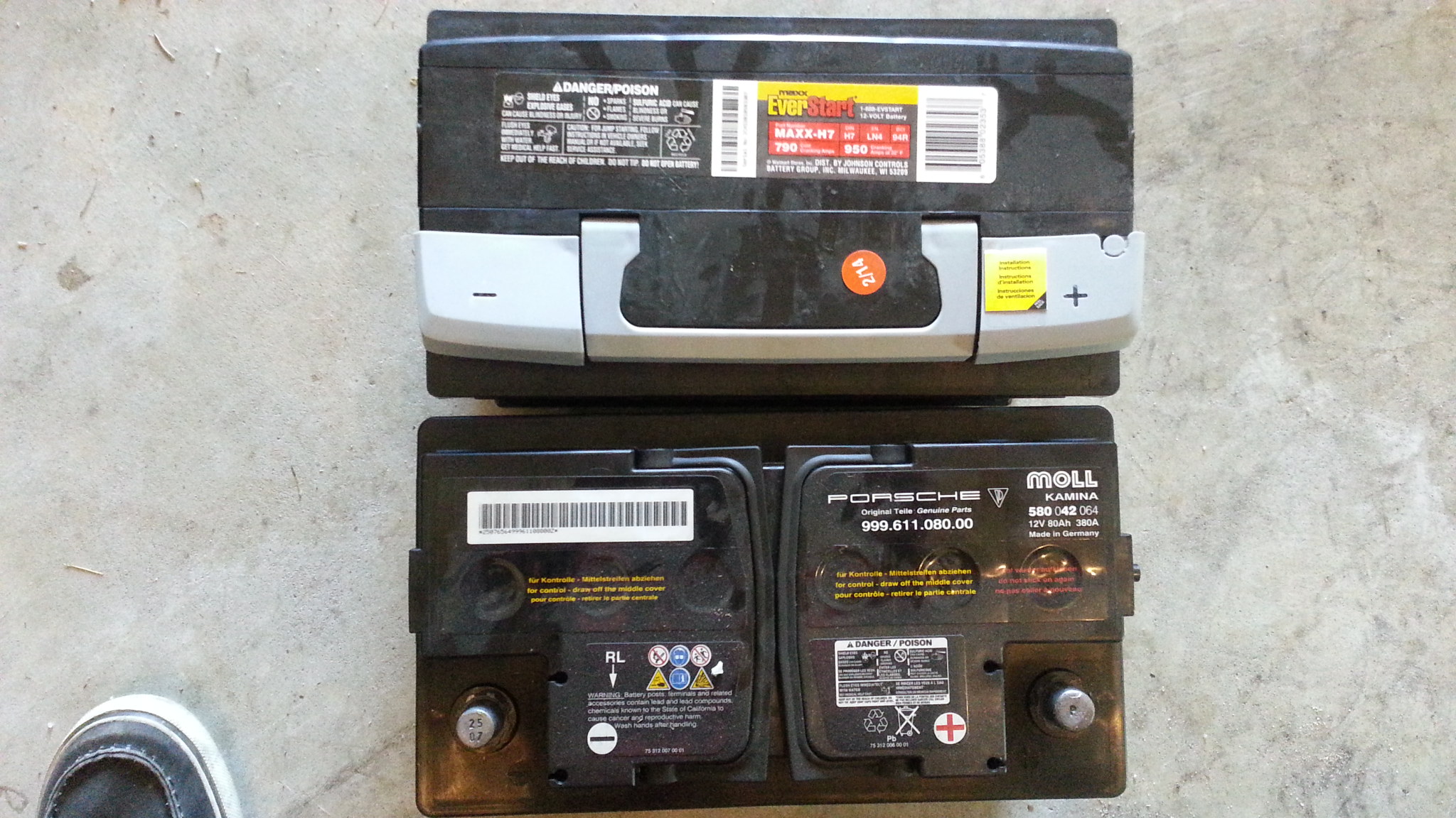

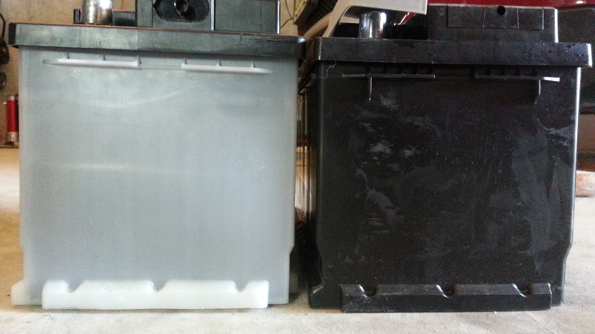

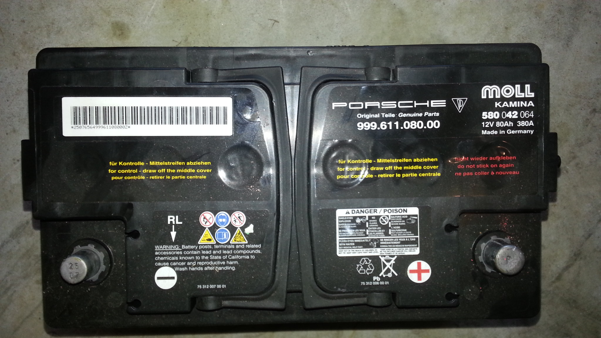

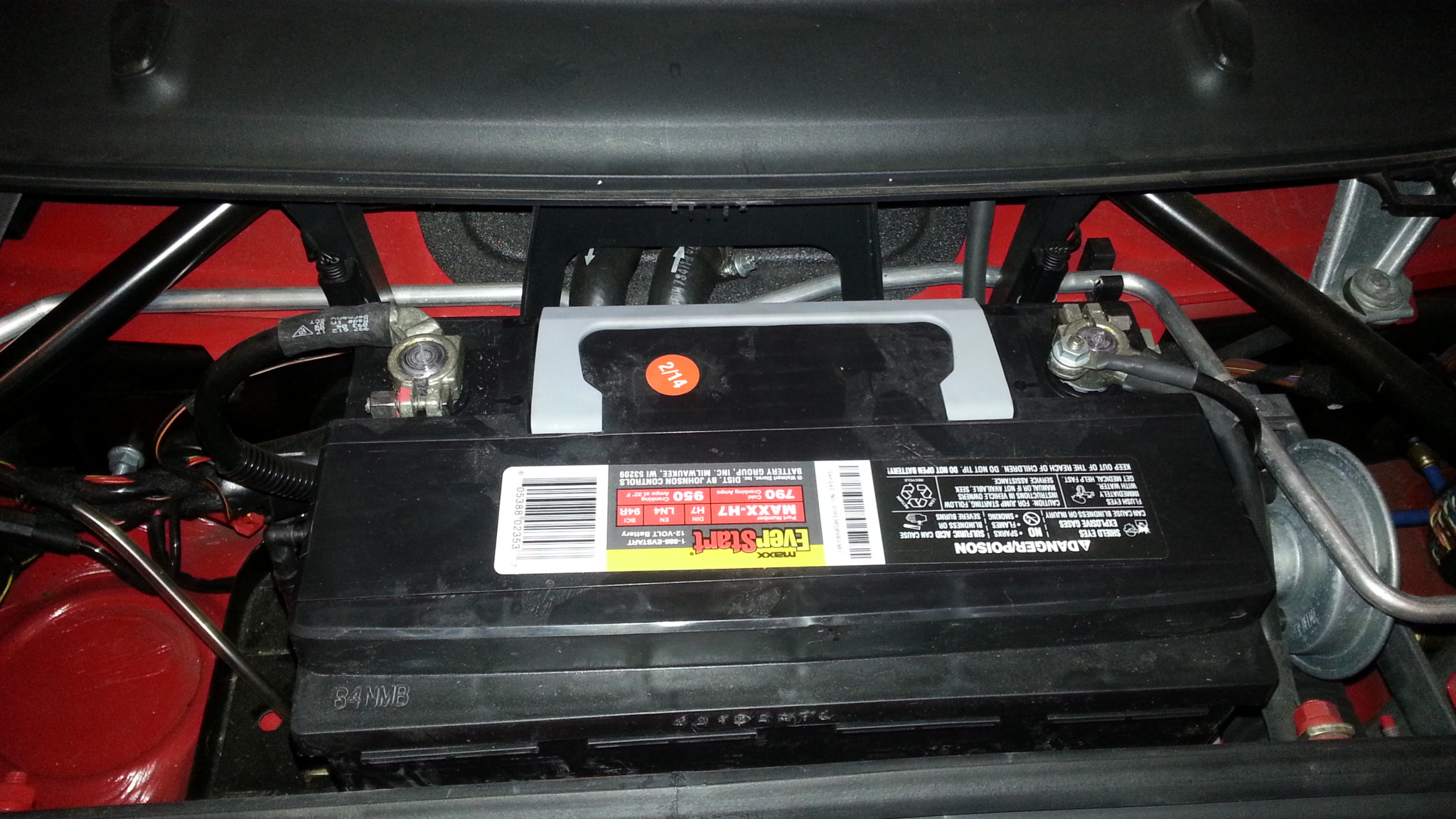

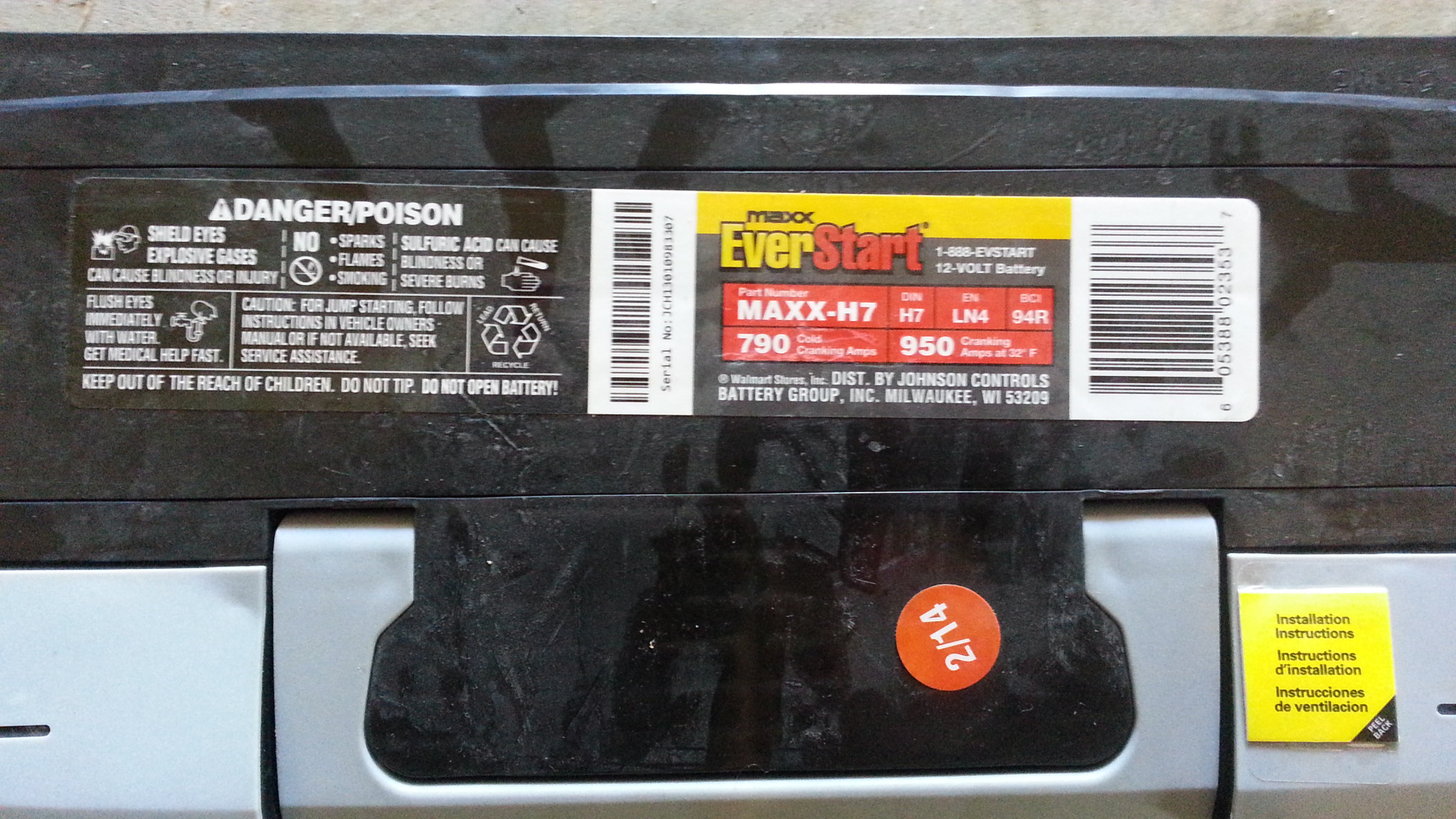

Replace Battery 997
Just Replaced The Battery on my 911 997 : Used Walmart EverStart Maxx H7 $146 + $9.00 Battery Core fee
Product ID : H7 or LN4 or 94R .. Took Me 5 mins to swap out old battery .. Put In new One.. also the Vent Tube Fit Perfectly .. Cheers...
My Battery Was Dead.. Used the New Battery to Power the Car just to open the Front Hood.. attached Battery Cables to Driver Side Fuse Box ..Used These instructions --> http://perryandcoblog.com/2009/11/17/porsche-carrera-911-996-dead-battery-locked-hood-solution/
I Used the new Battery Instead of the Battery Charger... Opend the Hood Using the Key FOB..
