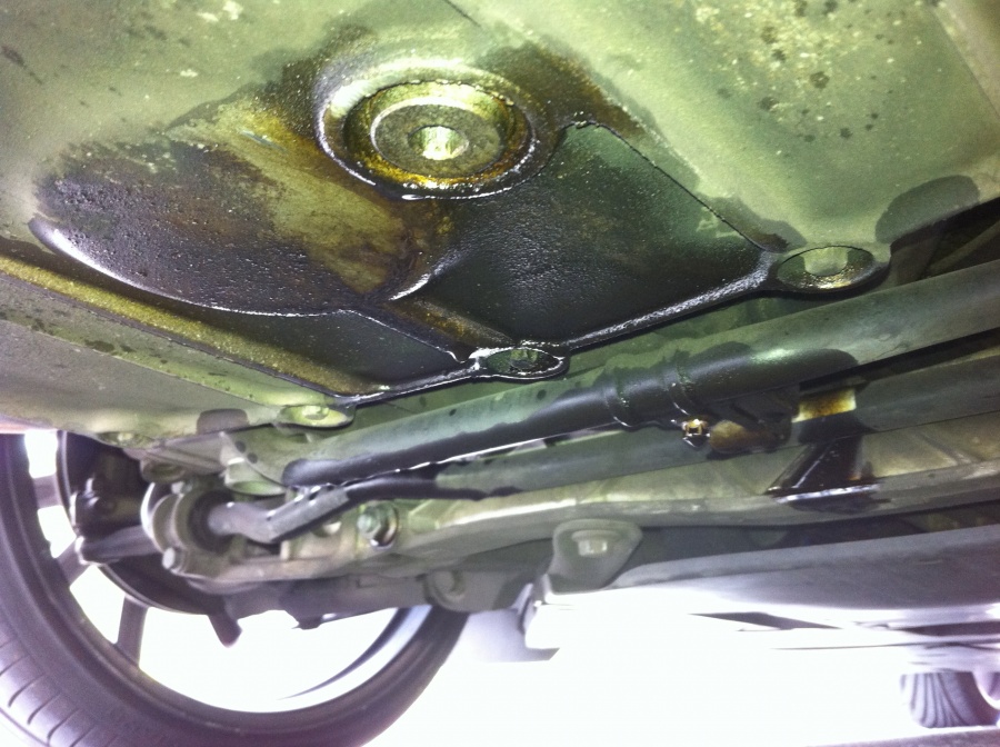

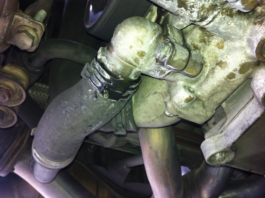

So I'm turning off a highway off ramp and I start to lose power. A few rpm hesitations and I look in my rear view mirror and white smoke is billowing out.
Right then the check engine light cones on as o drop the car in neutral and coAst to a stop. Hear a little clunk.
I peek under the car and there's an oil puddle and oil coating my mufflers and coolant slowly dripping down.
Car is now at Newport porsche.
Initial diagnostic is that it's the oil/ water separator? Possibly the intermediate shaft. Won't know until Monday.
Any thoughts?
Tia
Marc

Hmmm, since coolant is involved I highly doubt it is the IMS... probably more likely the AOS (Air Oil Separator) since both oil and coolant go through it. I hope that ends up being your issue since it is not too bad a fix.
David
