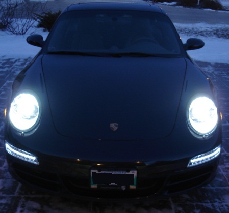

Old Dec 16, 2011 | 09:46 AM
  #102
Doug_B_928's Avatar
Joined: Aug 2011
Posts: 28
From: Winnipeg, Canada
Rep Power: 16
Doug_B_928 is infamous around these parts
Originally Posted by sideWays_swe
Check that the lights are properly connected. It could be that the wires are loose. I have a 08 GT3 and have no error codes. Though i dont drive it right know because of winter,but i had it idle for a long time a no errors.
Same here, had it idling and moving between spaces in my garage for about an hour with no codes from the DRLs.
BTW, the HIDs from RoTtec are a great match to the DRLs.
