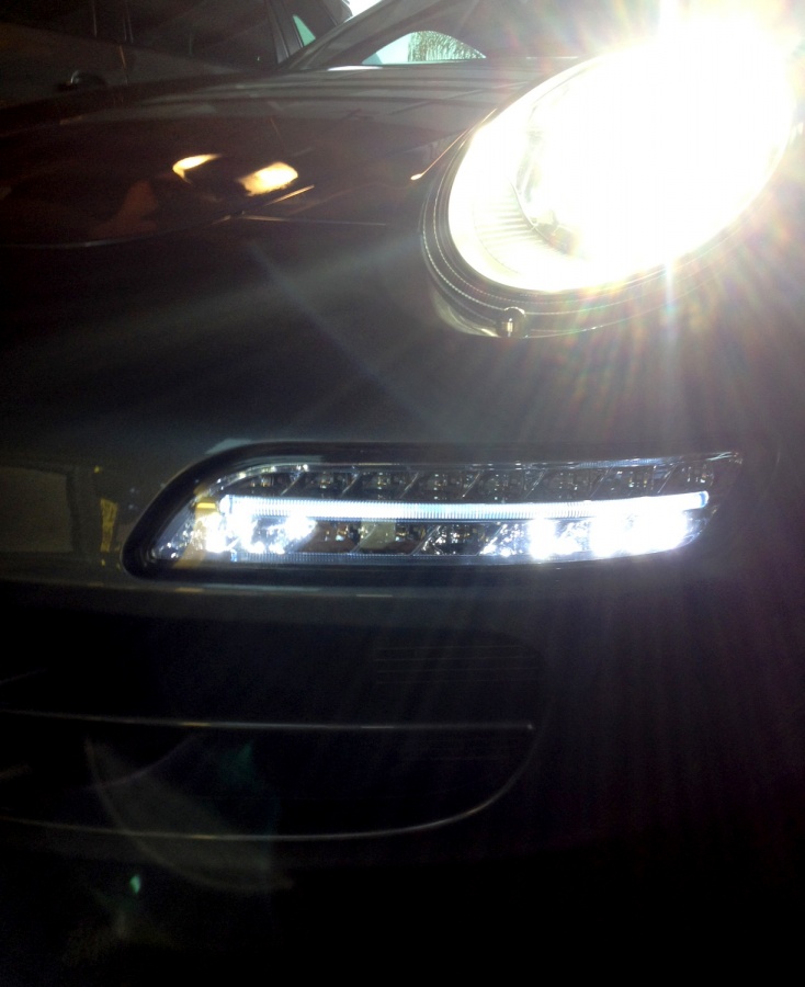

Please understand my responds will be slower in weekend. Just a quick update for the fix. We have added a load resistor to fix the check front light issue and I'm waiting from factory to confirm when we can have the resistors. We're going to use a plug in type resistors, so there will be no cutting wire, tapping etc.
Member Toffee DRL has different issue. After our suggest testing and we confirmed it was due to defected unit. That's why we sent him replacement immediately.
I will email everyone who report with the warning issue tomorrow when I back to office.

Originally Posted by BSB911TT
I am surprised you received a replacement so quickly? I am still waiting to here back from Ray to replace my faulty Driver Side DRL. Picture attached. He emailed me 4 days ago about contacting the factory and filling a warranty claim but that was it. He said once it was "approved" he would send a replacement. I have not heard anything since Dec 14th.
Since their office close on Sat and Sun. I should have answer from factory by tomorrow.

Hi Guys,
Have to say the pics look great. I just received mine from CarGym in Hong Kong. Price was a liitle better than others I have seen around and photos look identical.
I'm a little nervous as I'm hoping that it all goes well, I have also ordered the TFLM03 module from Germany. has anyone used this?? does it just connect with the wire from the foglight (splice the positive wire)? seems too easy. To my knowledge and please correct me if I'm wrong but it senses a voltage drop on start up so sends power to the DRL but once the Lights are On how does it sense that and switch off the DRL??
want to try and get this worked out before attempting to install them
Thanks to everyone for going into detail on the installation.

Originally Posted by marconi72
Hi Guys,
The module has 2 wires to each front fog light, one wire to one of the parking lights, and a positive and negative wire to the battery. I mounted mine in the nav unit area and ran the wires behind carpeting etc to light assemblies, and ran the battery wires through the rubber grommet to the battery chamber. To do it nicely you'll likely want to allow yourself 2 or 3 hours.

Ray is sending out a resistor after he receives them in a week or so. He thinks the problem is isolated to early '05 and '07 cars.

Edgy01 from Rennlist has an 06 and he initially didn't have any codes, but then after a long drive got errors. He wrote:
"I drove up to Sacramento today and decided to give them a workout. I ran my 997.1 car with DRL on, and found after about 100 miles that I got several "check front right light" warnings. I attempted to troubleshoot things as I drove. First, I turned off the DRL function when on a break and then selectively turned things on at dusk. I started with the running lights and the 'fogs' on (no headlights) so that I could see if they were working when I trailed a nice reflecting vehicle. Despite the occasional warnings the lights never faltered--the running lights, the fogs, nor turns. So, it is apparent that something in the voltage department is generating enough of a voltage issue to throw a code. Temp was around 50ºF and elevation 0-800 ft. Clear, no rain (moisture). I am pleased that they appear to work well, but the occasional code alert can become a pain and a distraction. Sometimes I found that I would get a red exclamation point--but no narrative code--and then the exclamation point will disappear on its own."
