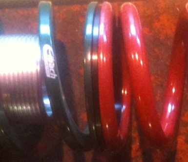

there are 2 possible issues with springs installs.
first one is about proper spring hat used - search for it.
second is a kind of a trick - get a piece of black electrical tape and wrap it around coils where tender spring connects to primary spring and a spacer between them. after those 2 are bind together they will stp clanking at small bumps.

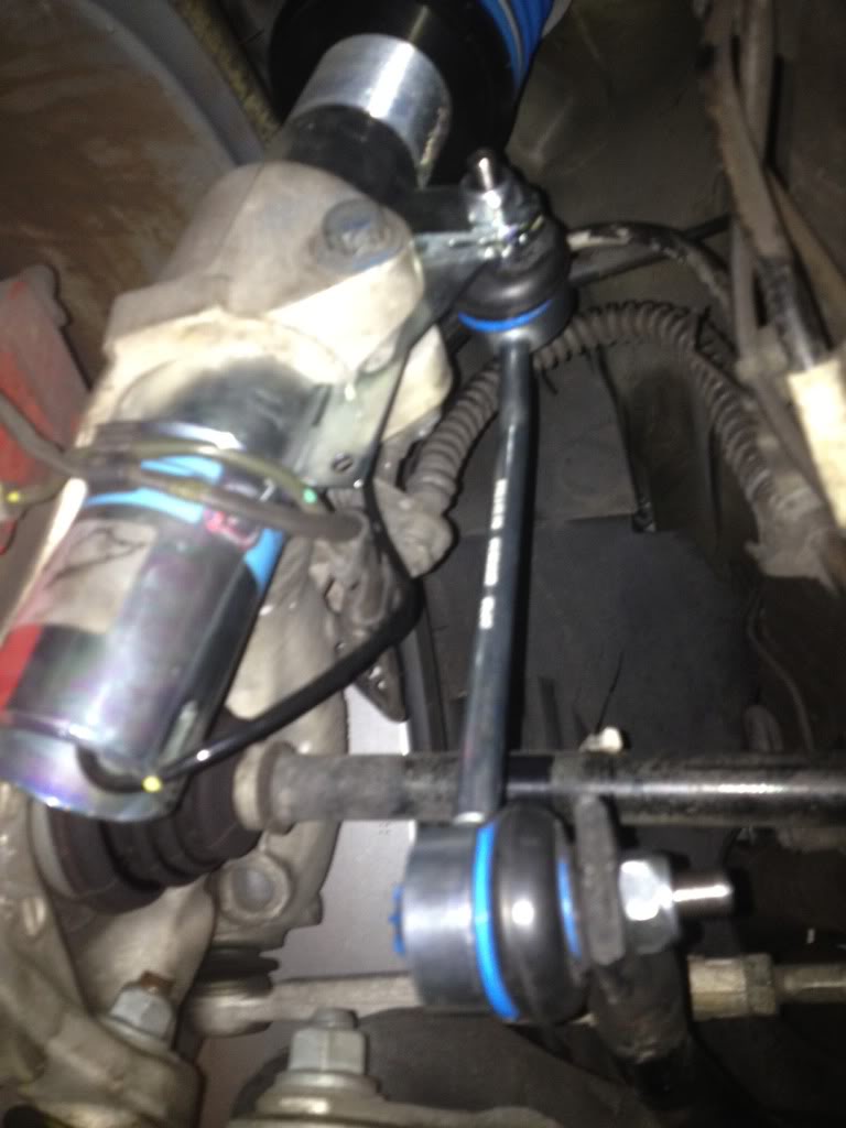

I lived with this problem for a long time and essentially tried everything including new strut bearings, nylotron washers, adjusting ride height etc. I was told my my installer that it was "normal". Then I had a terminal coilover failure. The culprit were incorrectly installed droplinks. Which BTW, Bilstein claimed was the cause of excessive noise, ie binding of the springs when entering and exiting driveways. Long story short, I replaced the drops and coilover and had the droplinks installed per Bilstein recommendations. And voila, no more noise. I had a thread about this on the Turbo thread which got pretty nasty but it's informative.
I had them installed incorrectly by a very reputable installer in Los Angeles. I had to have the drops switched out at another shop in Orange county which has there own race team so I assume they know what they are doing. I had to specifically tell them the configuration of the drop links otherwise they would have done them incorrectly too.
Here's the correct installation per Bilstein. This is the drivers side looking forward.
