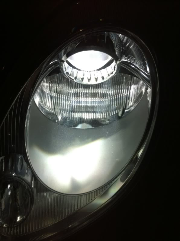

There is a thread on Planet 9 with all the info you need. I did it on my Cayman s and it worked great, actually some of my pics are in the thread/tutorial.
Stick with 5000K or they'll be a little too blue. The Retrofit Source is a good place to buy a good quality kit. If you get something off of Ebay it's a crap shoot.
Old Jun 7, 2012 | 03:36 PM
Boosted Josh's Avatar
Posts: 206
From: Alabama
Boosted Josh is infamous around these parts

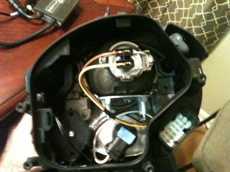

Back of OEM halogen housing:

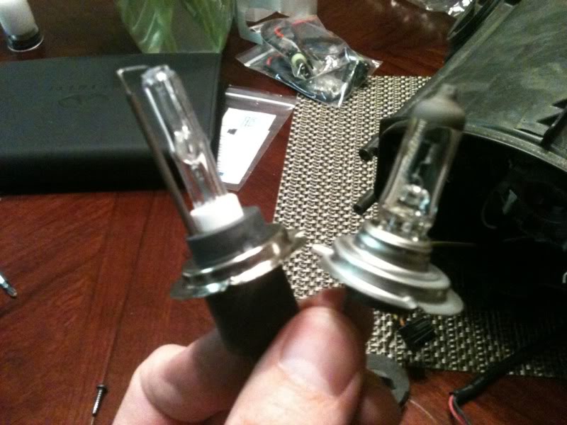

Halogen vs HID bulb:

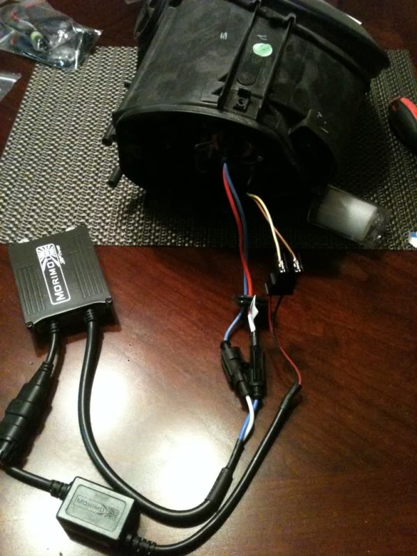

Wired up:
Halogen vs HID:
Close up with HID:
Cutoff:
On the road:

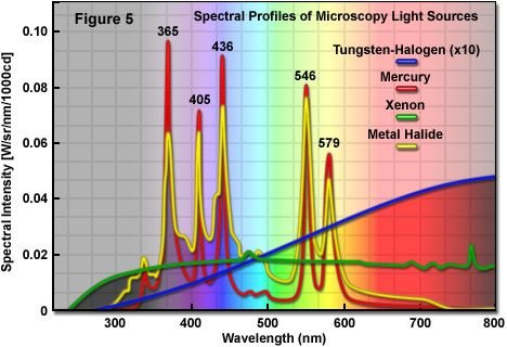

Has anyone done it the other way around? Upgrade from Xenon to halogen?
I realize the Xenon's look cool, and I'd have to give up the Litronics ( nearly useless anyway) .. but I really need better light at night,.. and the red color range makes it easier to see things at a far distance at night.
Those of you that spend time on the water know what I'm talking about. You see the red light on the red buoy at 3 miles distance,.. but have to be within 1/2 mile or so to see the green buoy next to it.
I.E. I want the blue line in the graph below,.. not the green one.

You can purchase HID bulbs in different color temperatures. The OE bulbs are 4,300K, which mimics natural sunlight when projected from your headlight. I agree that the whiter and bluer lights reduce visibility. Have you considered an HID bulb in a 3,200K color?
