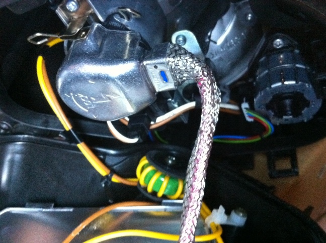

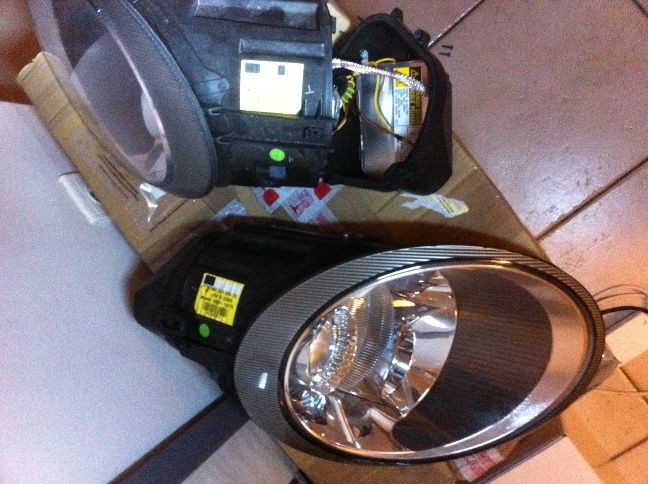

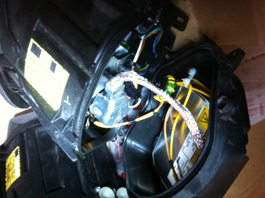

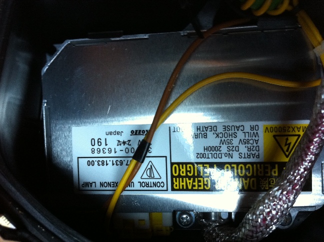

Can anyone tell if these are real/original HID bi-xenon headlights or HID retrofitted halogen units?
Thanks

The part number is Porsche however, I find it near impossible to believe that Porsche installs headlights made in Japan with a label written in English. I would remove mine to compare the label.........but I'm not going to. I say nope.

It's is quite possible and plausible that the electronic headlights are sourced from Japan as is the car's transmission. Surprised? IFRC, English is the official language of the EU so it would make sense to label things in English. Ever found anything on your car labelled in German? You need to travel a bit farther from home.

These look like, from the front, standard xenon lights that come on the C2 997.2. That is, the primary light is xenon, the high-beam is halogen.
I believe the S models come with dual xenon projectors.
I say that because they look identical from the front to those on my 09 C2.

From the pictures you posted. They look OEM. Halogen Units have different wiring system and connectors. A good way to check is when you start your car, make sure the headlights are on and facing a wall, the Xenon should move down and up to do a auto leveling check.
