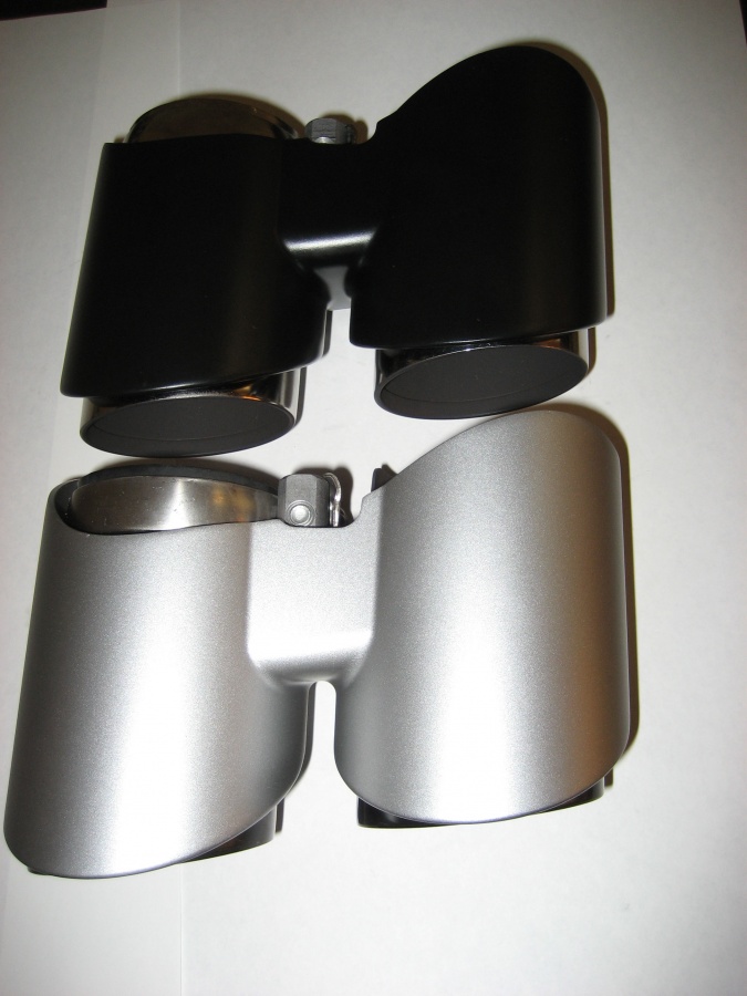

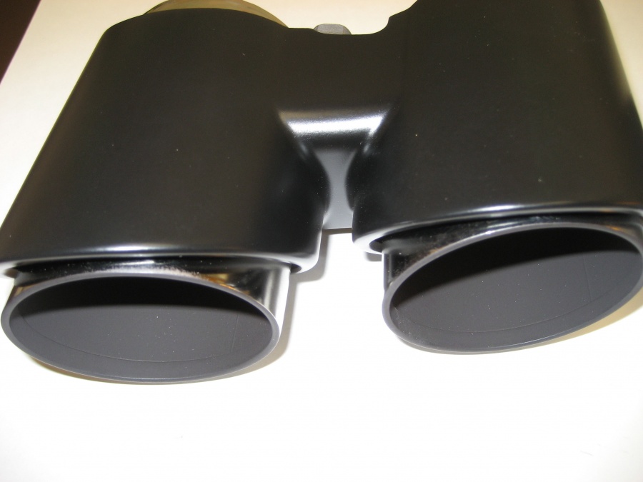

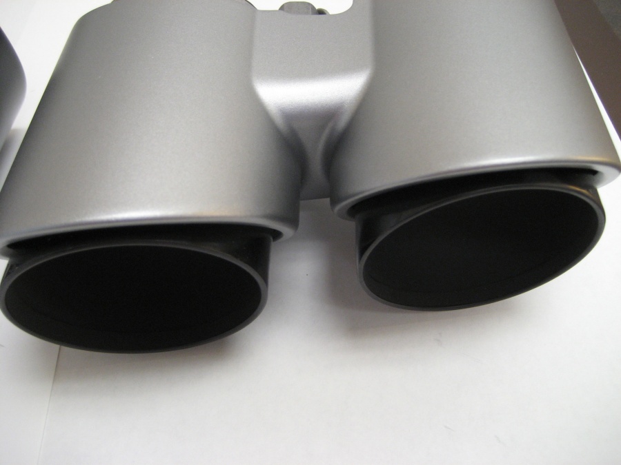

These are the two types of OEM Porsche exhaust tips that will fit .2 PSE systems.
The black (black painted outer diameter/polished stainless steel inner diameter) tips are from and come standard on GTS 997.2 cars.
The silver (silver outer diameter black inner diameter painted) ones come standard on 997.2 PSE cars.
Both are interchangeable with each other as they are mechanically identical except for the paint/surface finish.
The rear of each tip has tow (2) pipe inlets to accommodate the twin PSE pipes. One of those two rear (inlets) has a clamping mechanism for holding the tips onto the actual PSE tubes.
I hope this helps you out.
