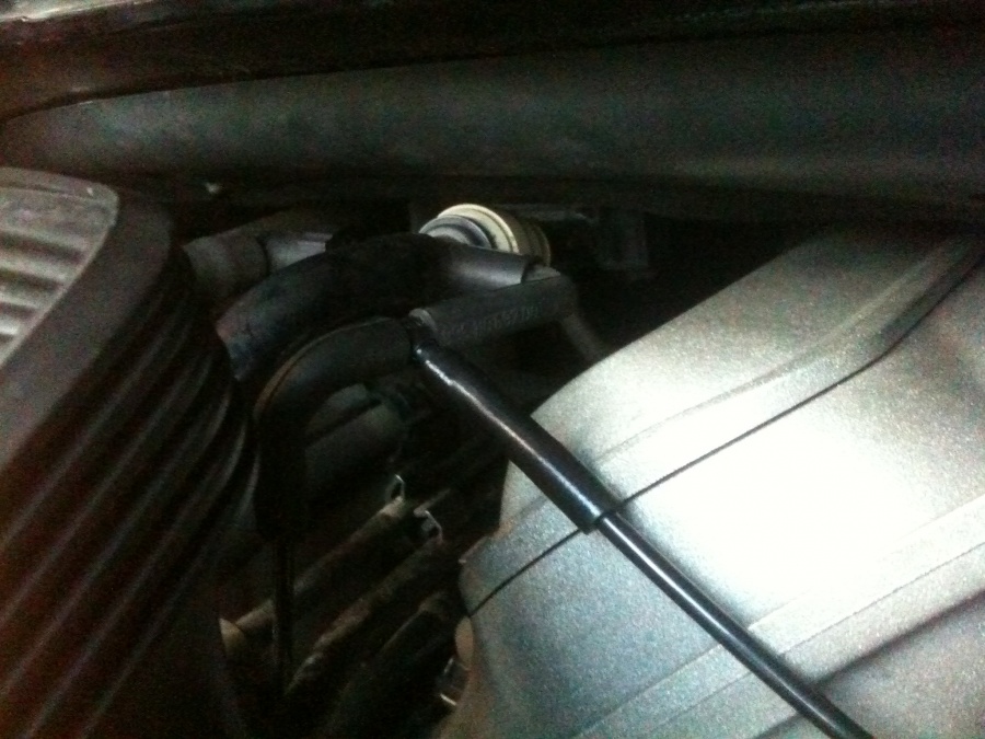

The valve is on the right of the engine with a brown plug on the top.
The main vacuum line runs from the valve to the main brake servo vacuum line on the left side of the engine. it will be connected using a rubber Y connector if it's gen PSE. Mine is a bit different as it's a self install.
The Y connector on the valve has the lines that run down to the silencers.
To check the wiring, remove the plug and connect the live and earth to the correct sides of a multimeter. Then have someone activate the switch to see if you are getting +12v switched to 0V
You'll just have to visually inspect the lines for splits or cracks.
If you want to check the silencer valves, I'm sure they can be accessed from under the rear bumper. When the car is cold, check that there is full movement by moving the connecting rod in and out.
Pics to follow.................

Hope the pics help.

Ok the hoses appear to be on the ones connected to the plug. How else should I test the vacuum lines? Any help would be great. This all happened when I was driving with the pse on then got quiet
