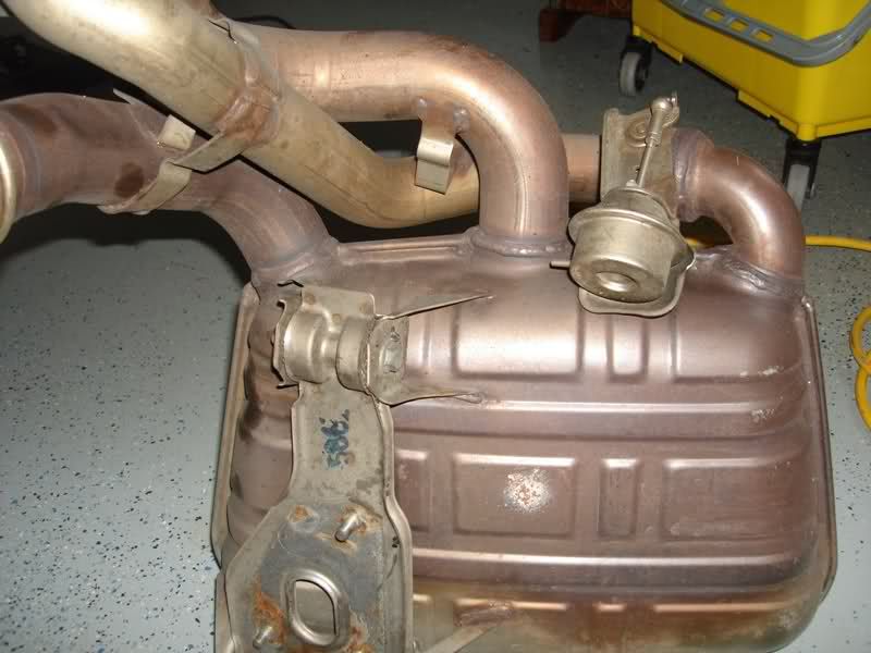

Have you tried moving the silencer valves manually to make sure they are not siezed?
Which vacuum hose did you disconnect?
Most people just unplug and insulate the vaccum valve that operates the silencer valves.
how would I go about checking the valves to make sure they aren't seized. ? I disconnected the hose that is to the left of the engine, where I had seen others do the mod.

You'll need to jack the car up, or put it on a ramp, and reach up underneath the rear bumper. You should be able to see the valves on the silencers, the actuation rod should move in and out freely whilst staying attached to the valve welded into the pipe.
Never seen the vacuum hose disconnection mod before. Far easier to just unplug the valve.

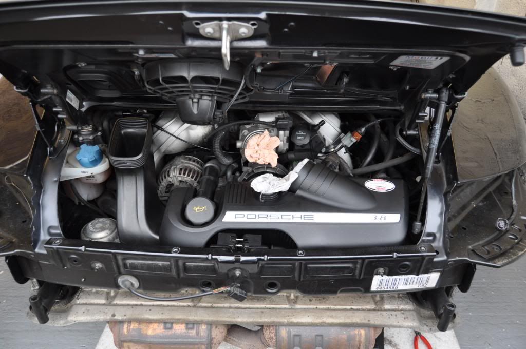

The vacuum hose that controls the valves is on the right side of the engine.

The grey valve (brown plug) on the right side of the picture conrols the vacuum to the valves on the exhaust. You can just make out the pipe running under the throttle valve and over to the left where it joins into the main vacuum line from brake servo to vacuum pump.
There should then be two vacuum lines coming from the grey valve, one to each of the silencers. The vacuum side is fairly simple, the electrical side is a little more complex as it's controlled by the DME. I installed a genuine Porsche loom so that it would work correctly with Sport Chrono, but fitted aftermarket silencers.
