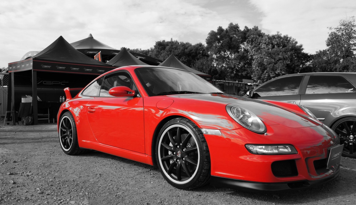

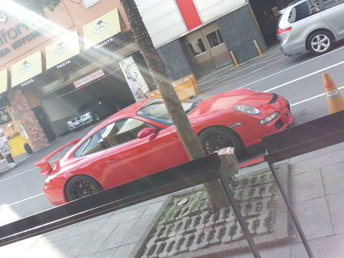

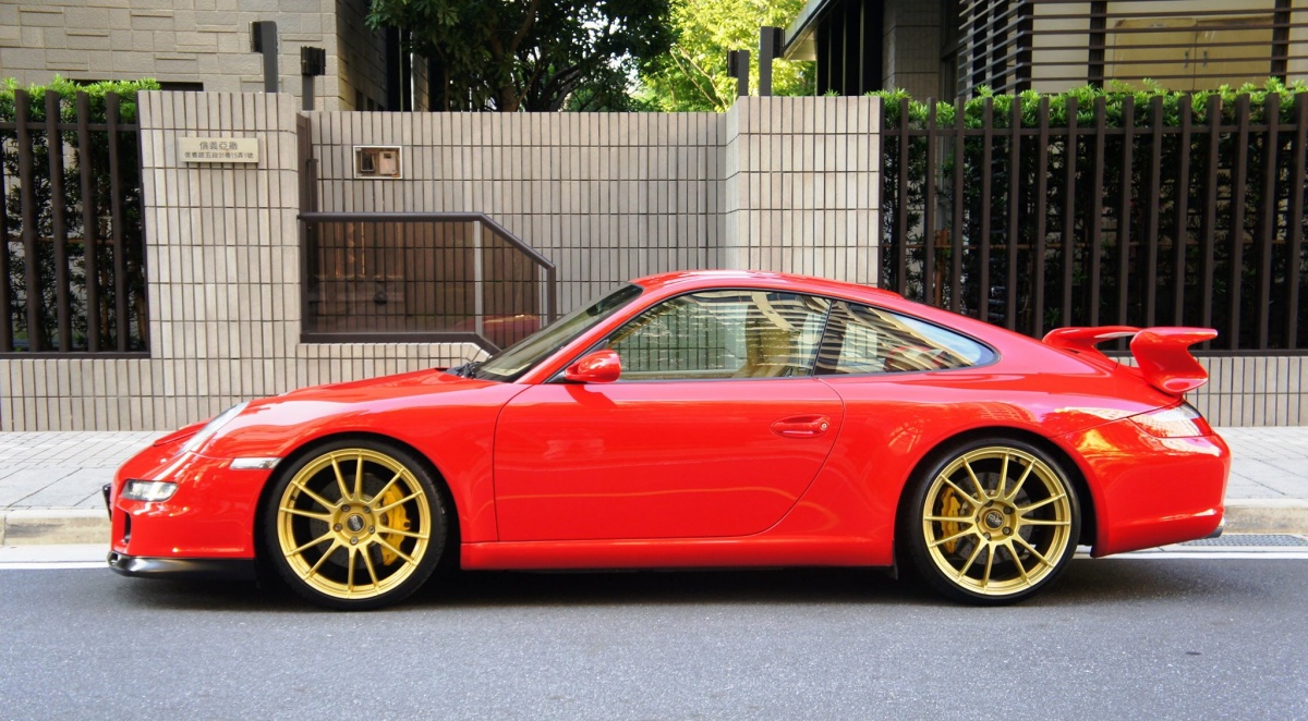

Some not very good phone pictures attached,
  1. 2 pictures with 19" Matt Graphite OZ wheels with KW V3s (current setup)
  2. Picture with 19" Carrera Sport wheels with Eibach Springs (previous setup)
  3. Picture with 20" Gold OZ Wheels is with Eibach Springs (previous setup)
as you can see the rear sits pretty low with the current setup which is about 1/2 inch lower than my previous setup with Eibach springs.
Also I have had the Carrera Sport which is 11.5" wide with 15mm spacers (effectively ET67 - 15mm = ET52 on 11.5" wide wheels) and Eibach springs in the rear which also does not rub.
Thus you should have no problem with rubbing.

Hey thank you very much for posting all the pictures.
The first two pictures with the kw coils seem like the closest drop to an H&R setup.
By looking at the second picture, It seems like you either have on narrower tires(295?)or have a brand that has the sidewalls slanted inward(ps2?).
I can see how your rear wheels stick out as much as mine but my tires stick out more since the sidewalls are more straight up.

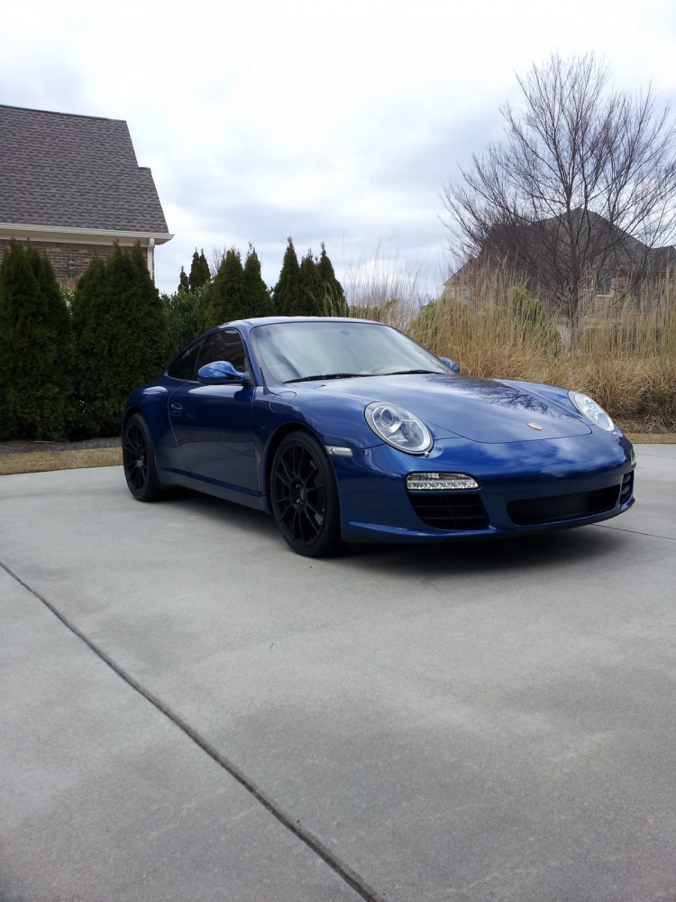

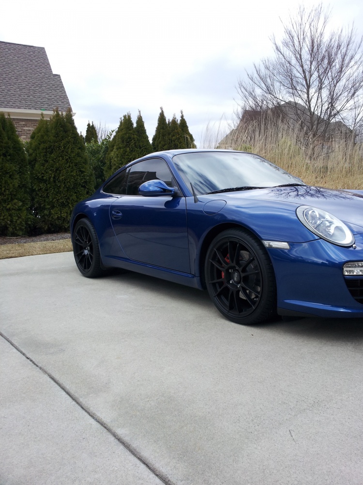

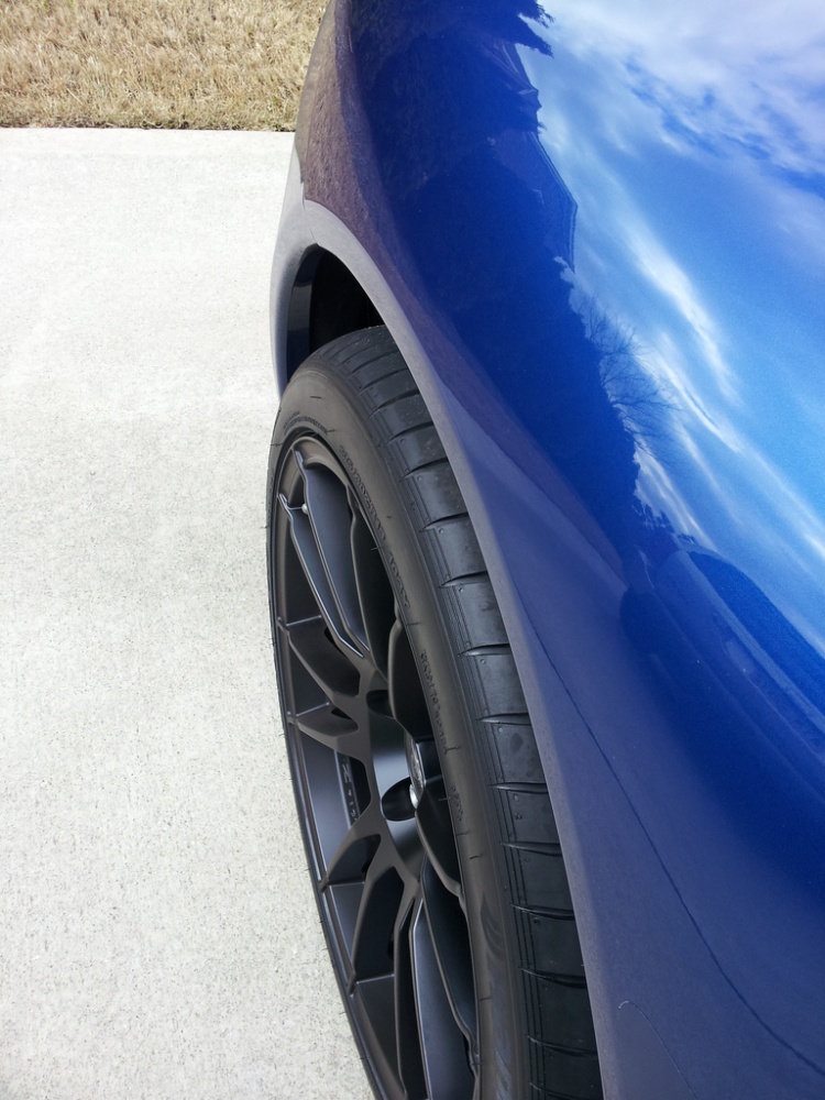

I have Hankook v12's in 305/30/19 too, but the sidewall seems too upright compare to other brands. It was really difficult to capture the right angle but here are some photos I took from earlier today:

Maybe the negative camber created by the drop will allow the tires to slightly tuck in just inside the rolled lip of the wheel arch? If I were to drop the chassis straight down, it really seems like the outer edge of the tire will rub against the rolled lip at the top of the wheel arch.

I know it's hard to tell but what do you think after looking at the pictures? Does it look like it will clear?
Old Mar 25, 2013 | 08:16 PM
killacam's Avatar
Joined: Jan 2011
Posts: 1,314
From: iLLaDeLphiA
Rep Power: 134
killacam Is a GOD !killacam Is a GOD !killacam Is a GOD !killacam Is a GOD !killacam Is a GOD !killacam Is a GOD !killacam Is a GOD !killacam Is a GOD !killacam Is a GOD !killacam Is a GOD !killacam Is a GOD !
you can always roll the fenders.
