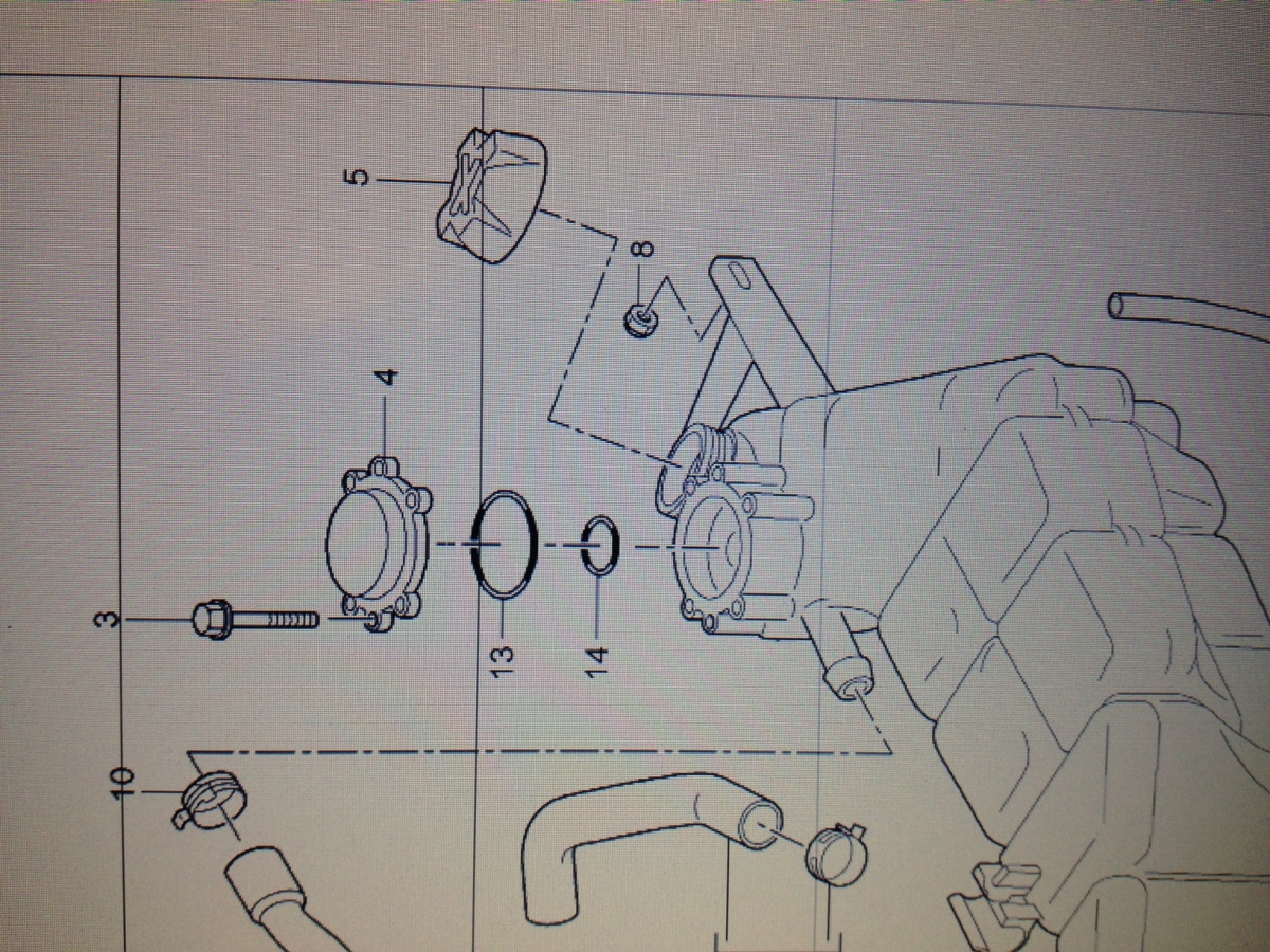

996.106.347.02 bleeder valve
999.707.370.40 o-ring 1
999.707.371.40 o-ring 2
and just get the cap ending in 04 for good measure!

PET diagram:

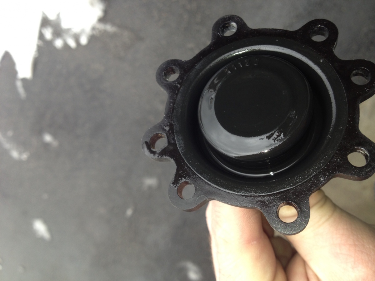

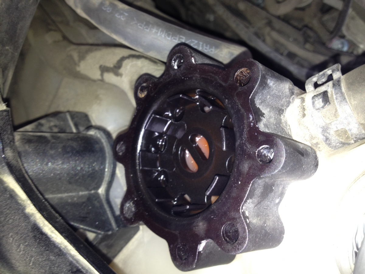

Mine taken apart...no o-rings and don't see anywhere logical for them with this design:
ID:	233412   Click image for larger version
Old Apr 17, 2013 | 02:22 PM
Johnny DB's Avatar
Joined: Aug 2010
Posts: 2,185
From: Canada
Rep Power: 149
A few of the screws were loose so I replaced them and zero coolant loss since.
