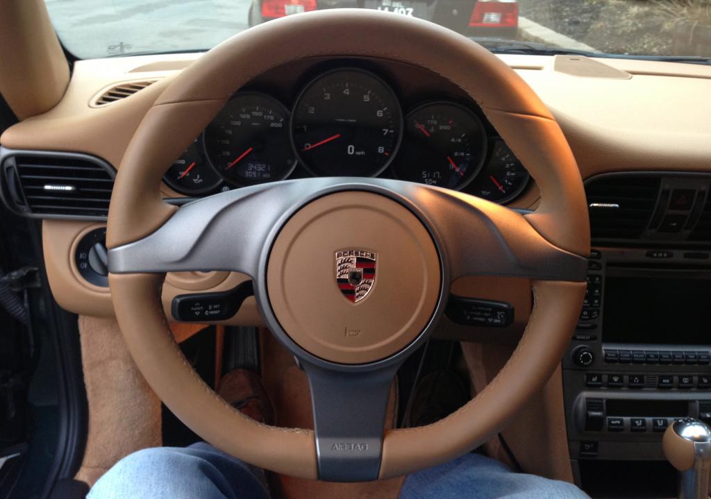

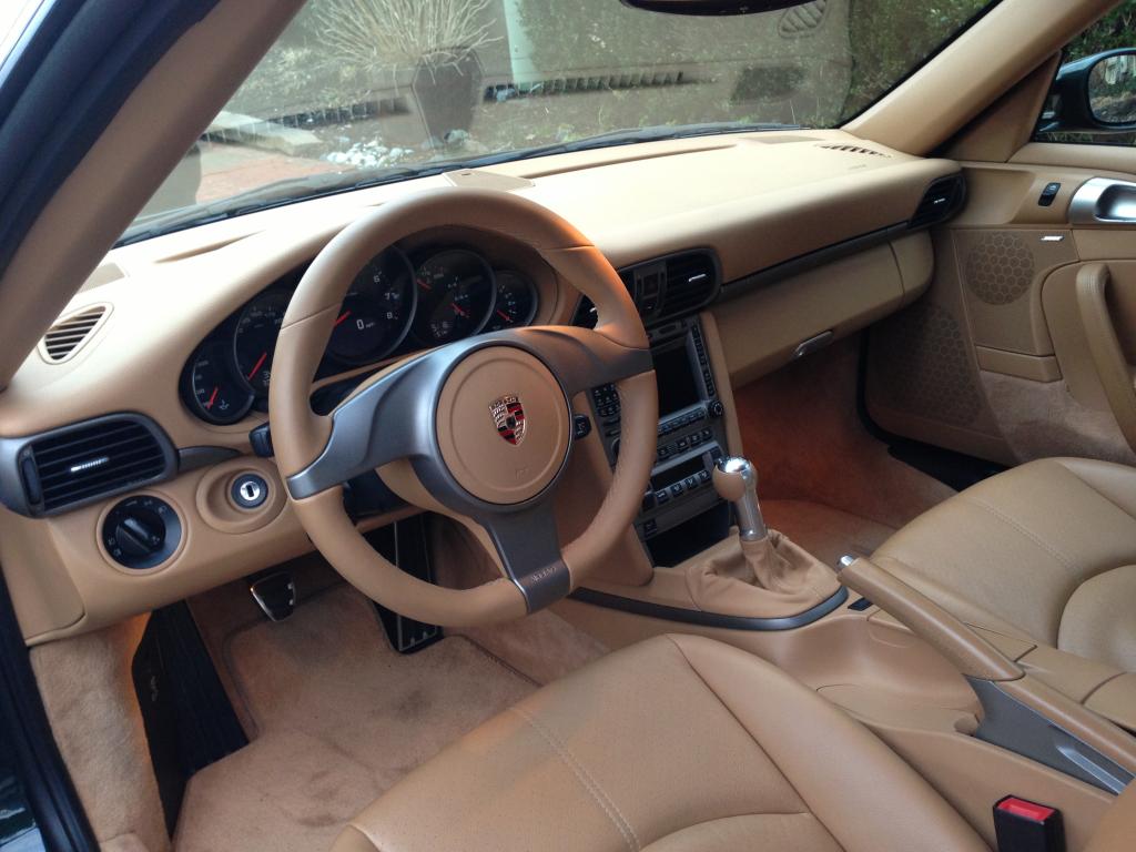

I did this a few months ago on my 2006 cab. In addition to the cost of the steering wheel/airbag, figure another $600 for the electronic control module (includes install), and another $125 for the steering wheel install. Works perfectly.
Before and after:

That looks really good - you'd never know it wasn't born that way!
Thanks man! It should've been born that way!

Great looking upgrade!

That turned out great fastm3
