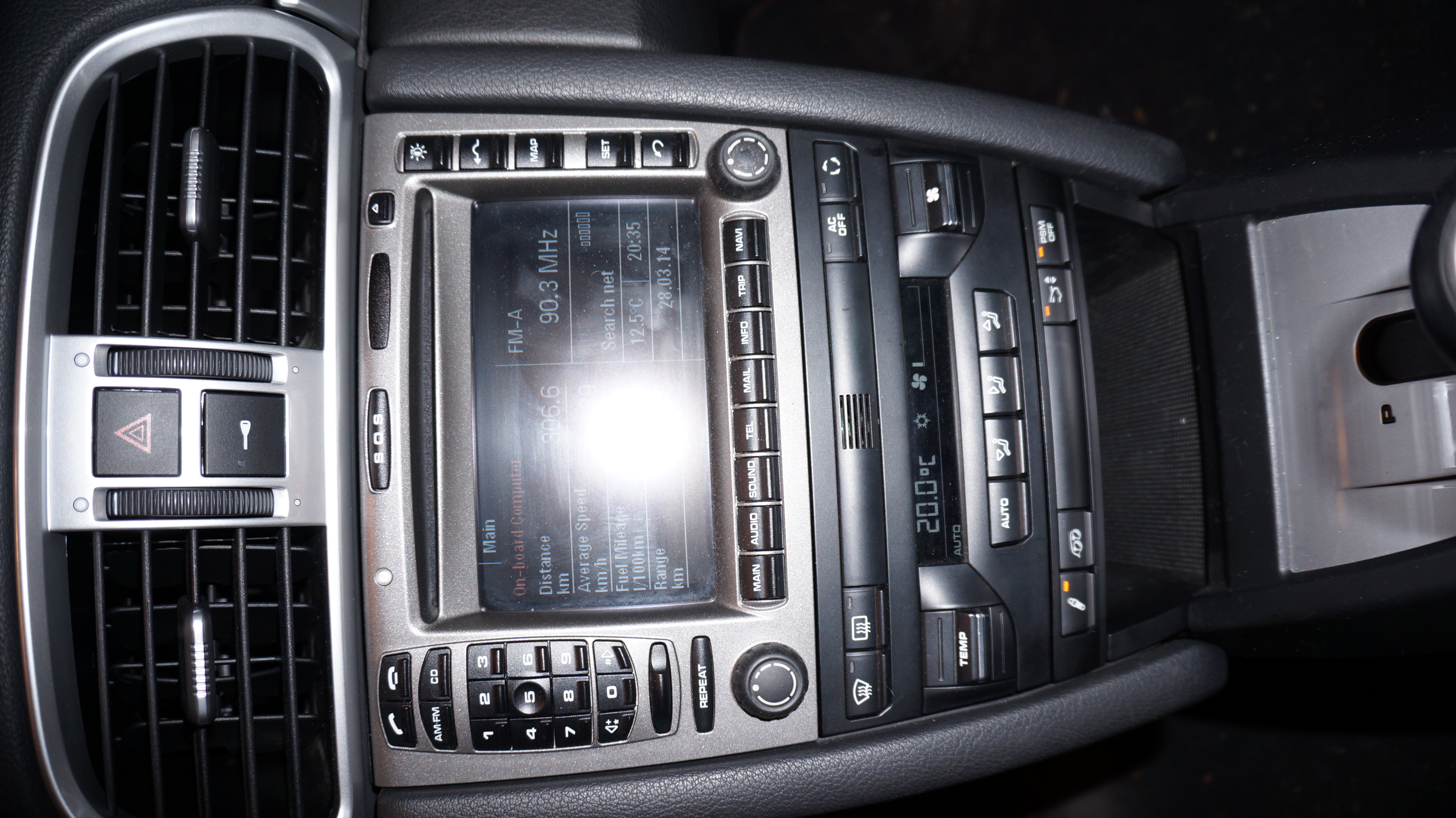

Attached photo of progress...
A/C unit installed, cubby hole at bottom installed (not very visible but its there!
The cubby hole was a lot of work for little effect! but it is better...
all I need to do now is spray everything else black - anybody know the colour type to use to match the rest?
Satin black? matt black?

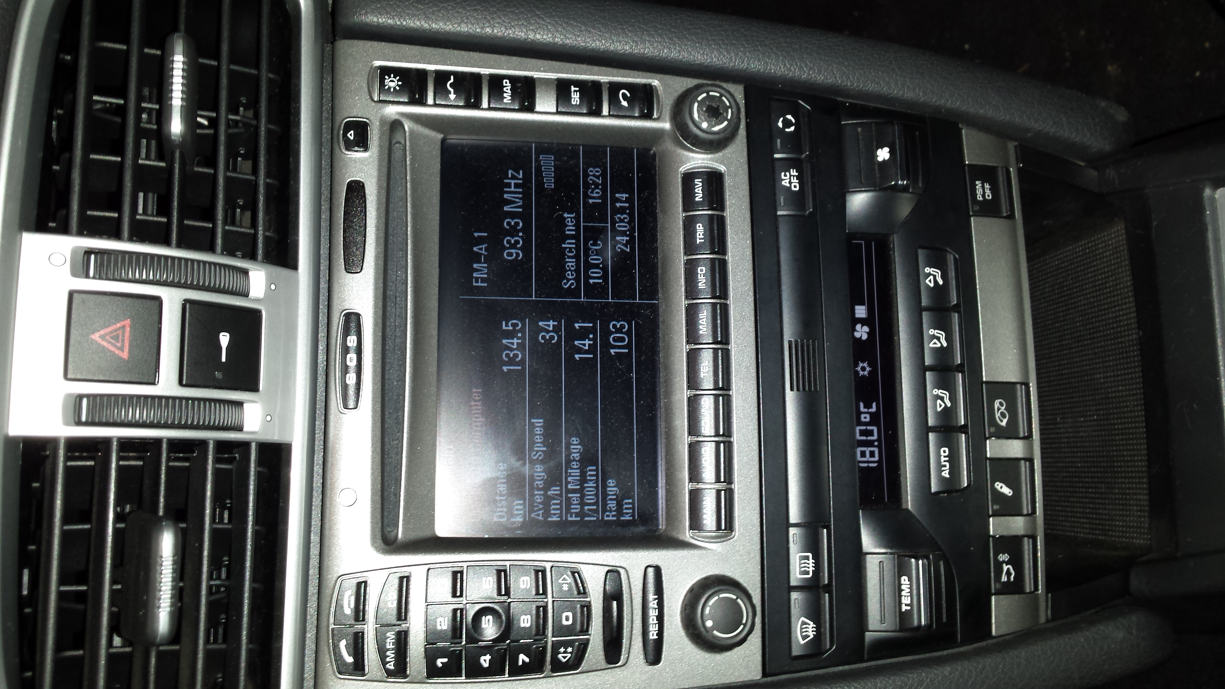

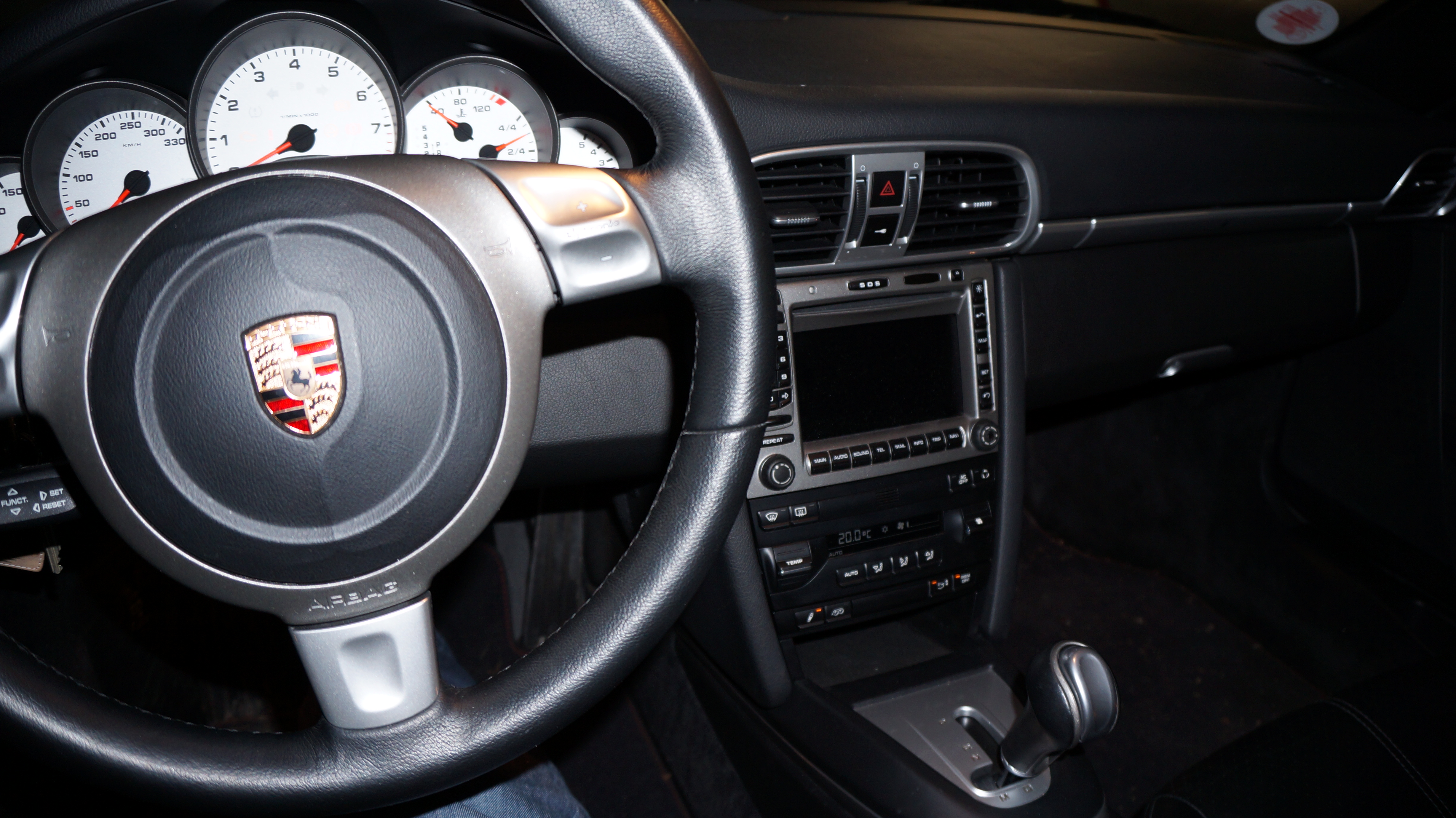

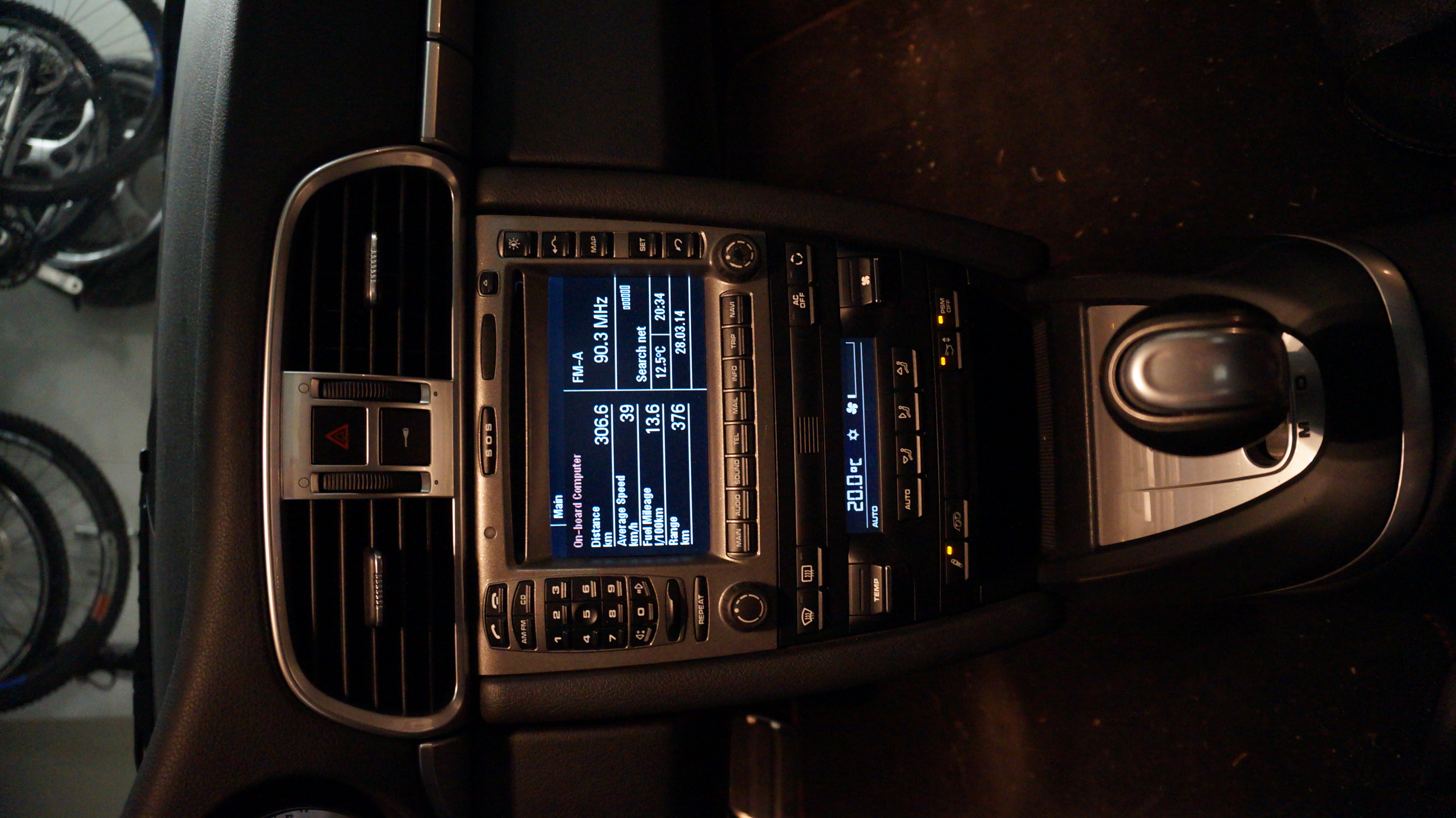

Sorted!
Took a close look at the circuit board and found the right pin for the final cable.
So i now have a full 997.2 Central area below the Navi system.
images attached - taken in the dark. I will get a daylight photo if required.
TBH even with the Navi unit looking the same -it looks a whole load better and I don't have to worry about the sticky, ugly, white temp and fan buttons any more.
I am moderately technical and not afraid to tinker - I would strongly recommend this change, total cost was around 300 USD - all was sourced from Ebay.
So i now just need to take apart the Navi unit and spray it black - I will probably do the steering wheel grey bit at the same time.....
