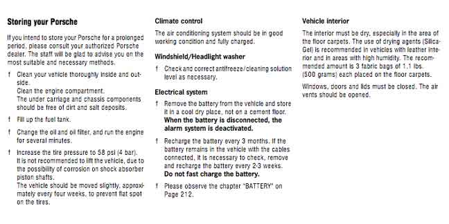

Most of the info you need is right in your Porsche manual:
