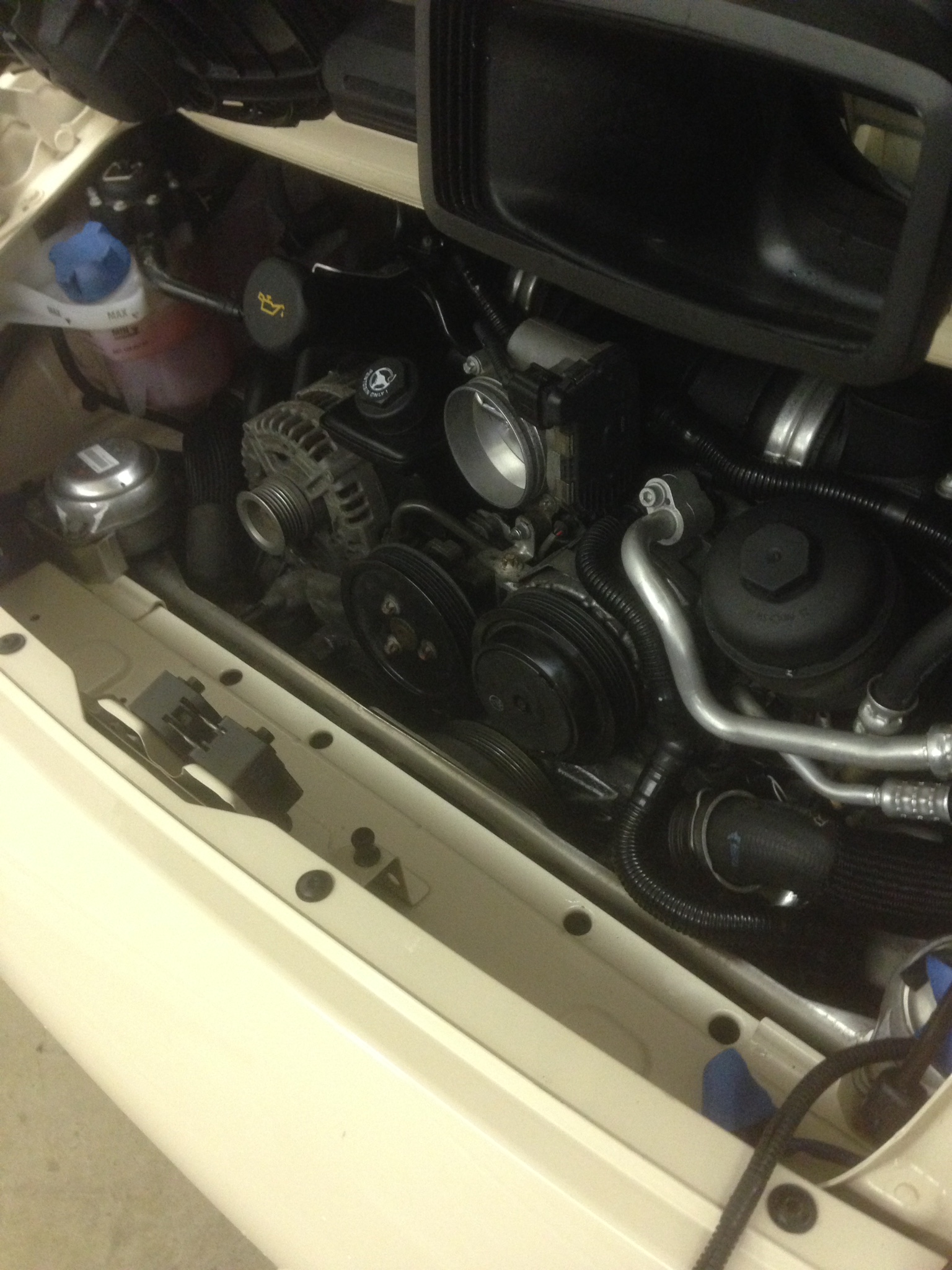

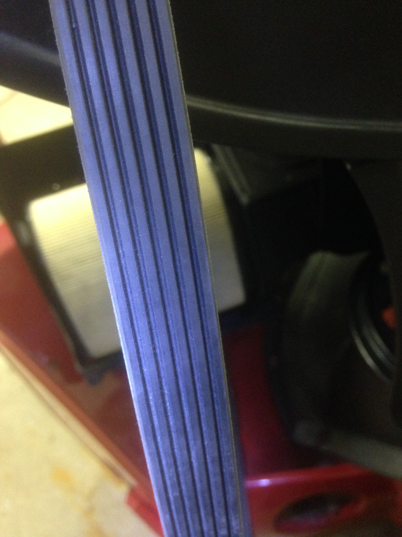

Here s a pic of the belt. Don t know how clear it will come out but there is no cracking etc at all. Not sure of any other wear because I don t have new one to compare.
Other pic is engine bay all cleaned up and waiting. LOL
Sorry they are cell phone pics.

That looks practically new. Mine at 6 years and 45k kms also looks similar hence my recom that a few more years probably would be good. What you will notice will be after removing the belt and storing it, that old belt will start degrading fast! This is just my opinion. Others reco of replace at 6 years is the safer bet. Just like 5k oil changes
