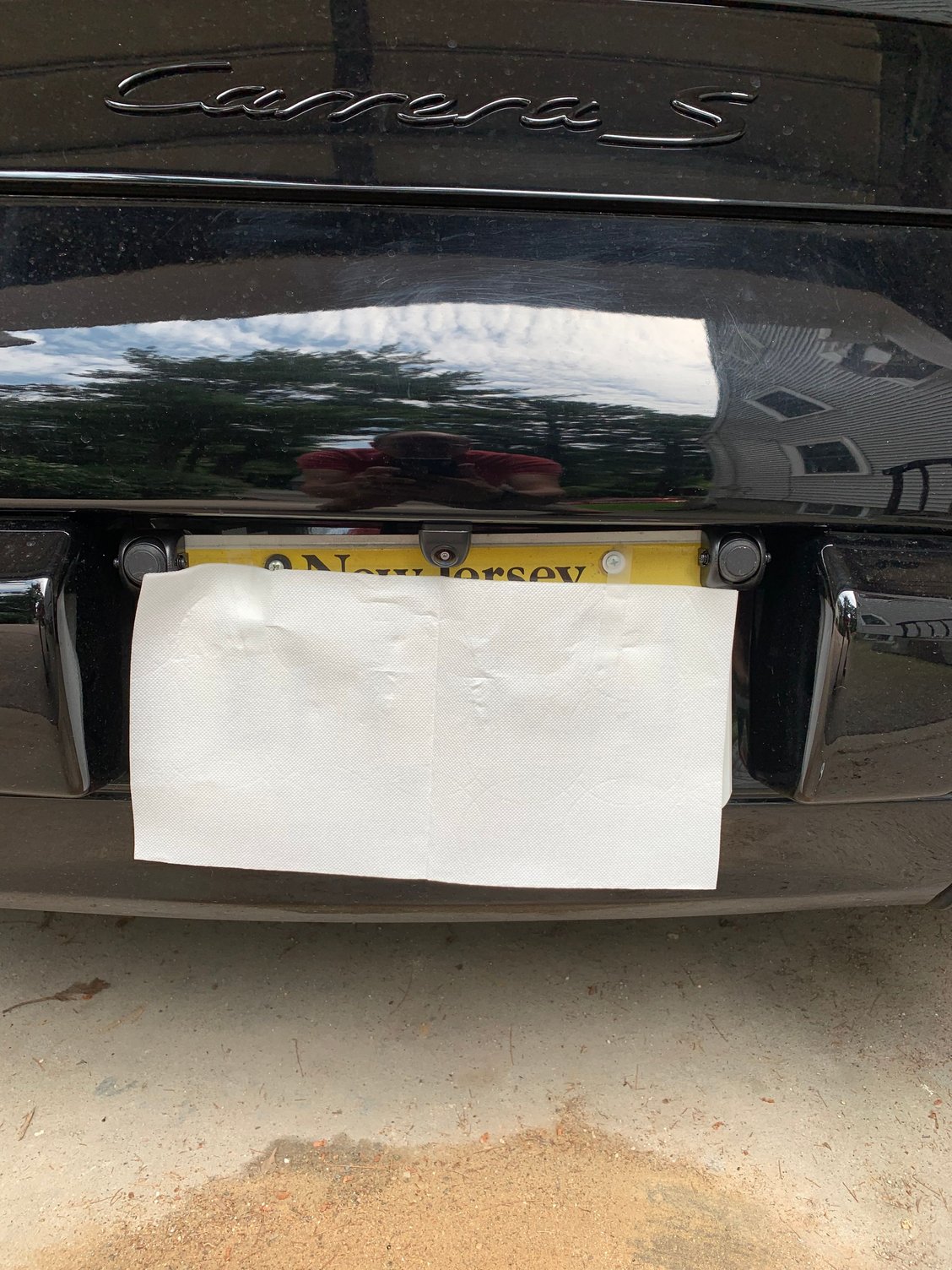

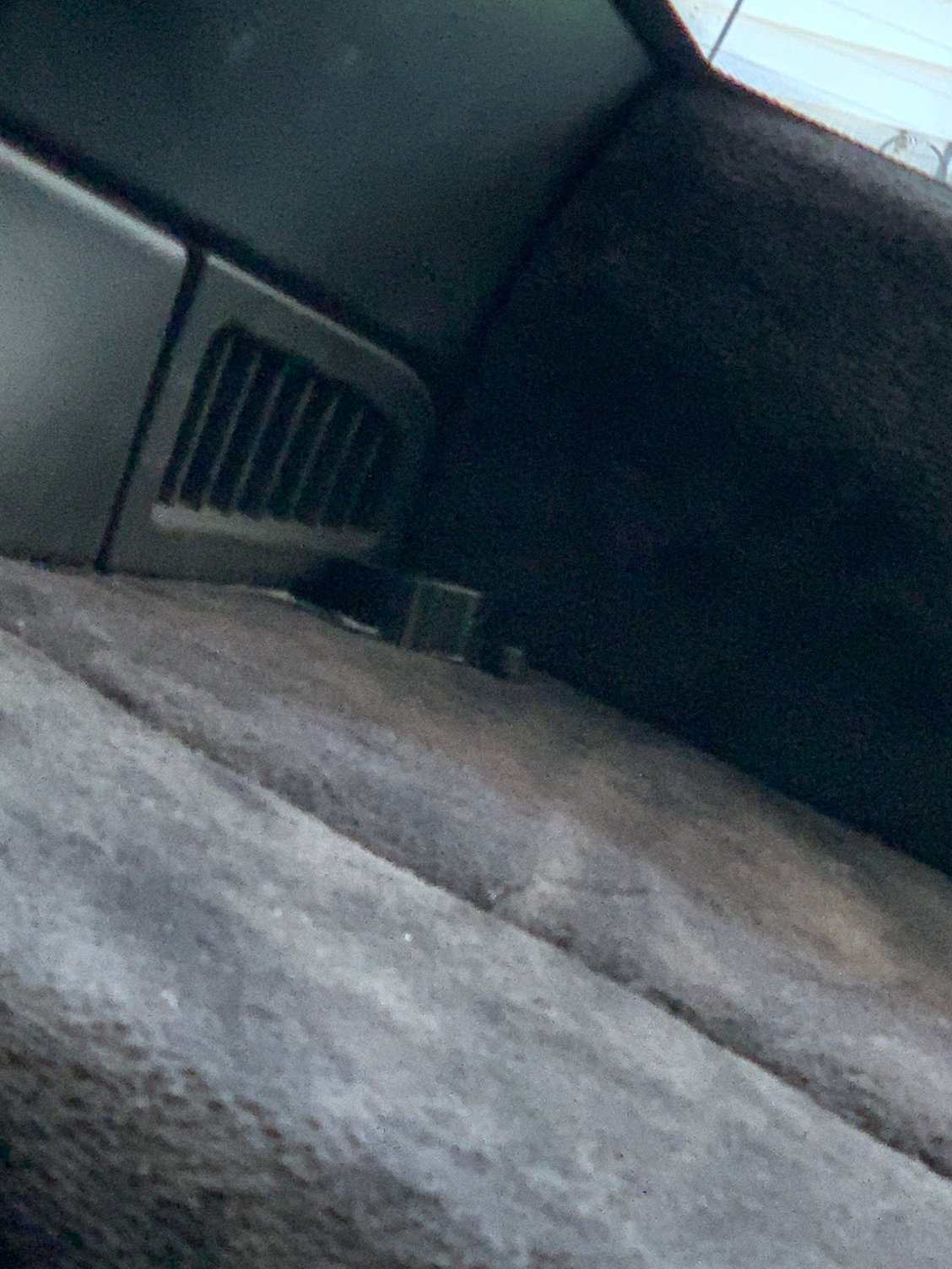

yes my original head unit has BT and AUX, hardest part for me was running the wiring for Back up camera, because line was shared by my Sport Exhaust wiring and I didn’t want to compromise it.
opening the PCM was a slight challenge, but not that big a deal.
unit still, works great.

the backup camera has additional Black/red hook up wires for tail light connection, NOT NEEDED, with NMT unit, it’s just plug and play to the NMT wiring.
the extra wire, I removed and used to hook up Hopkins sensor plate holder, hooked up to backup light.
I didn’t cut any of the camera wires, that’s why my backup PCM shows dark overlay, both backup lines are shown. So I have additional audio back up warning.
no additional back up sensors are required for the lines to work with setup.
