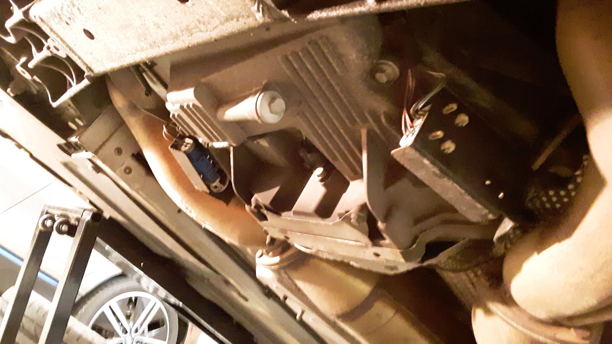

Quick question, is the one marked with the ? The third oil sump plug I have to drain on the 4.7? Pretty sure it is, just want to make sure...
Heres another pic of the questionable 3rd plug
thank you all for the help!

Yep. That's it.
