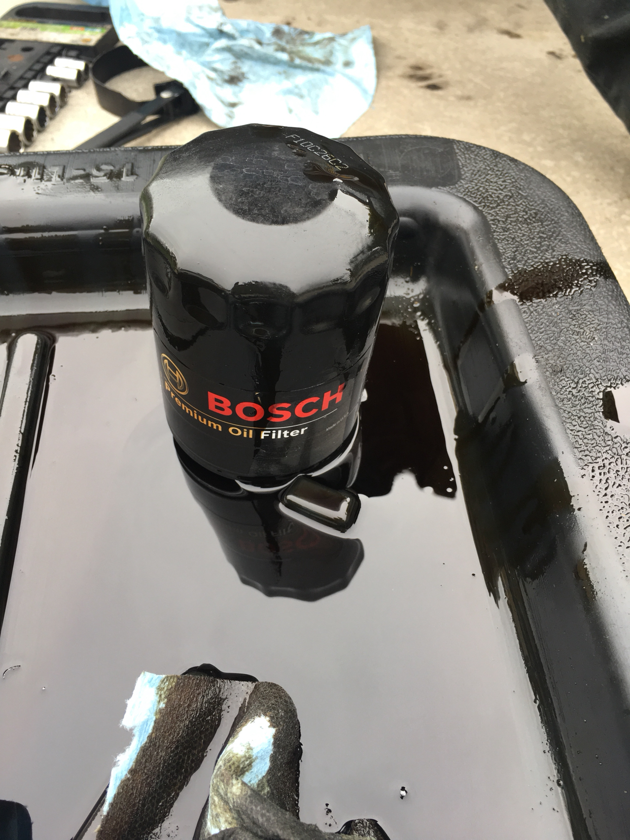

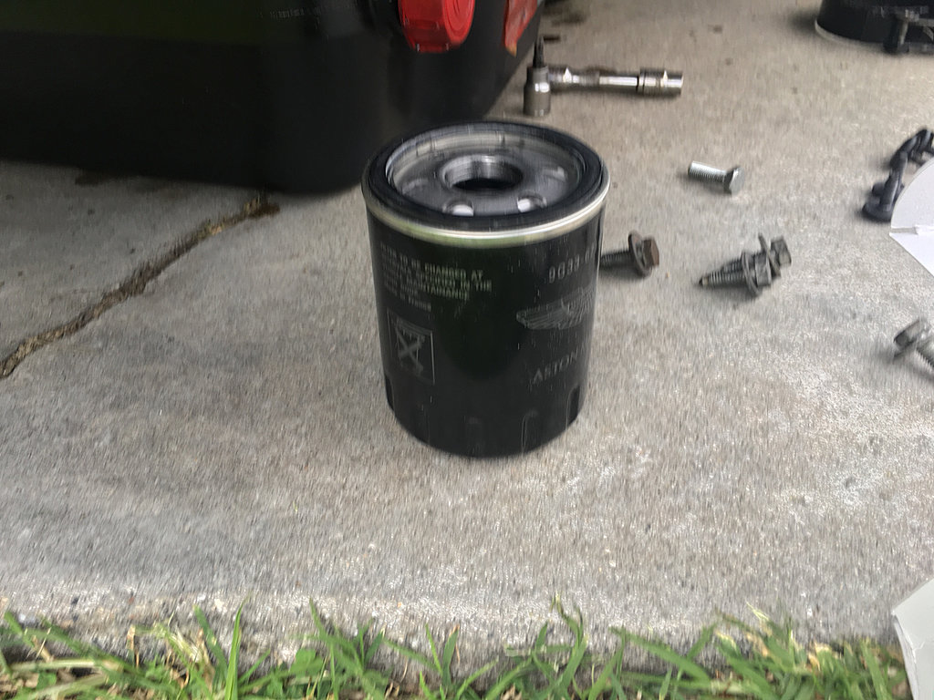

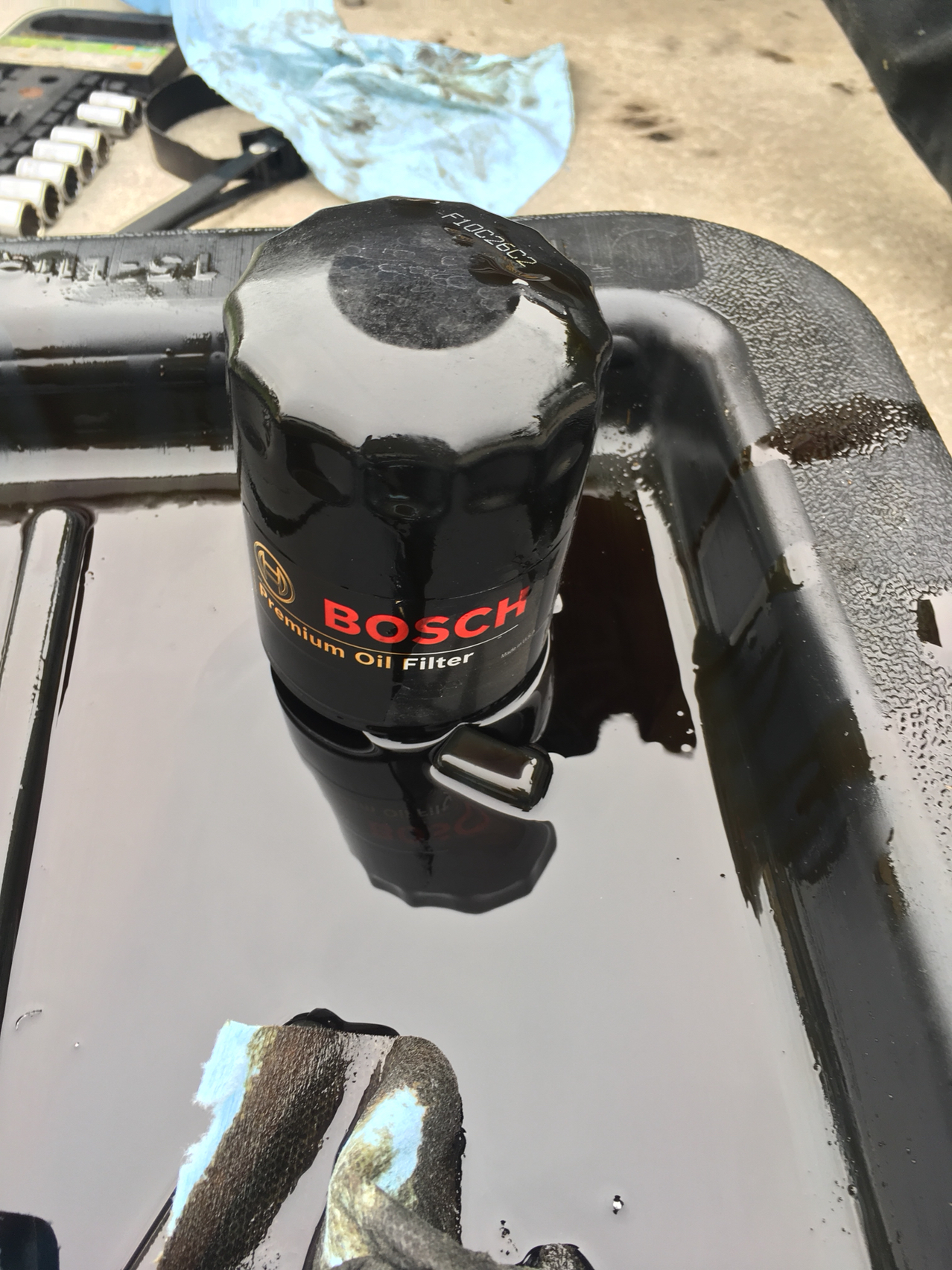

I would never use a non oem filter. Really to save $30 makes no sense.
7 years ago When I had my oil changed for the first time the filter that came out was a Bosch filter. The last oil change was done at a aston dealership in Newport Beach..
Kinda shocked a dealer used non oem filter
Attachment 533184Attachment 533182Attachment 533183
Interesting because I went to Bosch website for parts available for my 2009 vantage and all it listed were batteries and wiper blades

Originally Posted by HabitualOffender
That would be mine, which is why I bought up all the previous gen white filters I could find. And the reason they covered it, after taking a week to make the decision, was because it was dealer serviced. If you're changing your own oil do not expect the same result. And the reman engine is $44k, not 35. Somehow, and nobody knows, I got a brand new engine, and not just the long block, it was complete with every accessory already attached. I have no idea what that cost would be but guaranteed it's more than $44k.
I seriously doubt NB put anything other than an OEM filter in the car. I'm guessing you bought used, the last service record showed them, but it had been changed at home or indi after.
bought it from NB and was serviced at Newport. was a dealer car
this is when they were a aston jag dealer. the same filter is used for jags. it was them. like i said shocked.
