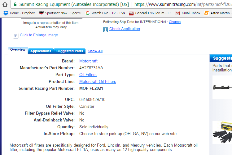

Np Telum, That's the point - Is there more to it than just a fancy winged label. I didn't think so and have done prior oil changes with what I believed to be a compatible alternative (if not the same one unlabelled) so till Scotty4300 posted that RV value - if he's right - then yes there is more to it. It's unfiltered oil, not clogs from infrequent changes that is the issue.
I do know that most AM models in the 60's - 90's used RV ratings that were more in line with tractors than cars - but not uncommon for racing cars. Many used either the Donaldson P553771 or the P550052 - these have RV's in the 29-35psi range. If you put a Pep Boys Fram in one of these depending on the required flow rates you have a high risk of significant oil flow straight through with all the contaminants unfiltered.
Unless I can establish it is not 23 psi my next oil change might use an Aston Martin oil filter until I can have two tested to see what the RV value actually is, that is unless Scotty4300 can clarify where his info came from?
Aston Martin Donaldson Filters 1966-1995
Donaldson P553771 Specification:
Lube Filters Product Attributes
Outer Diameter: 3.66 Inches (93 MM)
Thread Size: 1-12 UN
Length: 7.87 Inches (200 MM)
Gasket OD: 2.81 Inches (71 MM)
Gasket ID: 2.42 Inches (61 MM)
Efficiency 50%: 20 Micron
Anti Drain Valve: Yes
Bypass Valve Setting: 29-36 PSI (2.0-2.5 BAR)

Don, You choose an aftermarket for the same reasons I went for the OE alternately supplied - Price and convenience
As I stated I can't say any of the filters you offered were not right - well except that FL2021 - but perhaps Rock Auto have it right and Summit Racing got it wrong.
As far as the WIX filters go I bought several of the 57302 in my quest for the correct AMv8 filter - even cutting one in half- it is very well put together and meets almost all of the AMv8 OEM filter specs with the exception of one (not the believed RV). I had matched the specs for my oil filter to what I knew at the time were the AMv8 specs till I read this thread.

Non OE Option for Oil Filter: Wix Filter for AMv8
Originally Posted by Cloneman315
Wix filters are very nice.... I would stay far away from fram!
I thoroughly agree. High quality and now that I know the spec for the AMv8 RV is not 23 psi the 57302 specs line up nicely for my AMv8. Wix were once an OE supplier to Aston Martin for oil filters but I doubt they are supplying current AMv8 filters since Redpants says these are Made in France. Wix has no manufacturing plant in France and has deep roots in NC, USA, a plant in Mexico and one here in Ontario.
Comes in Black or White.
Manufacturer Website: http://www.wixfilters.com/
Brand: Wix
Part Number: 57302
UPC: 00765809573024
Part Type: Engine Oil Filter
Principal Application: Ford Thunderbird (03-05), Lincoln LS (02-06), Land Rover (05-09), Jaguar (06-10)
Style: Spin-On Lube Filter
Service: Lube
Type: Full Flow
Height: 4.225
Outer Diameter Top: 3.095
Outer Diameter Bottom: Closed
Thread Size: 1-12
By-Pass Valve Setting-PSI: 16
Anti-Drain Back Valve: Yes
Beta Ratio: 2/20=16/25
Burst Pressure-PSI: 375
Max Flow Rate: 12-15 GPM
Nominal Micron Rating: 21
Duty Type LD
MediaType Enhanced Cellulose
Inner Diameter Top Closed
Class A
Wix 57302 Oil Filter OE Cross Reference Compatibility
Ford
Thunderbird: 2003 - 2005
Jaguar
S-Type: 2006 - 2008
Super V8: 2005 - 2009
Vanden Plas: 2006 - 2009
XF: 2009 - 2010
XJ8: 2006 - 2009
XJR: 2006 - 2009
XK: 2007 - 2009
XK8: 2006
XKR: 2006 - 2009
Land Rover
LR3: 2005 - 2009
Range Rover: 2006 - 2009
Range Rover Sport: 2006 - 2009
Lincoln
LS: 2002 - 2006
Wix 57302 for Ford Jaguar and Land Rover Engines
Edit: You should know that I have not looked at any other requirements beyond the AMv8v 4.3 liter that was in MY 06-08 - so the info I posted above may ONLY be applicable to that.
Last edited by BMW-North; Dec 8, 2016 at 09:10 AM. Reason: This is applicable to the AMv8 4.3 06-08

Originally Posted by blue2000s
If anything, the V8 is the least Ford of the two AM engines. The V12 is pretty much a couple of V6 Duratec engines lined up together.
I have 2 WIX premium filters for the Jag 4.2 but without confirmation of the relief pressure, I won't use them on the AM. Unfortunately, WIX does not offer an XP version of this filter.
You mean without having confirmation of the RV setting on the current AM filter? The RV setting for the Wix filter above is 16 psi - it's in their specs. If it were a filter with 7 or 8 psi I would be concerned.
I'm satisfied that the introduction of 23psi into this thread originated from a thread at AMOC that was neither for this engine, nor was it verified, and later was admitted unverified. Here's the thread:
Topic: V-12 Oil Filter Identification Puzzle Solved
I believe what you are saying then is no one on this board/forum actually knows what the required engine lubrication system RV relief spec is for our engines, so to be safe we should just use whatever filter AM is putting out - cause they know?
Having just installed a Ford t-stat while putting in the Ford spec oil filter, and dropping in a couple of Ford cabin filters and clearing the ECU with Ford WDS - I'll take my chances that it followed suit with similar Ford v8 conventions and is RV low 11psi and RV high 17psi. A filter within those specs meeting the other technical requirements will work for me. Others can continue to buy filters from Aston Martin - won't bother me a bit.
BTW - Testing of the RV valve is required for total verification - can be done at any manufacturer in-house lab, but you can tell quite a bit by cutting open filters as the guys at AMOC have done it often. For example the racing version of the FL820s has much thicker metal canister to withstand the higher pressures.
