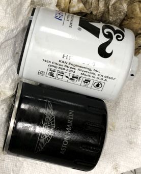

Hello,
The original poster suggested Fram PH9010 as a substitute oil filter. I used K&N HP-1014 filter and it fit exactly. The K&N has the hex head that makes it easy to remove. As noted, the filter location is tight on Vantage and difficult to remove using conventional tools, and the last resort (stab a screwdriver through it like Tavarish did on Youtube) is not desirable. 2x Motul 8100 10W60 5L jugs is exactly the right amount of oil (=10.5qt).
Sorry for the glare on photo.

Originally Posted by voodoocat
Hello,
The interchangeable fit isn't a problem, the concern is that the Aston filter has an unusually high bypass pressure, about double what you typically find. Thick oil. And we haven't seen data suggesting an equivalent from the aftermarket. I'd love to find one though.
One more point on this. Lower bypass pressure means that the oil is not being filtered as much as intended. It's bypassing the filter media. Meaning more metal bits circulating through the engine. Which isn't good for longevity, as one could imagine.
