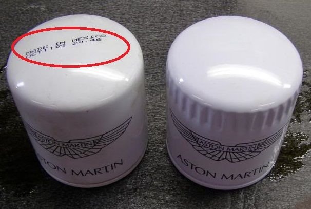

Originally Posted by Scotty4300
Be careful with alternative oil filters. Check all the specs.
The bypass pressure for the OEM filter is a relatively high 23PSi.
I f you use a filter with a lower bypass pressure you could have most of the oil circulating without passing thro the filter.
I'm curious where you obtained your relief valve (RV) setting value (23psi) and to which specific OE filter(s) you are referring? (AM Models, engines etc)
This info seems to be closely guarded and the only reference I have found to AM oil filter RV values is from an old AMOC thread where a few owners were trying to find a non OE replacement for the AM oil filter for the v12 and sent one to Wix for testing - A member (DWR46) reported that the filter examined had a bypass RV setting at 23psi. However, that's a different oil filter and engine to the AMv8, and likely flow rate. Later in the thread he reported that he believed Wix hadn't really examined the Aston Martin filter he had sent them, bringing question to the actual bypass relief specification of 23psi he reported in the thread's first post. The net result of that thorough investigation by several AMOC members however was that the Ford Racing CM-6731-FL820 Oil Filter was possibly a superior option over OE for their Aston v12. The correct RV for that AMv12 was never substantiated.
Donaldson makes the oil filters for AMv8 (and more) at their plant in Mexico. It appears though that the only auto market full flow spin on oil filter made at that facility with a 23psi bypass relief setting and similar other physical specification is manufactured for Peugeot. If you have more oil filter specifications for the AMv8 please share.
The V8 Vantage's oil filter is made in France. Click the image and you can see it on the box.
http://www.redpants.lol/shop/oil-filter
The AMOC thread I referred to determined that AM contracted Donaldson to make their filters in Mexico (2013) - they have similar pics with the AM logo and the filters are stamped Made in Mexico - perhaps only the v12 is made in Mexico. Pics are here:
https://www.amoc.org/forum/index.php?topic=27222.20
My main question is where did the 23 psi value come from for the Amv8 ?
Edit: Donaldson have plants all over the world BTW.
Aston Martin Oil Filter - Made in Mexico
