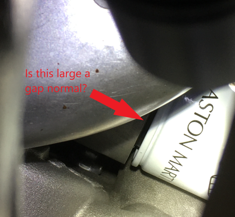

Originally Posted by wysoseereeus
Just wanted to verify...
So I hand-tightened the oil filter on my 2009 DBS. It feels snug. However, I noticed a gap (maybe 3mm?) between the lip of the metal filter housing and the surface the filter attaches to. Is this normal or should the lip sit flush against the surface. I'm trying to be careful not to overtighten. (There don't appear to be any leaks of any sort.)
That isn't on far enough.

Should it sit flush or will there be a small gap?

I usually do hand tight and then quarter turn.
It will still look like there's a little gap, but the o-ring needs to seal on the plate. I suspect there's gunk on the threads that make it feel like it's stopped. Try and clean the threads off with a rag with a little degreaser on it.

No gunk.......could have double gasket from old one on there(unlikely) or just didn't crank on it hard enough. It should have spun on with virtually no effort until rubber gasket made initial contact with housing. Only then should you feel resistance.
Thanks everyone for the replies. I think this answers it. I stopped turning when I felt a decent amount of resistance. I think I probably just need to turn it a little more.
