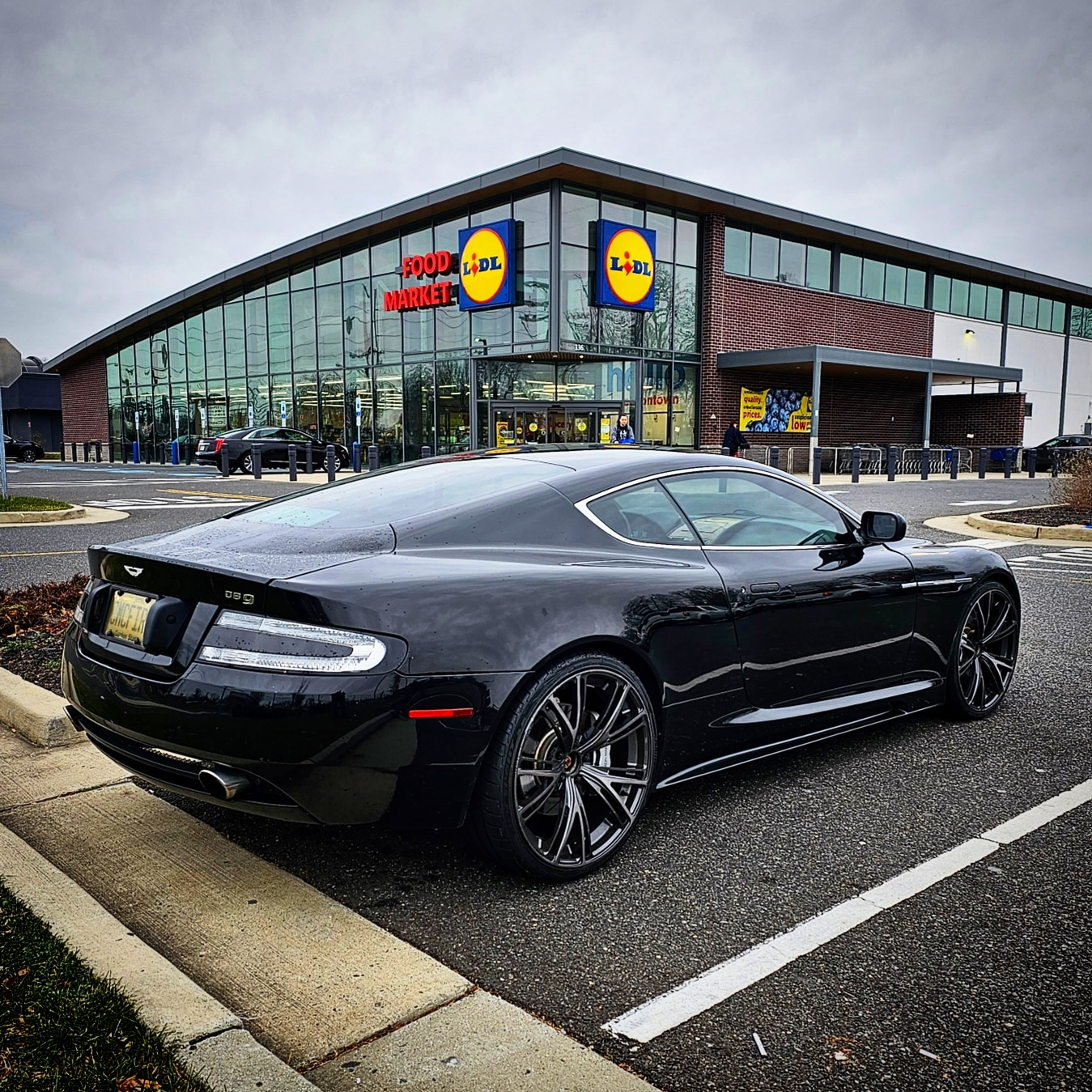

I can confirm. I installed OEM DBS side skirts on my 05 DB9

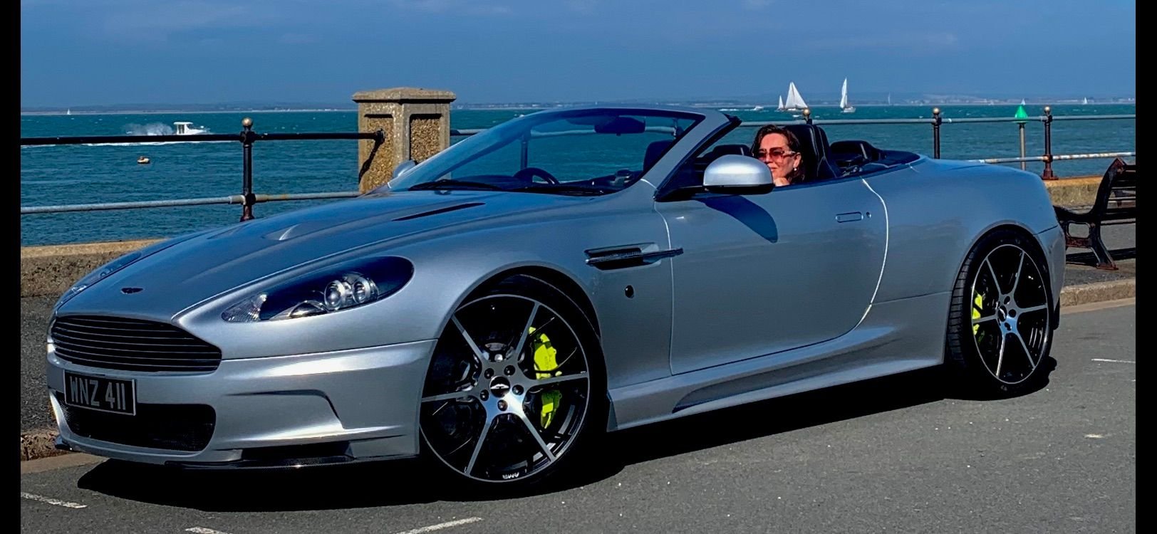

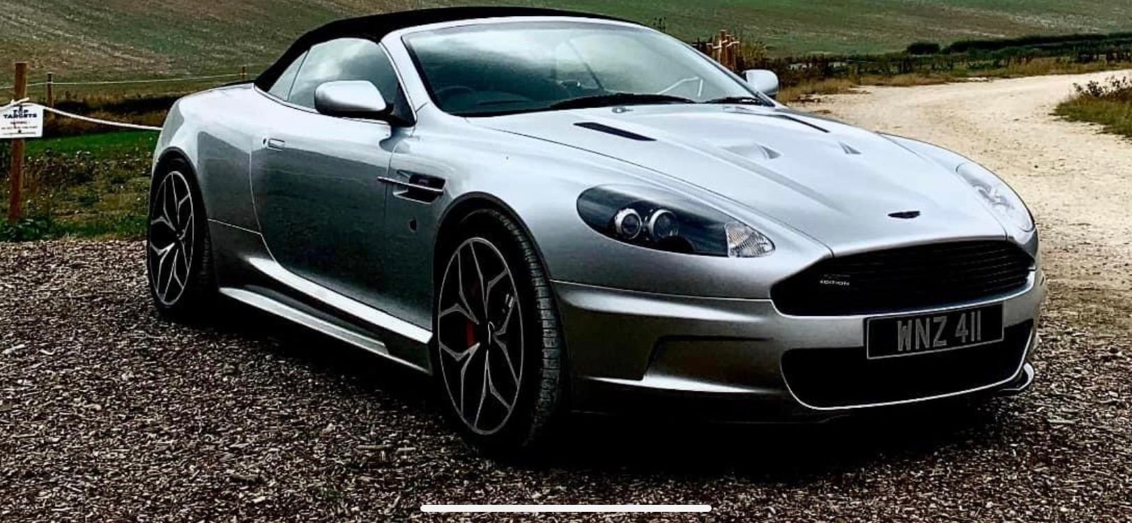

DBS sides on db9
Originally Posted by jess996
anybody here done this before? am I gonna running to some fitment issue?
essentially no as the profiling are different especially under the front fender
here’s a set reworked to fit my DB9
pm me if you need any help

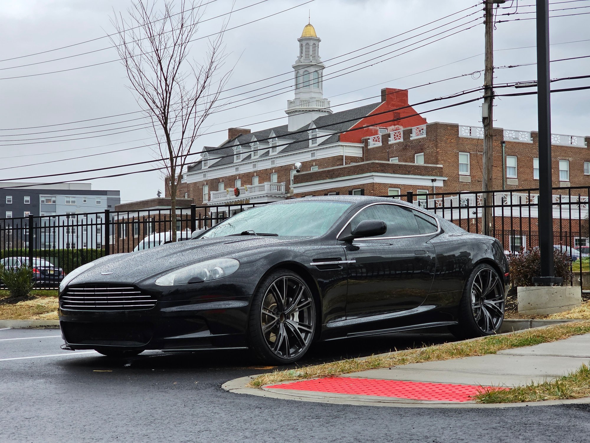

This is my DB9 with DBS side skirts, bumpers etc.
