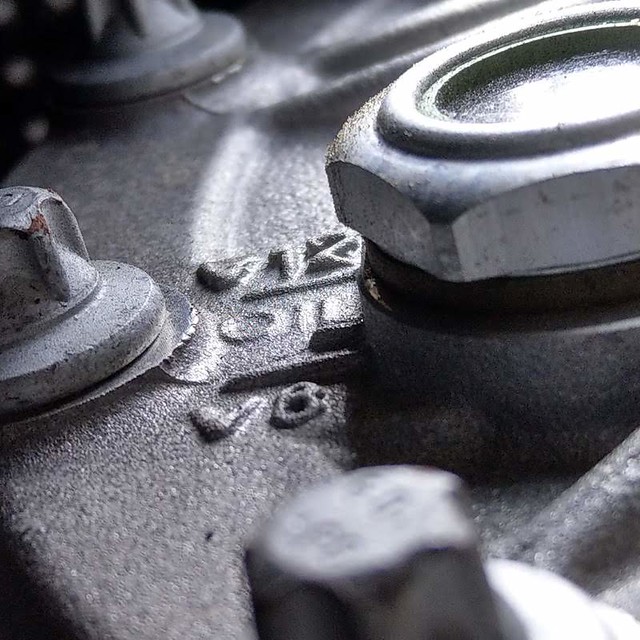

Old Nov 21, 2022 | 05:16 PM
V12Vin's Avatar
Joined: Mar 2013
Posts: 525
From: Long Beach
Rep Power: 35
V12Vin
A gentle bump.
Has anyone done a 2017 V12 dogleg transaxle gear oil change?
Read through all the necessary threads on this forum and they are very helpful. Spent sometime underneath the car looking for the filler + drain plug and filter screen. Pretty sure I identified the first two but the filter is nowhere to be found.
And I did find an oil level sight glass with the inscriptions V12 Oil V8 and a couple of horizontal lines pointing to where the oil level should be for a V12 and V8. The oil appears to be quite clear. So I plan to delay the service til next year. But should I go ahead with the change, my concern is if the new fluid should still fill up to the filler plug level. Or just fill in the same volume that drains out?
Any feedback or thoughts appreciated.
Update:
Looks like I found the answer and hopefully someone can verify. Since the dogleg is a manual version of a Sportshift, the oil sight glass is where the original Sportshift uses as a fill plug (see last picture from a V8 Vantage S). That explains that on a V8 Sportshift, one fills up to the aperture, where the bottom line inscription points to the lower end of the sight glass. But on the V12, the oil level has to be on the top part of the sight glass (maybe a quart more?). I am guessing only way to fill up that much extra is to move the fill plug further up and install a sight glass on the original fill plug location.
