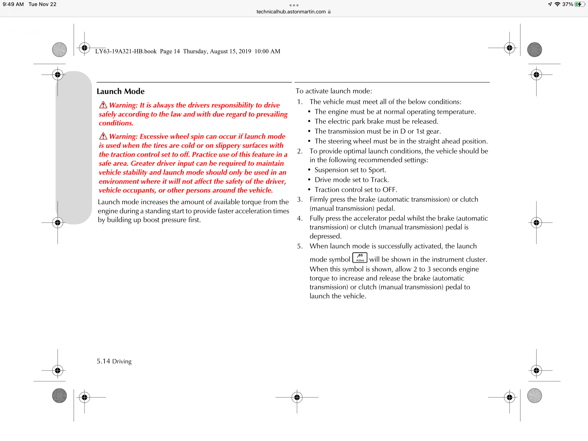

Here are the procedures for launch mode...

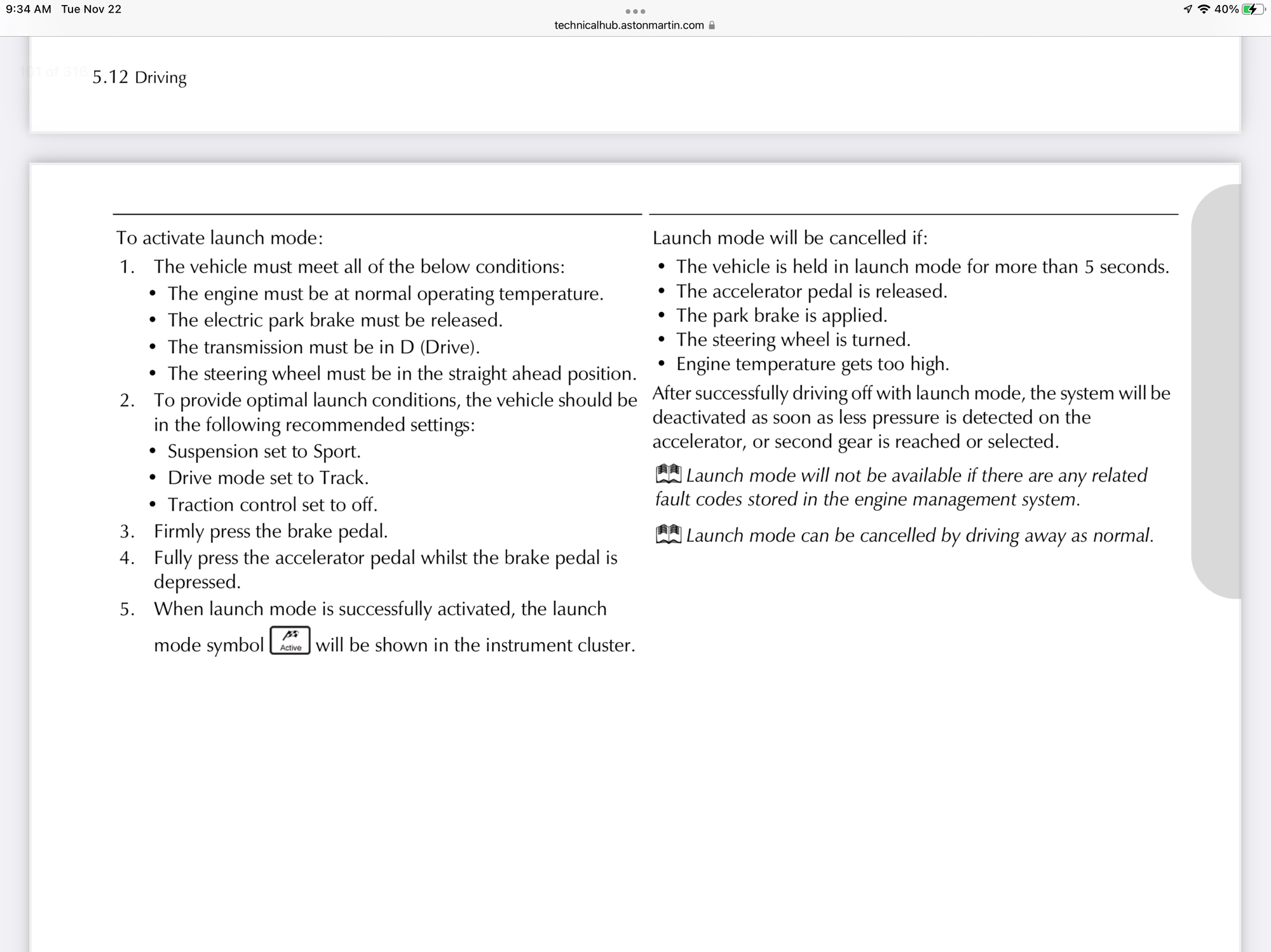

Here's some more language from 20.5MY... Note the launch time..
Boy... I hope this isnt their 1st car with launch mode... not many know of it in the newer Vantage..

I'm pretty sure this is their first car with Launch Mode. Compared to other cars in this class, the launch is ridiculously weak, but at least it has something. When I tried to launch mine, I had the suspension set in Track. I'll try it again with it in Sport. I also just bought my car from a local AM dealer. When I started it for the first time, I had an" Oil Over Full" code. Seeing that Launch Mode won't work if there are any stored codes, this could be another issue. I have an appointment to deal with the Oil code, so I'll see what happens after.

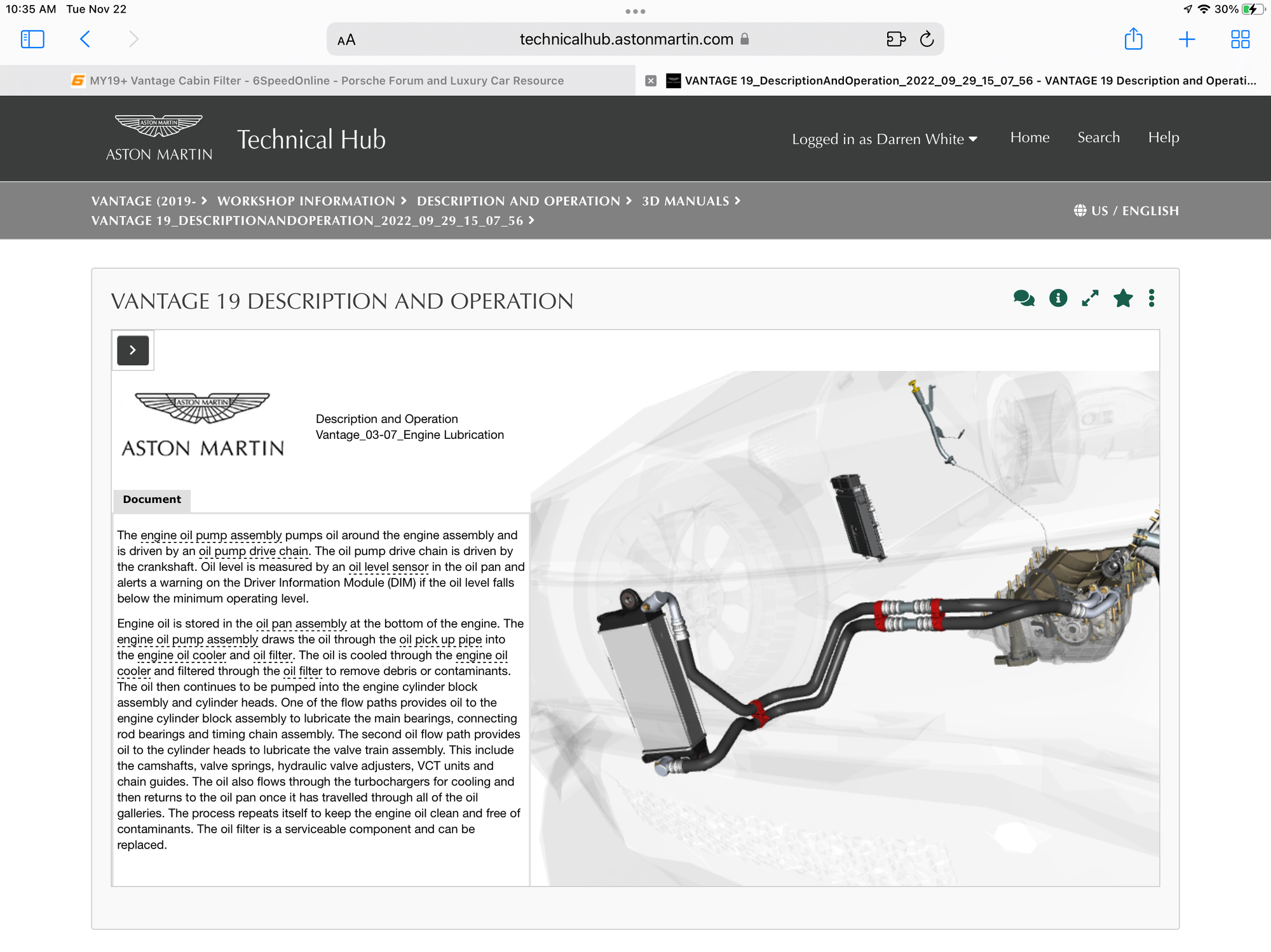

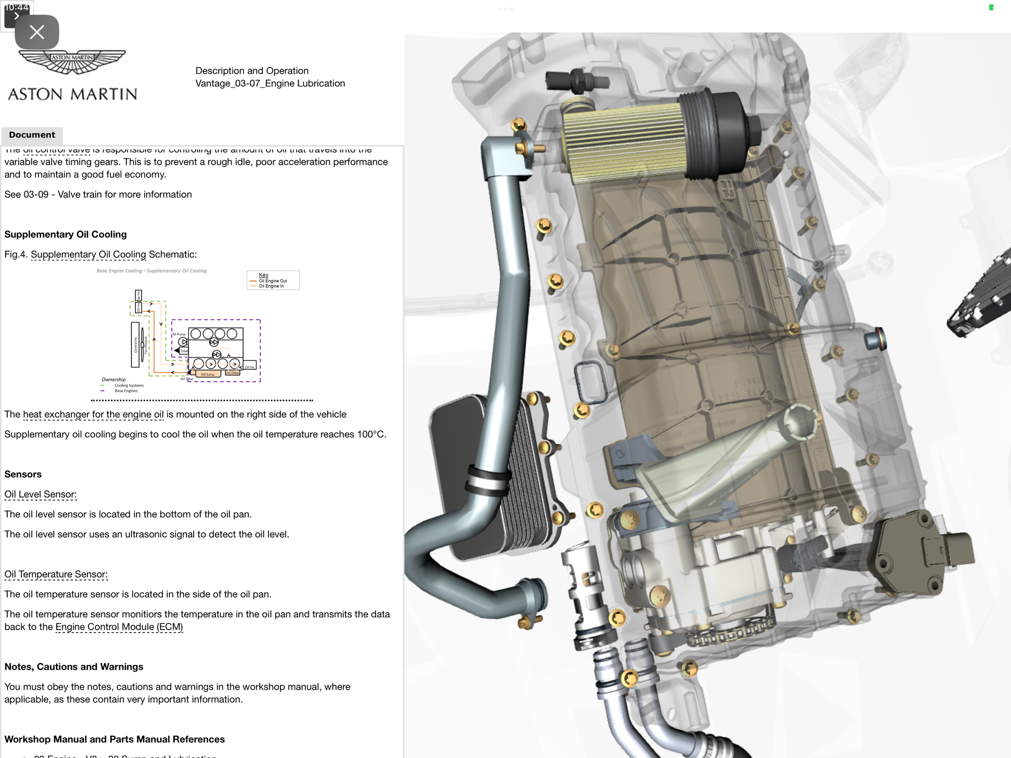

this should help with the oil issue.. R/R sensor... SEE ATTACHMENTS

Yup, its a glazed sensor from sitting... the heated oil from driving it cleared the "ultrasonic" signal... Change the oil first..IMO..
You can get a subscription to access the WSM and parts etc... https://technicalhub.astonmartin.com
