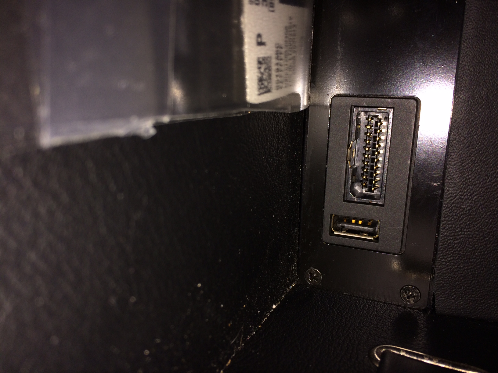

Vehicle has USB (iPhone 5 says "unreadable" but charges)
Vehicle has another multi prong hole but no cable. Am I guessing right to think this cable only comes 30 prong and not lightning (will it even work with the 30>>lightning adapter from apple ) ... Serious prong. To 30 pin. To lightning! Jeez. I wish the car just had AD2P
below is the input for the ipod, i wonder if volvo makes a cable that might have lightning end versus 30pin?
a cheaper "volvo' version of this!
http://astonmartinbits.com/models/3-DBS/parts/584
they surely cant be the only brand that makes a weird ipod plug versus using the usb.

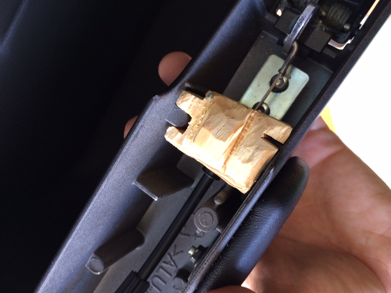

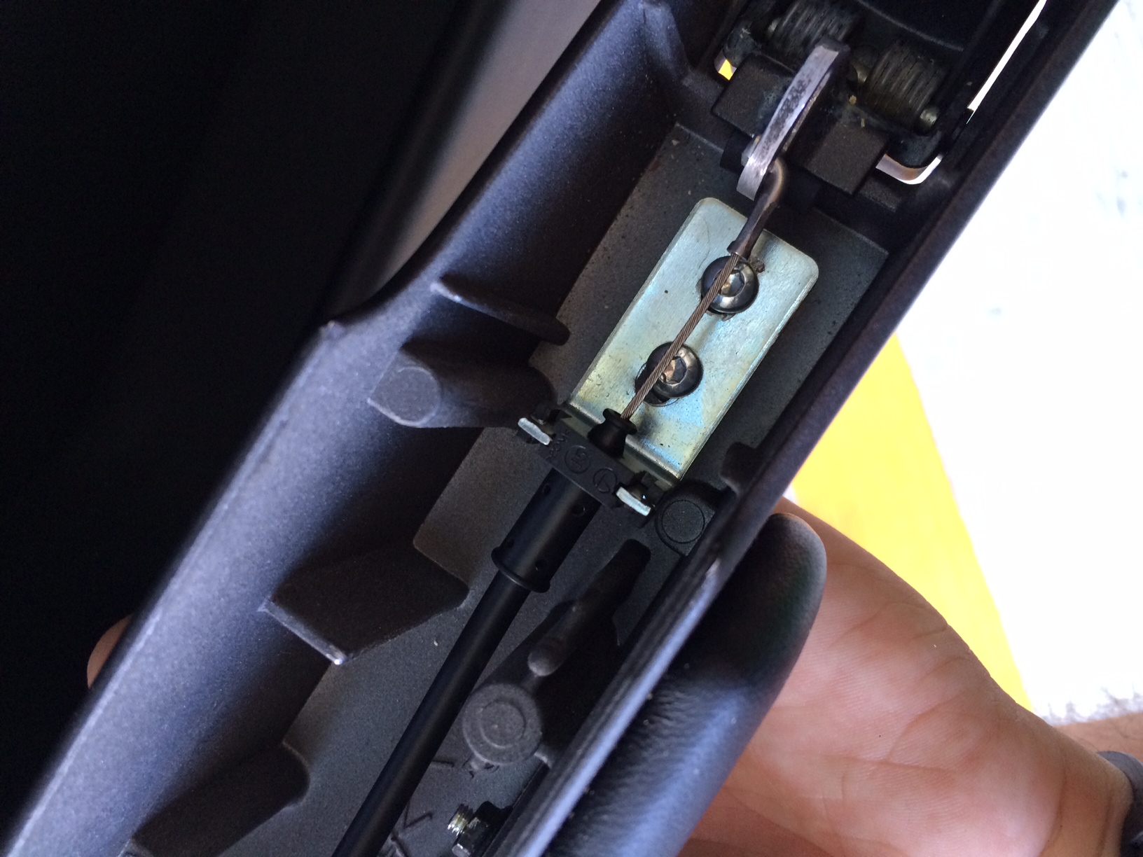

i tightened down the arm rest (awesome)... but coming home from dinner tonight, the door latch wouldnt work inside the car, i had to open the door from the outside with window down..
took the aluminum piece off and the part that stays stationary on the pull.. was not broken at all. but was slipping off the steel "L" bracket..
i bent the bracket somewhat more than 90* and then loosened the torx and made it the proper length.... it works now, but surely keeping an allen wrench in the car just incase... worst case scenario i can put a box of some type in there to keep the "stationary" part from slipping off the "L".... ironically the door pull being something you need in the most dire of straits, i'm surprised of the cheap/flimsy plastic piece that allows it to work... i feel metal would be better as it would suck to be stuck inside the car in a wreck.

the nuts that hold the door arm rests on are not locking, not nylon threaded.. just nuts so i assume with miles/vibrations they worked themselves loose...
when i removed the aluminum door pull,and tightened the new nuts (nylon threaded from home depot, M4-7) i feel i might have "bumped" the L bracket that holds the "stationary" part of the door pull and therefore when i opened the car door later it "slid off"... i adjusted the "L" and it no longer "popped off" but just to make sure this never happens in an emergency i did myself one better and created a "guarantee"...
i was going to 3D print this with a help of a friend, but it's never going to be seen, so my boyscout poor widdling skills came to play (below)..
i made the wood look better after i got the size right, but it basically prevents that plastic piece (that doesnt even have a cotter pin or any retention device) from ever coming out of the metal "L"..
everything bolts back up fine and works as it should... the pull on the drivers side seems a little harder than pass side so i assume their is something binding up or unlubed somewhere.. but removing the door card (surprisingly easy.. 4 T20 bottom, 2 T20 mid door... lay on ground and remove the plugs for windows/puddle light, pull up to remove (put window down before any of thise otherwise door card will never want to go back on)..
the door lock mech is hard to access but doesn't look like anything is wrong... just age i assume, but door works perfect now.. just maybe 30% more pulling force needed to pop the door,...
