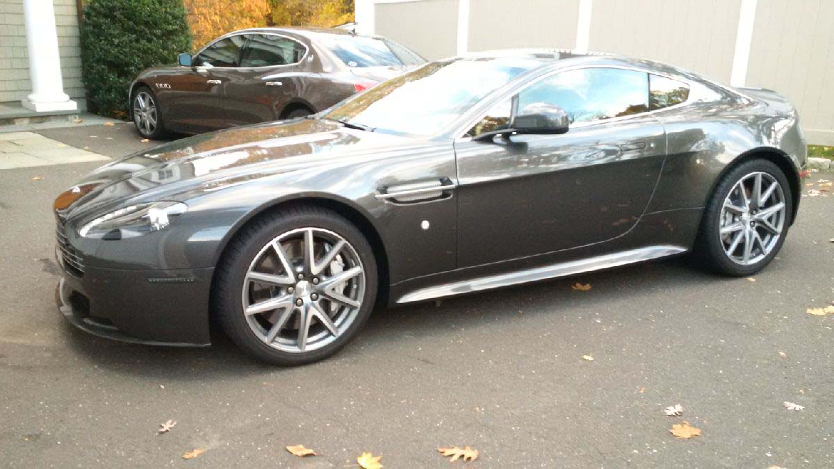

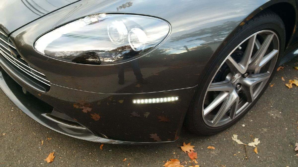

I tinted my amber lights, but came across this thread and decided to try the LED lights. I ordered the lights and the 10mm flex head socket that was mentioned earlier in the thread. The removal of the old lenses was a huge pain in the >ss. Plan to spend at least 30 minutes to get the front nut off. I tried to fit a regular 10mm socket on the second side to speed up the removal process. I wound up dropping it down the fender. I wasn't able to retrieve it (fortunately where ever it is, it doesn't rattle). A few bits of advice. When installing the new lights, don't bother trying to install the front nut. Instead secure the front half of the new lights with 3M super strength double sided tape (the tape used to install emblems and trim). You will also need some Gorilla tape or electrical tape to secure the new wiring harness to the old bulb socket. The finished product looks really cool against the Meteorite Silver V8VS. I am glad it did it.

I love these! Is jacking the car required or can It be done just moving the wheel? Would get these in a heartbeat if I cant figure out where to get this installed in Los Angeles.

No jacking required. I turned the wheels to get access to the two Phillips head screws that secure the liner.
