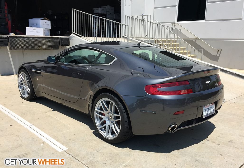

Just saw this pic in the classifieds thread and noticed the markers on the rear bumper... I thought the rear housings had different clips from the front? Maybe the owner flipped the fronts upside down and somehow got to fit?

Would be nice to know, I know V Collection listed theirs I think the same, but they did have a drop down box front and rear. So not sure, but if we can find out that would be awesome. I want the Red ones on the DB9 gone badly. I have those current ones on the front, but didnt install them. So TELUM01 might be able to answer this one.

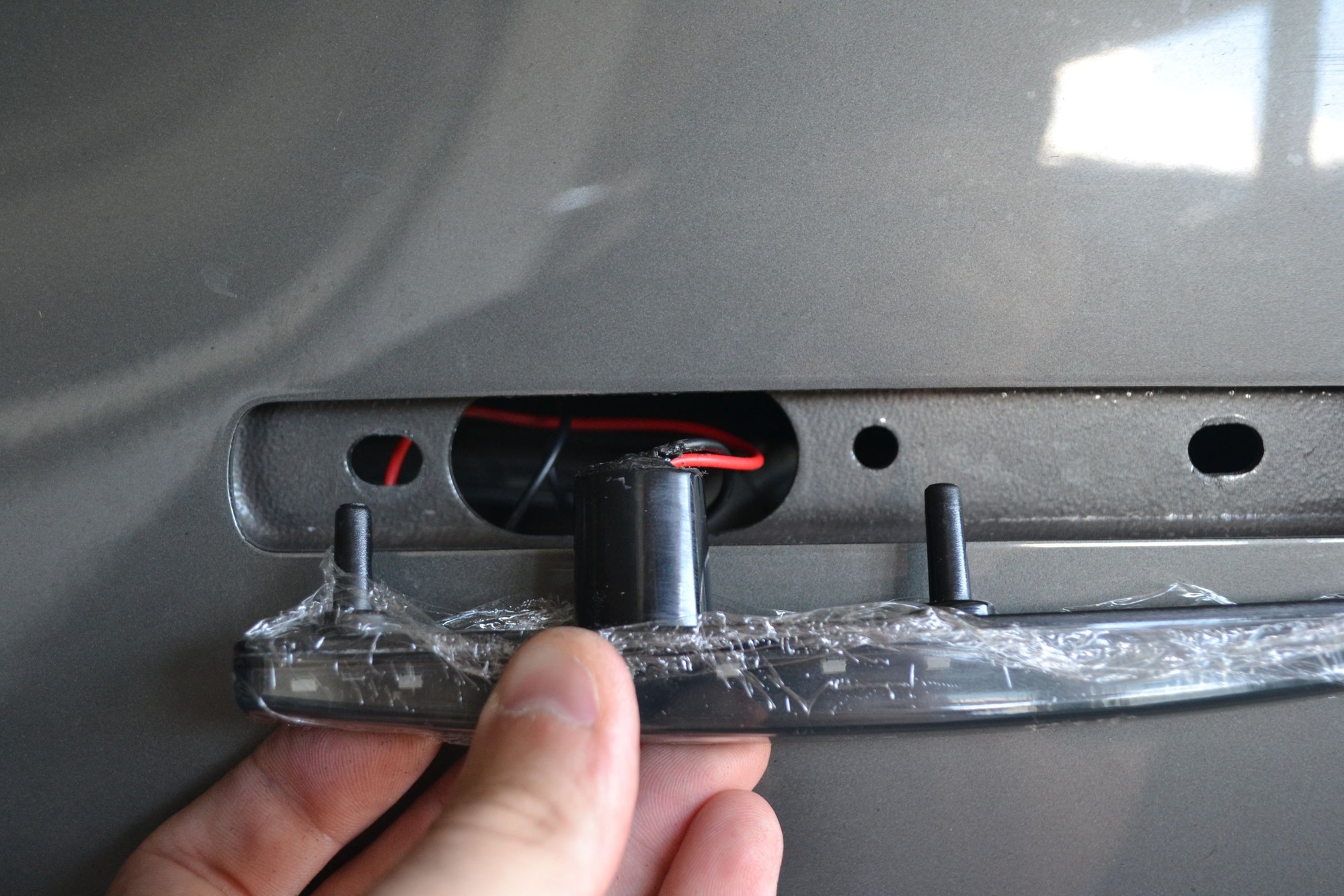

Yes, it'll fit, but you have to drill a hole in your bumper for the rear-most stud on the light. Pretty easy mod, really, but not something I'm personally doing because there'd be too many kinds of lenses on the rear of the car... tail lights (red or clear), rear reflectors (red), and the corner lights (black/LED). Just my own opinion, but yes these do fit in the back with minor modification to the bumper. I also turned the lights on and the LED corner light worked just fine.

Wow good to know! I'm having Oracle make me custom led bumper lights from these in front and OEM red in back. They are smoking both black. If it doesn't look quite right, I'll have them use another clear pair for the rear. (I would have gone with the VCollection ones, but those are out of stock until next year.) Thanks!

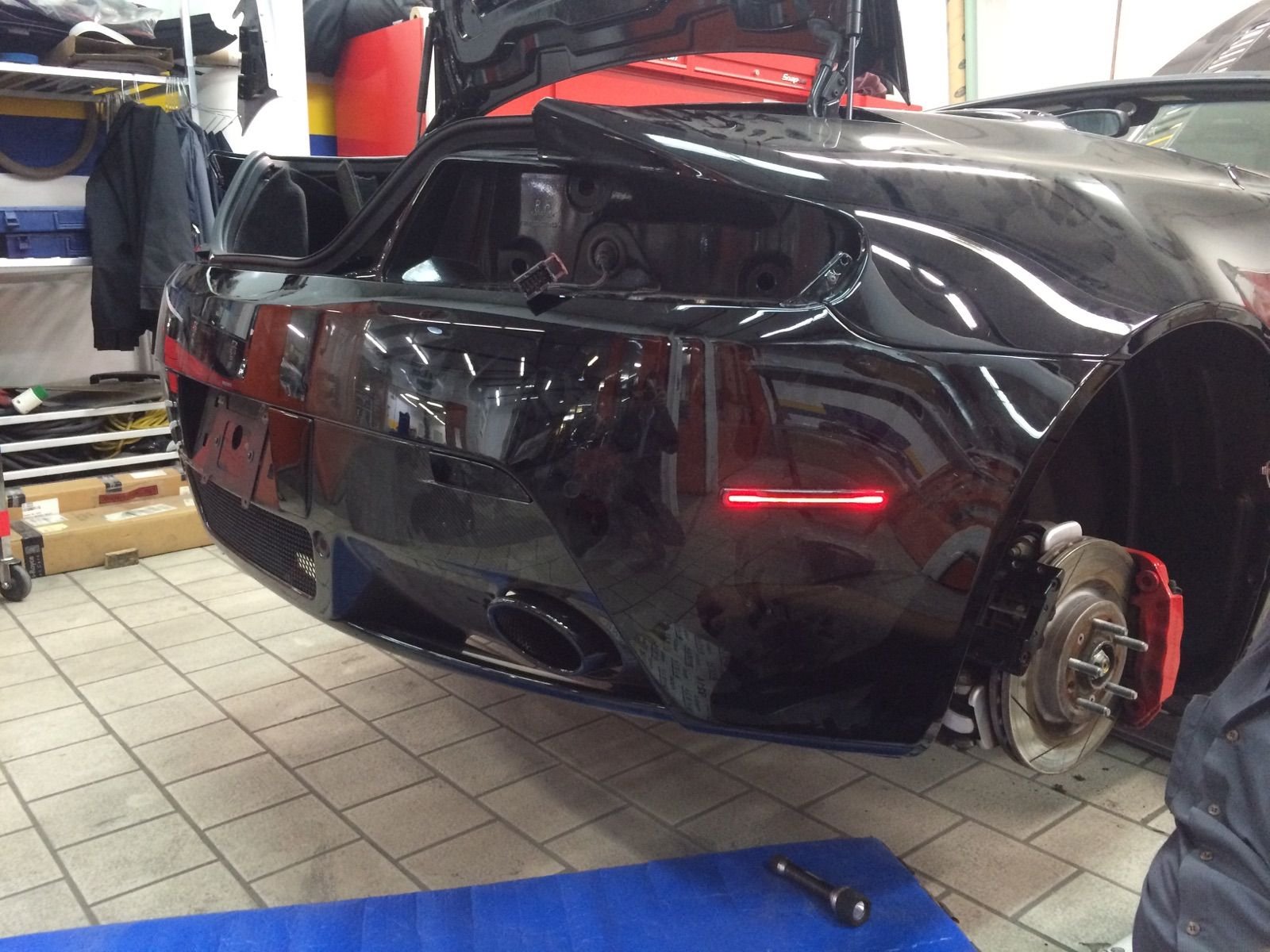

Prototype #1 - replacement bumper markers.
