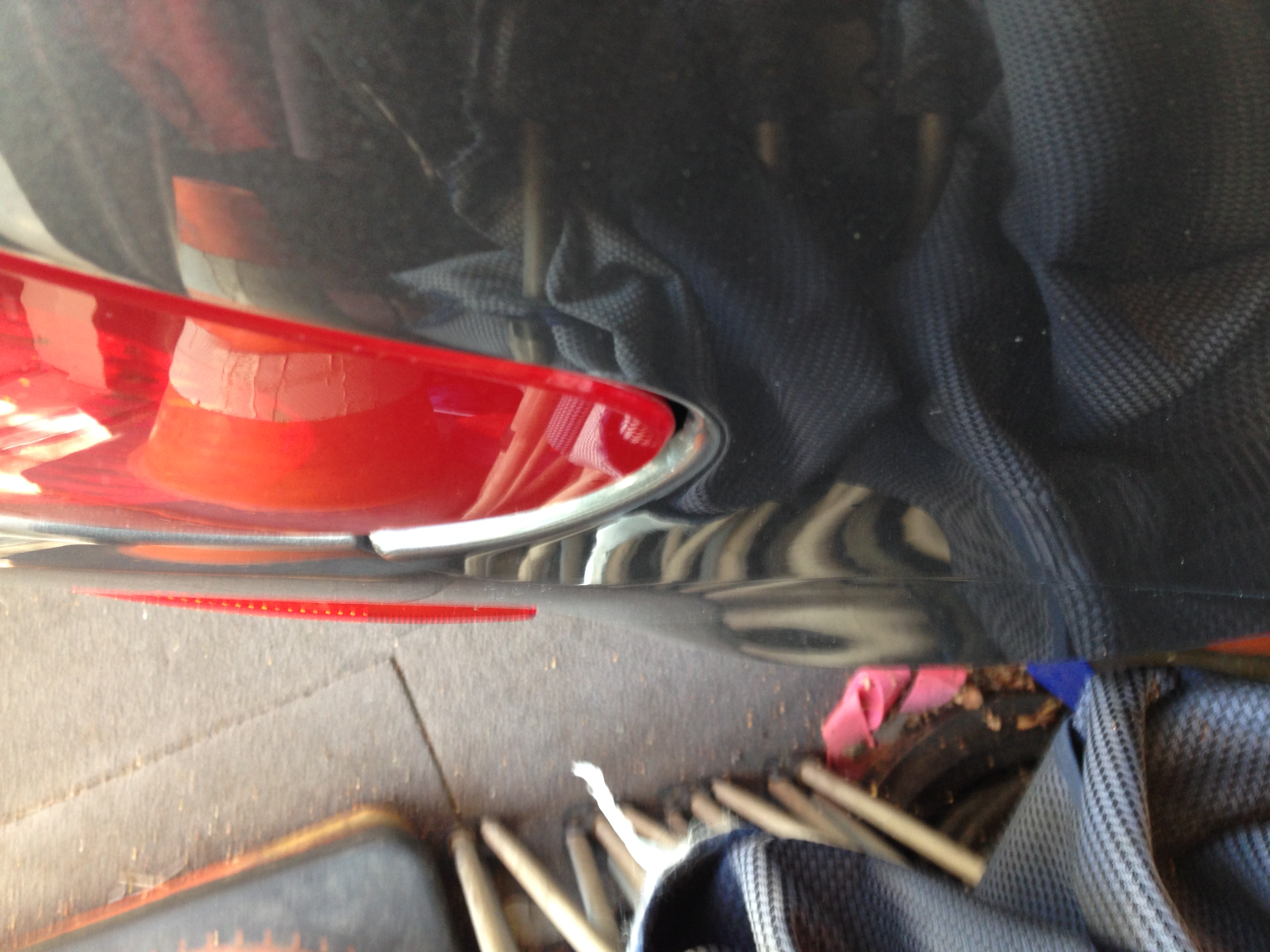

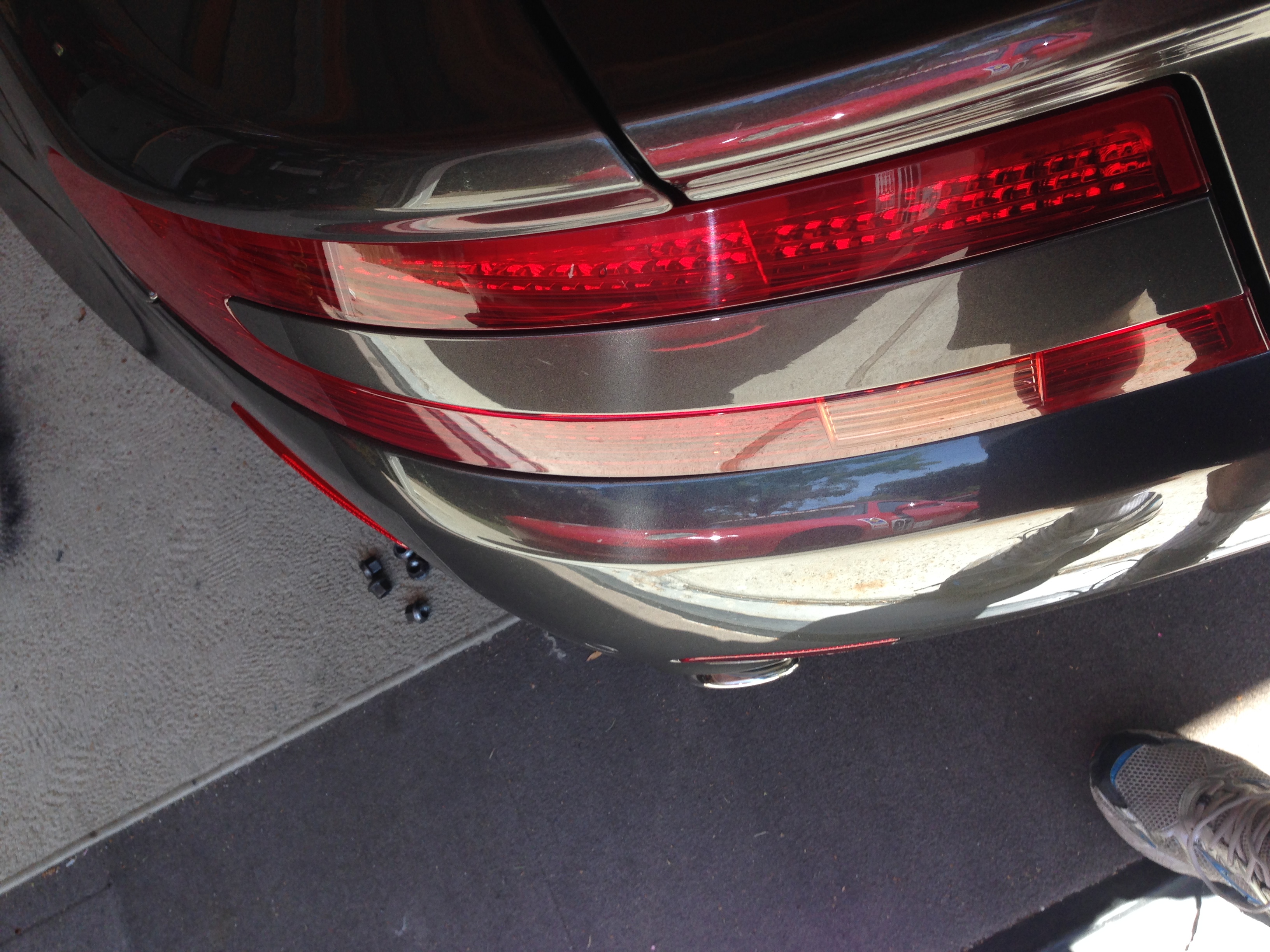

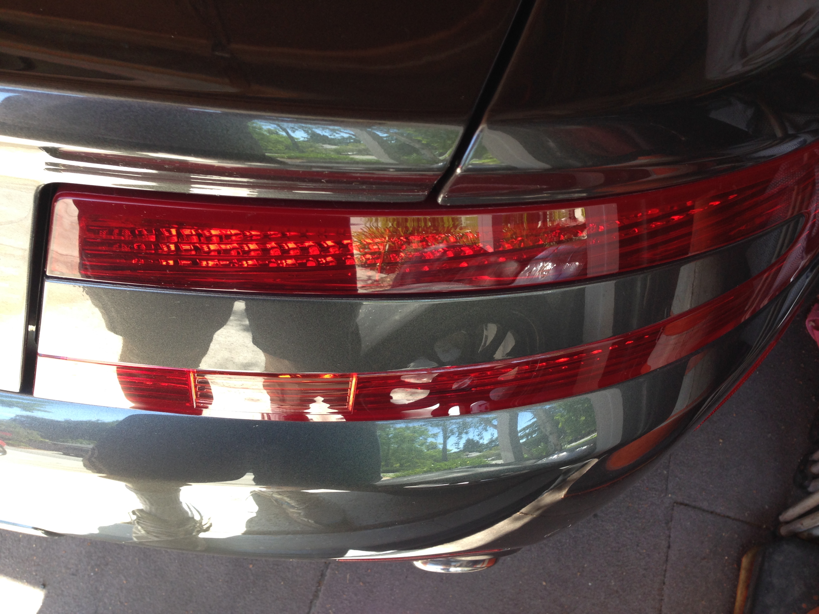

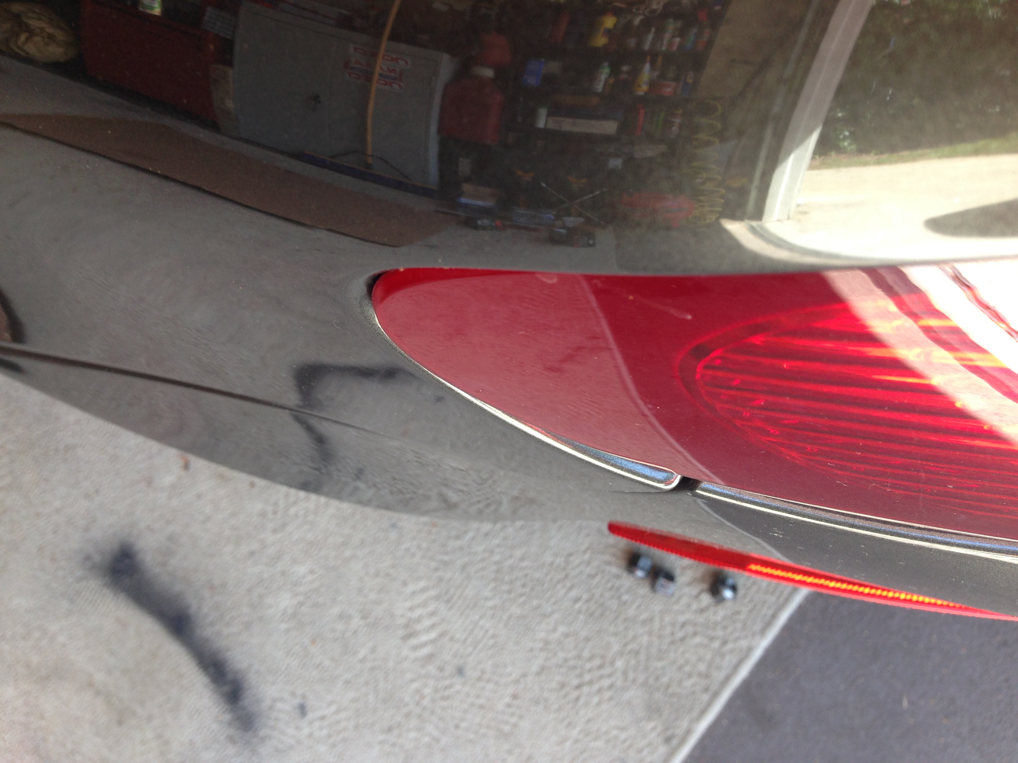

here are the left and right comparisons. you can see that the edge slightly sticks out on the left side and not on the factory installed right side. the other two shots show the middle section that is the same near the inside area, but in the middle to get the outside edge to go in, its maxed out before it starts to be out of position.

Old May 1, 2014 | 06:38 AM
Irish07@VelocityAP's Avatar
Joined: Sep 2011
Posts: 2,981
From: British Columbia
Rep Power: 208
Irish07@VelocityAP Is a GOD !Irish07@VelocityAP Is a GOD !Irish07@VelocityAP Is a GOD !Irish07@VelocityAP Is a GOD !Irish07@VelocityAP Is a GOD !Irish07@VelocityAP Is a GOD !Irish07@VelocityAP Is a GOD !Irish07@VelocityAP Is a GOD !Irish07@VelocityAP Is a GOD !Irish07@VelocityAP Is a GOD !Irish07@VelocityAP Is a GOD !
Is the left the used part and the right is the original on the car?
