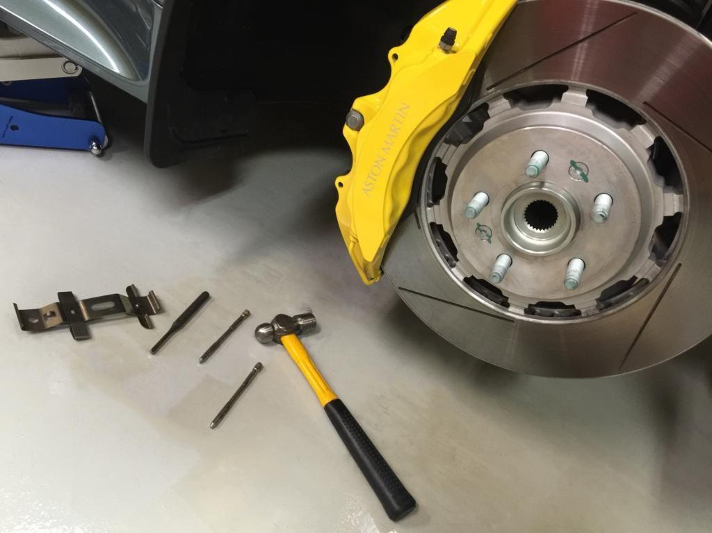

So, thanks to Stuart, I just got a set of R4-S pads for my GT4. Installation was a breeze as usual, but I do have a few observations:
  • The pads are larger than the OEM pads. Most of the increased size is in the area nearest the hub. This means that more of the pad backing plate shows outside the caliper. Not really a big deal, and it doesn't seem to affect anything.
  • Each new pad has two thick silver metal discs on the trailing edge. Not sure I know what the heck those are for.
  • The R4-S pads come with metal shims. The OEM pads have a composite, cloth-like shim and the rear pads (but not the fronts) have metal shims on top of that as well.
  • I applied a thin layer of blue anti-squeal paste to the back of each new pad's metal shim.
  • I also removed the metal shims from the OEM rear pads and attached them to the new pads. They have an adhesive layer to keep them from moving around. I didn't remove the existing shims which means it now has a double-thickness shim for each pad like the OEM ones did.
  • The new six-piston front pads are not mirrored. All four individual pads are identical and that means that the slot for the wear sensor is at the bottom of the inboard pad on one side of the car and on the top of the inboard pad on the other. Not a big deal. I simply tied back the excess sensor wire length on the driver side brakes using a cable tie.
  • The rear pads are matched pairs with only the inboard pads having the wear sensor slot. Again, the pads are not mirrored so the slot is at the bottom one one side and the top on the other.
  • There is no bedding-in procedure necessary for the R4-S pads. Just install and go. Unlike pads others here have recommended, there is no 500 mile period of squealing before they quiet down. These pads are quiet from mile one.
  • The dust is dramatically less. I took the car out tonight and did a few hard stops and the drove for about 40 miles. This kind of drive would have made my calipers look filthy with the Brembo pads. However, they looked spotless. Very pleased.
As usual, here are a few pics:
R4-S pads left, Brembo right
R4-S pads bottom, Brembo top (notice size difference)
Wheel and OEM pads off
Retaining pins and clips
New R4-S installed
Closeup of larger pad portion near disc hub

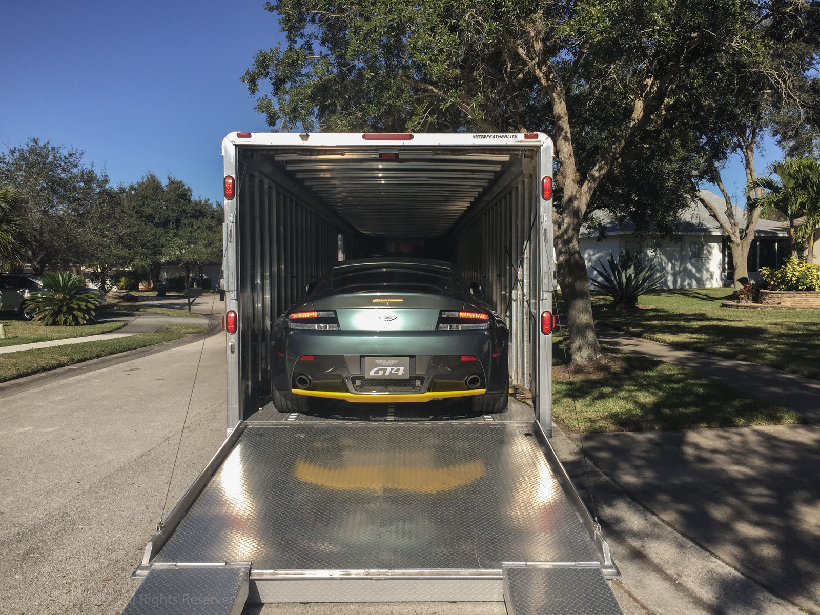

My baby is going on a road trip to the spa to get a little facelift.

What are you getting done?

Hardly seems enough room to open the driver's door. Is there a side door on the truck?

Yes, there is.
